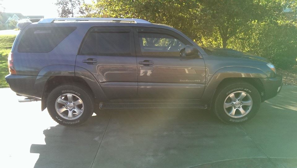

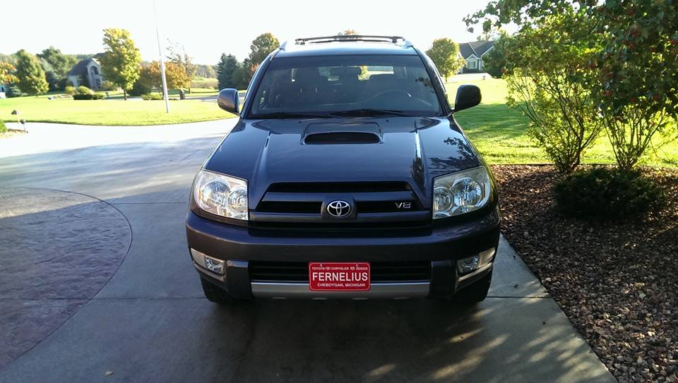

Been putting this off for quite some time now, but didn't feel like it was was worth starting since I hadn't been able to do much yet. I bought my Runner October of 2013. It's an 2005 Sport Edition, V8 and had X-REAS. The previous owner installed a Gibson Cat-Back and a K&N air filter as well as taking extraordinarily good care of it. Had more miles than I particularly wanted, but as the dealership I used to sell cars for owed me a huge favor, I bought it at cost.

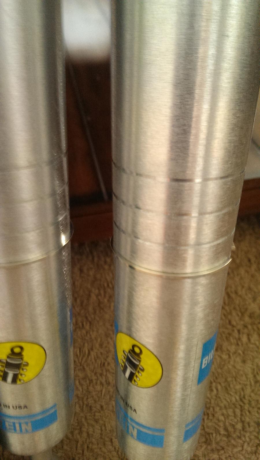

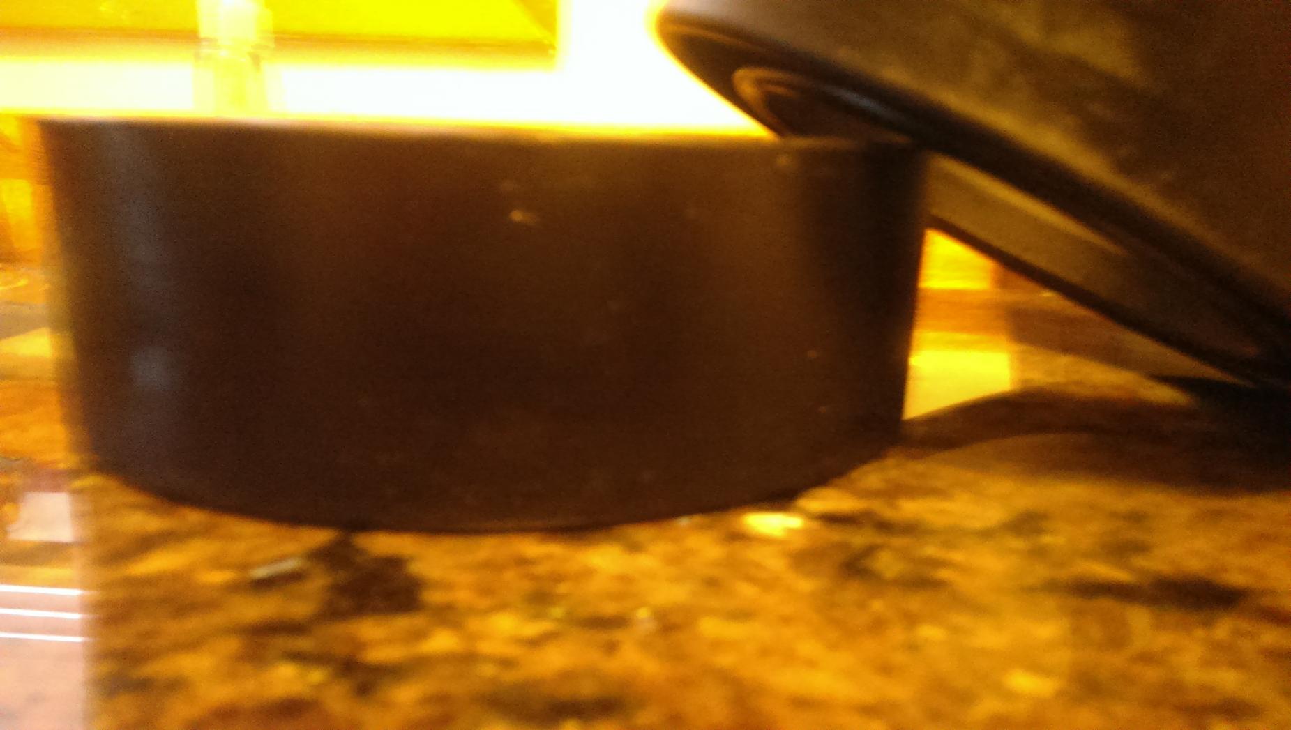

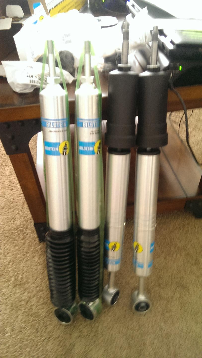

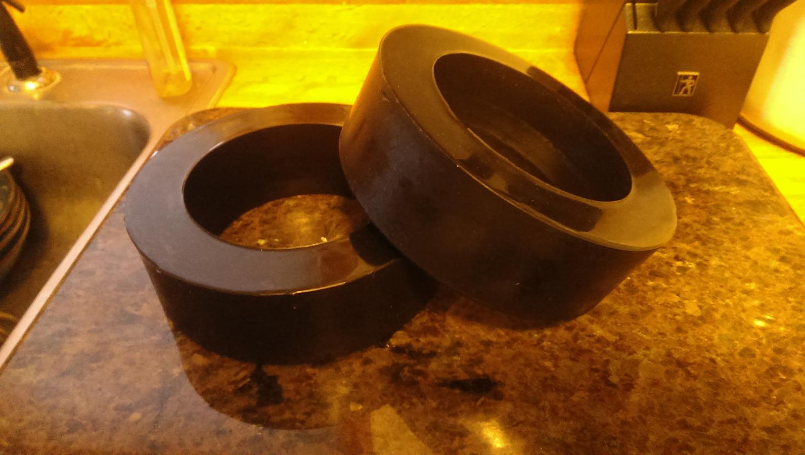

Within a month I realized that the shocks were about dead, started looking around and found that the tubes on the X-REAS were leaking. Seems rocks and such have taken their toll and made little pin holes in the lines, thus leaking everything out and rendering them useless. Winter was rough for me this year, but with lots of research I decided to get Bilstein 5100's and lift as much as I can. I also bought the Daystar 1.5" rear spacer to go with the set. I also found out that my blown shocks ruined a CV axle, and a wheel bearing. So, with tax returns I bought 4 Bilstein 5100's, the Daystar spacer, a wheel bearing assembly from these guys, http://www.toyota-4runner.org/bumpe...-front-wheel-bearing-assemblies-anywhere.html and a CV from RockAuto. For $45 I don't care if I blow some axles in the future! :boxing:

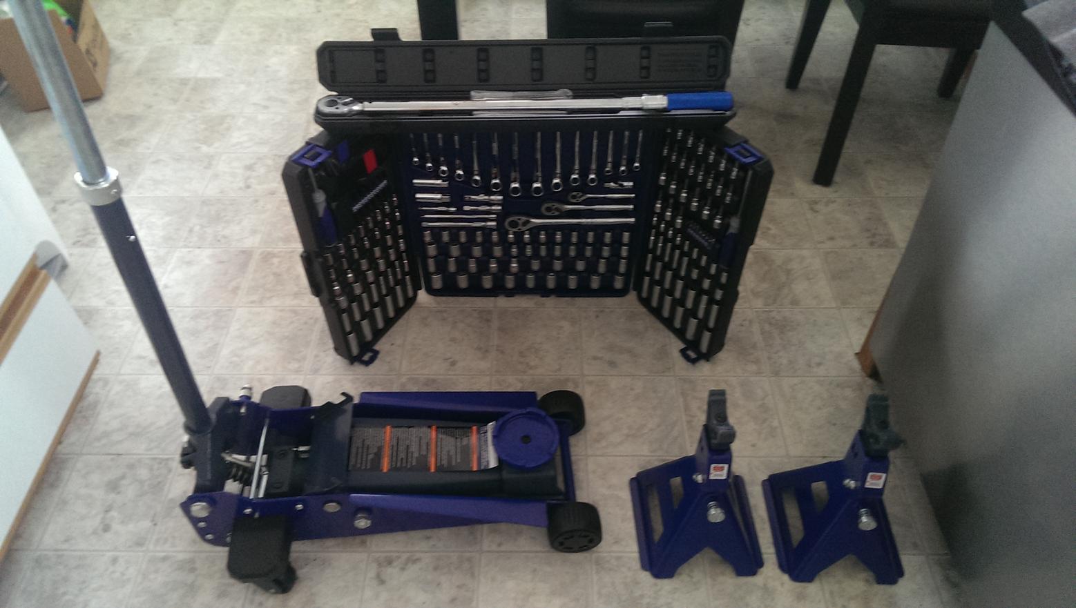

I also was in need of some tools, and I have to say that I am loving the Kobalt brand.

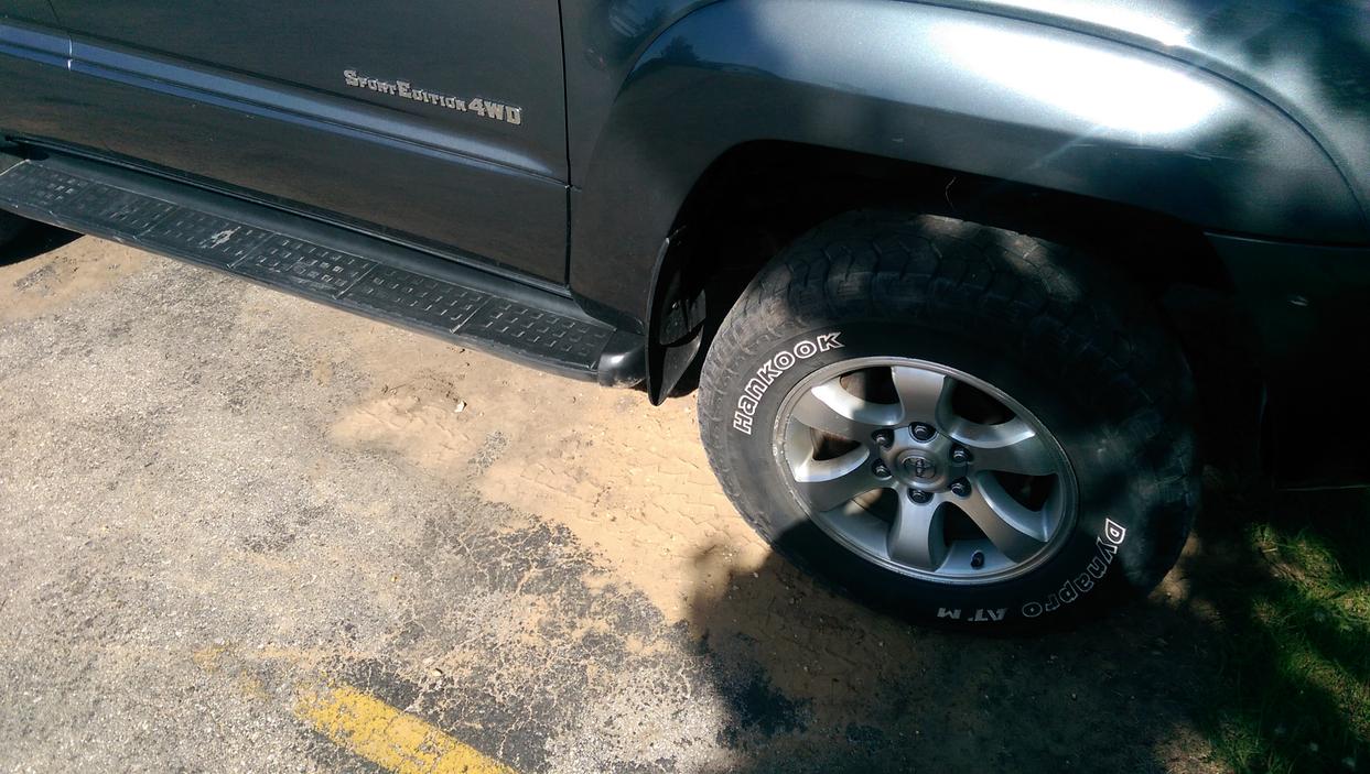

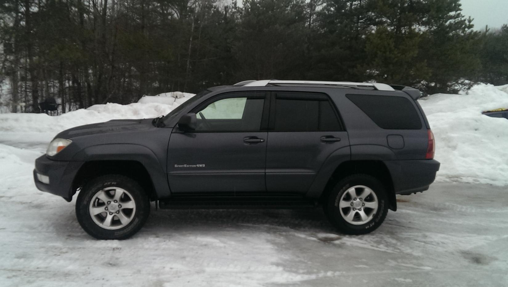

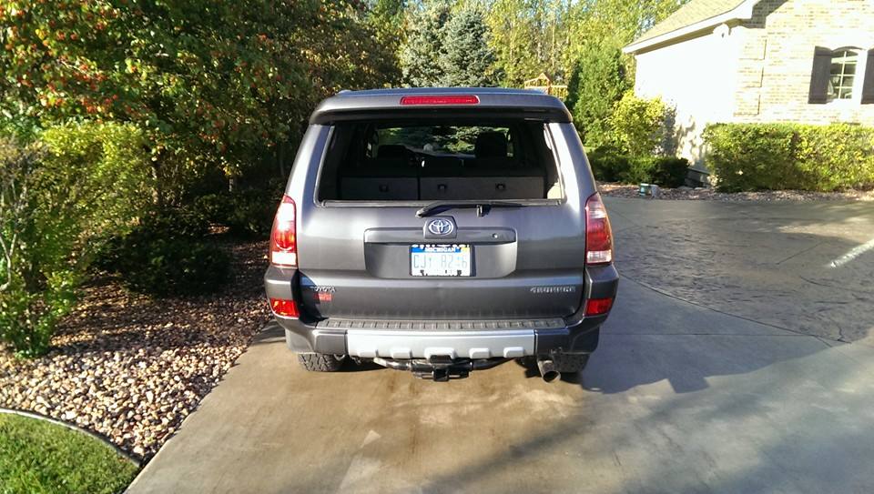

Unfortunately for me I don't have a garage or anything, and my mom's boyfriend said I could use his pole barn. Again, middle of February, Northern Michigan, -10 out that day, no heat.... I could only pull one end of the truck inside at once too. Anyways, I didn't get any good pics, was just wanting to get it over with. I tried the whole "easy install, no spring compressor" thing...No go for me. Ended up tracking down a spring compressor and finally got everything in and ready to go. I did snap a pic a few days later at my buddies house. My shocks were so blown I actually gained over 3" of lift front and rear. I know I typically wouldn't have achieved that, but I was saggin like a California cruiser! I also removed the sway bar's completely so I could get better flex. Almost put them back on the first day, but I got used to them within a day or two and although I do get some body lean, I have taken corners as fast as I used to with no issue's whatsoever.

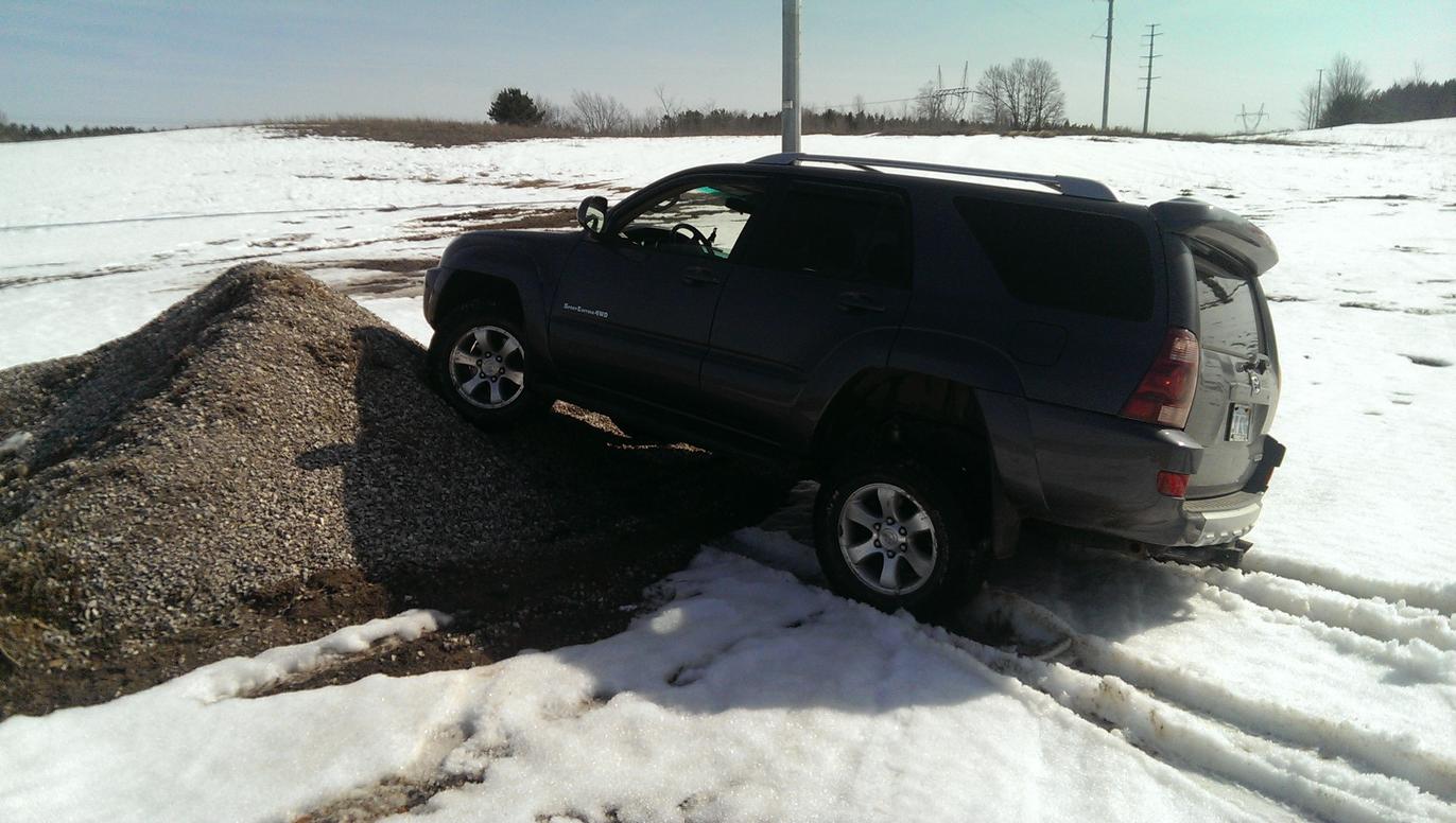

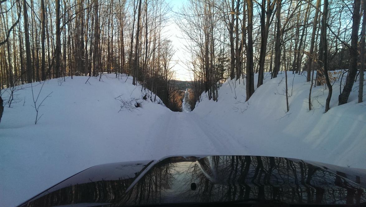

I had to test things a bit, so I took my Fiance' for a quick test drive. She has very minimal experience, and wasn't pleased by my flex test. lol She made me stop long before the rear tire would come off the ground, but was fun anyways. I found this huge hill to climb, and was very surprised we did it without spinning or anything! I didn't think about getting a pic at the bottom of the hill looking up, but you can see how high up we are by looking at the horizon.

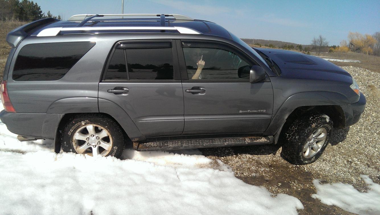

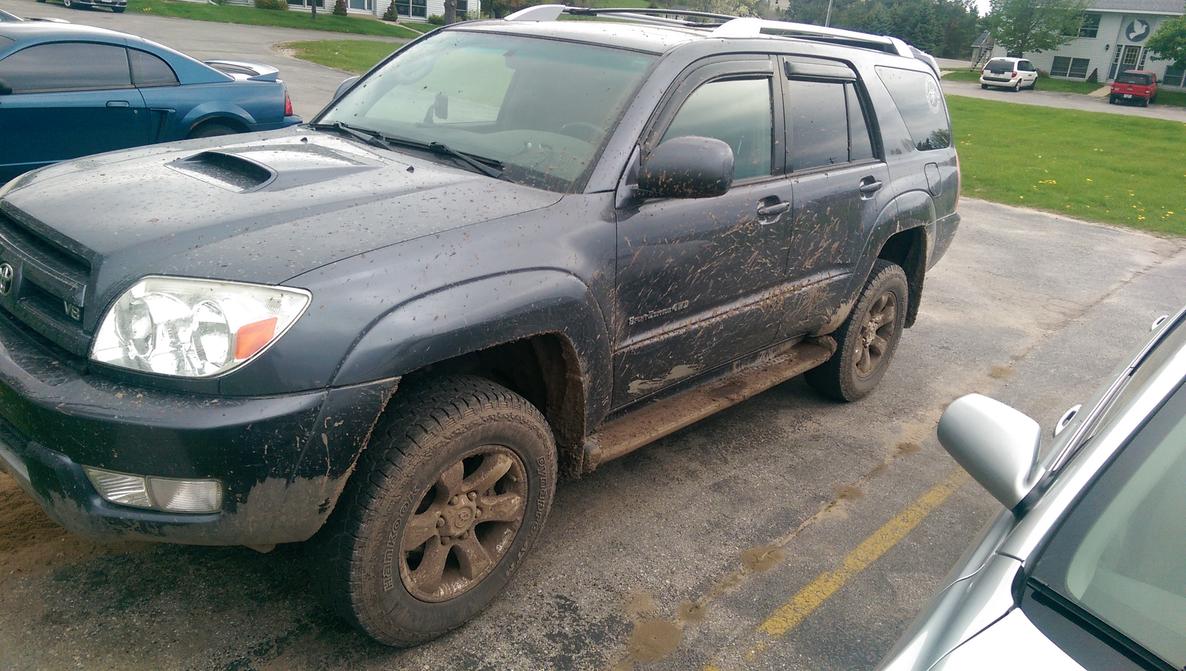

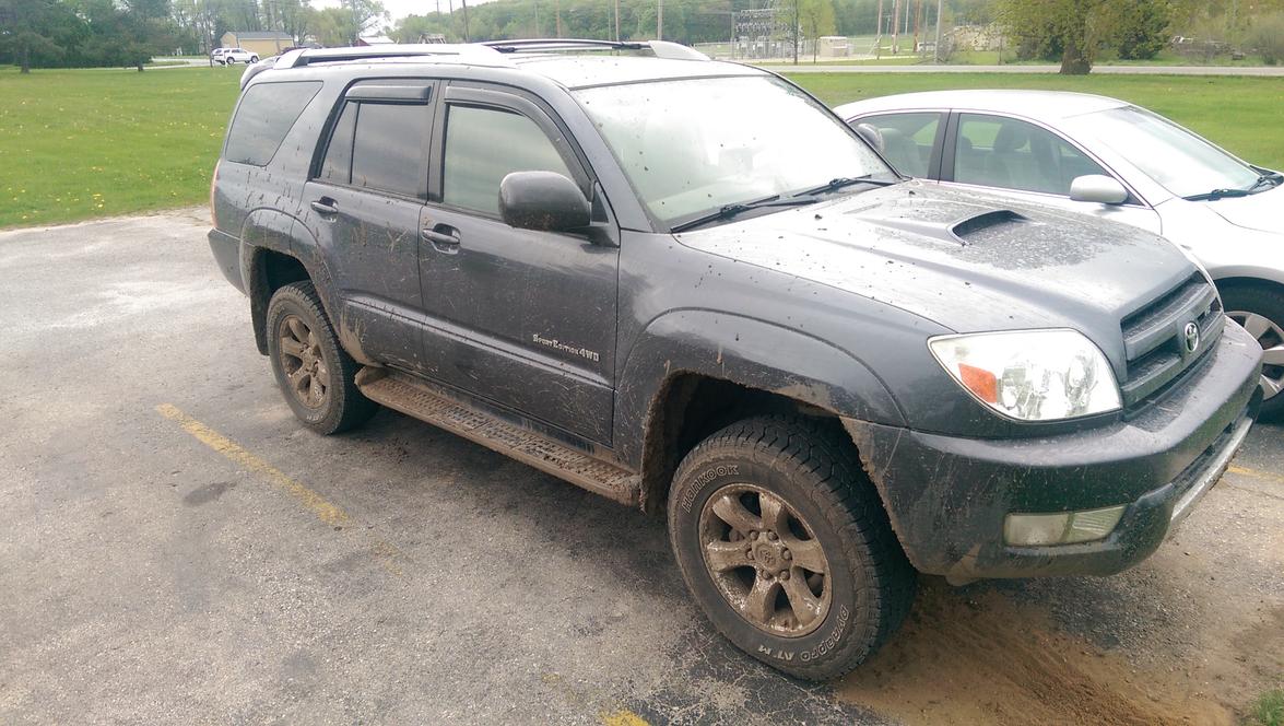

Anyways, I had my first real off-road outing Memorial weekend. I went to some local friends and had a little muddin party. Unfortunately the day before I got there some guys running 52" tires tore it up pretty bad, so I was only able to run through one spot and up a creek around the backside of some hills. I didn't get any pics of the creek like a dummy, but the tire ruts were deep enough that my running boards were sliding along the edge about 6" below the ground level... My buddy was driving his Ford Bronco with 35's in front of me and having a hard time at it. I didn't even spin a tire! :D Laughed all the way up the hill. I will upload some video's in the next day or two, as soon as I figure out how, but for now here's a pic of the aftermath.

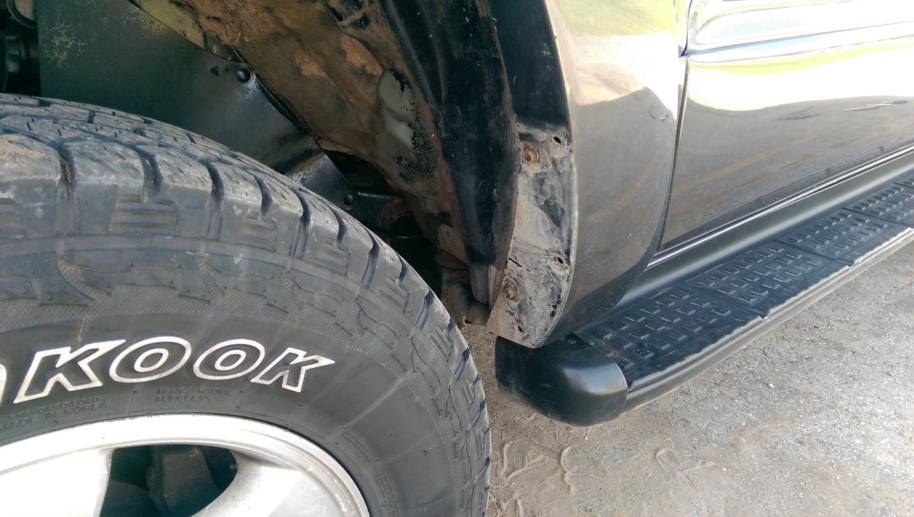

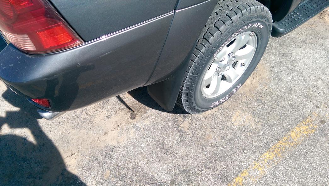

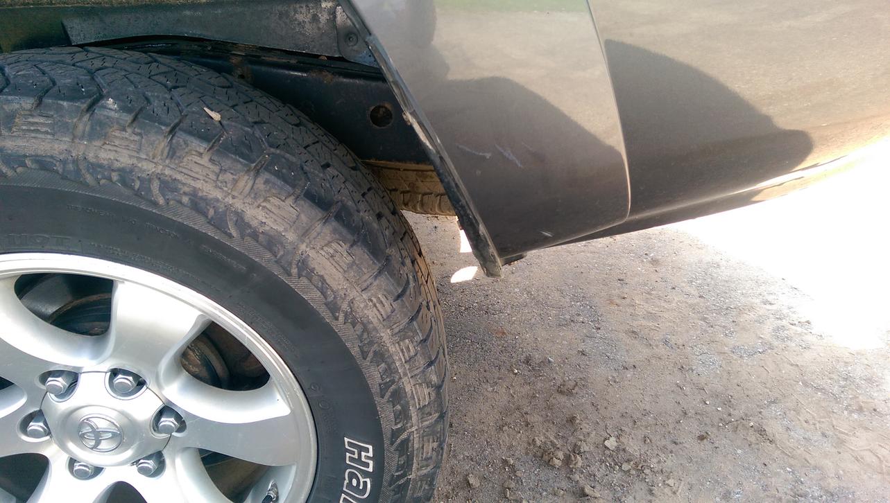

Lastly, today in anticipation of going big I took the front mud flaps off and trimmed the rears.
