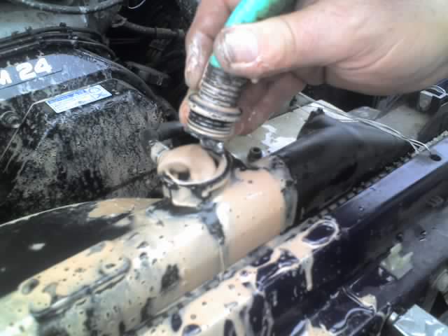

just thought i would share my 2 cents on this matter. no way to tell when it can happen, it starts by they temp gauge going up and the transmission starts shifting harder. i only drive 10 min back and forth to work and after just a few days the two systems fluids were completely mixed. I purchased a new radiator and 5 gal of new AT fluid, and a new AT filter. After flushing the coolant system out with the hose until all old fluid was removed i installed the new radiator. I then flushed the transmission about 4 or 5 times. I would fill, then take it for a test drive, come back and drain while also dropping the transmission pan to get all the mixed fluid out. The transmission seemed to be working properly, but i decided to start looking for a new 4th gen 4runner. Didn't want to chance having to get a new tranny, and this gave me a reason to upgrade. In my opinion this is a terrible flaw in the otherwise bullet proof 99 4runner. This also happened to a friend of mine in his 99. He totally fried his tranny by overheating twice. I think every 3rd gen owner should go out and either purchase a new radiator or seperate tranny cooler.

Oh yes that picture is exactly what I would like to try and avoid. And I figure if i have the rad drained anyway when I do the timing belt the extra cash to put new rad in is worth it to me. 150 vs 2000 simple to me
