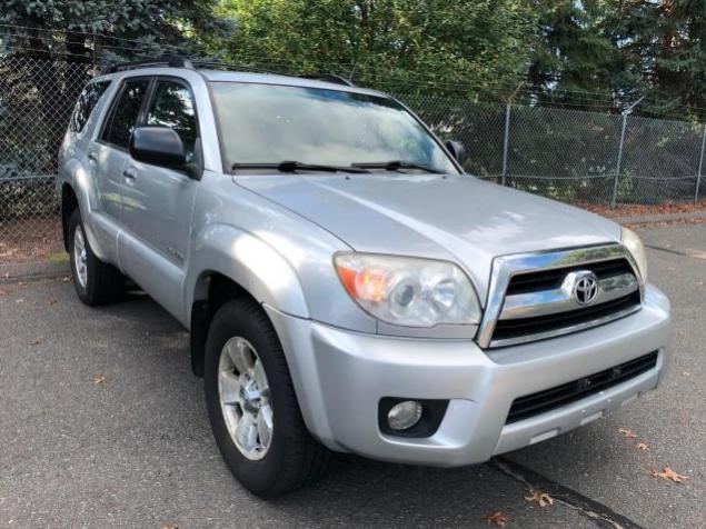

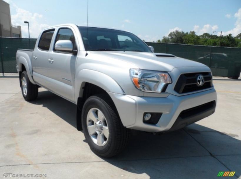

Has anyone replaced the hood, grill, fenders, headlights from a Tacoma and put them on their 4runner? I know 3rd gen 4runners can use Tacoma front ends, just curious if its possible for the newer gens. 4runners just have a more bubbly look to them compared to Tacos :snacker:

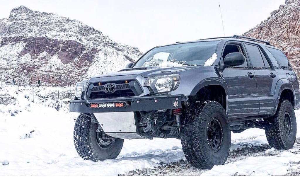

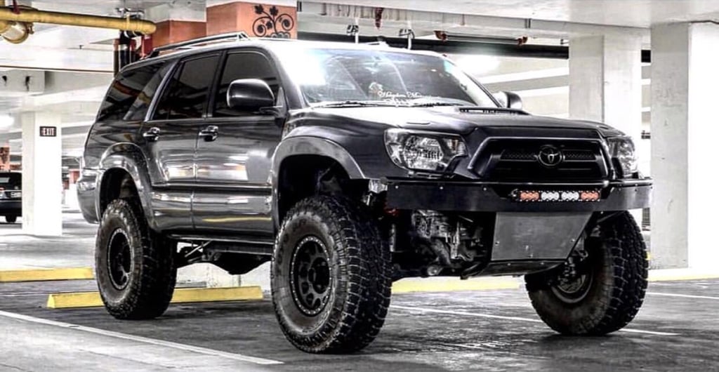

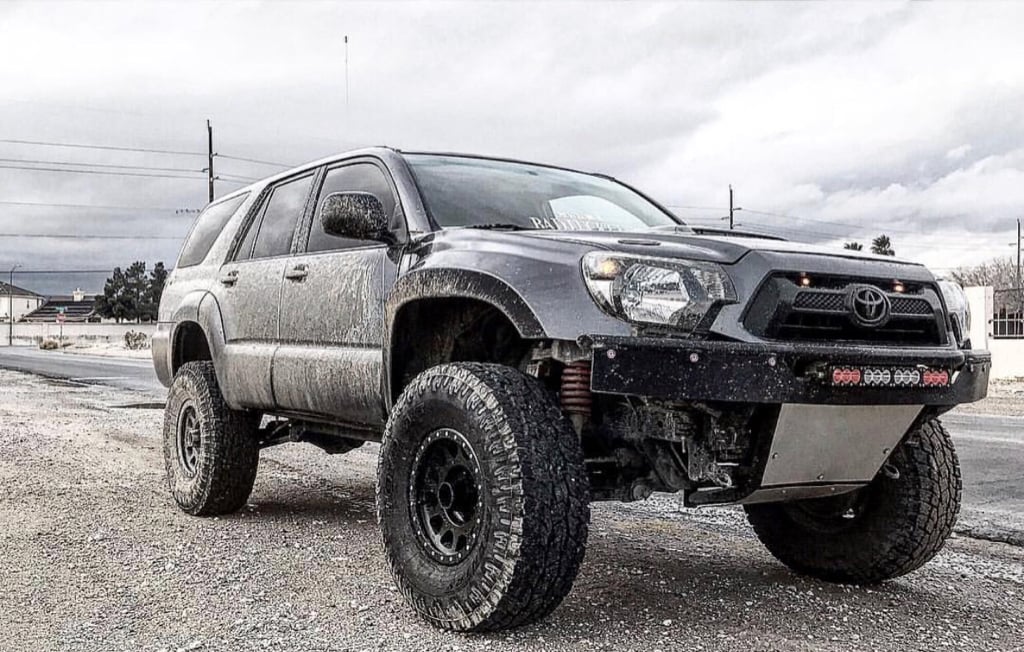

[MENTION=128349]4thgenmike[/MENTION] and @tha.skid.kid in IG to name a few. I'm sure there are others.
Good thought but i dont think it will work. The fenders on the Tacoma are taller so they won't line up with the "A" pillar. The rad support is different so mounting points will be different.
If you are good with fab work it will probably be ok but im pretty sure it will not be a direct bolt on.
Wow that is impressive! Looks even better than I imagined! The latest Tacoma is wider than the 2nd gen so I’m surprised he got it to work. The 2nd gen would probably bolt up.
Just looked up 4thgenmike and it looks pretty sick. But yes, some fab work required.

Last time I saw tha.skid.kid's page it looked like a paper mache project. 4thgenmike's is very well done though.
I messaged 4thgenmike to see how he did it. No build pics at all lol. Thaskidkid said it was a pain in the ass [emoji1744]*[emoji3603]

So, taking a closer look at 4thgenmikes page it looks like he may just be running Tacoma fenders. He’s got a side shot of the fender flares and you can see where it meets the door doesn’t look correct at all. I’d be curious to see how far off everything is when you start bolting on Tacoma parts.
He said in one of his replies:
"the fiberglass are from fiberwerx made for tacomas. I didnt replace any structural support, used the oem 4runner one, cut, and drill to certain areas. The hood mounts to the 4runner hinges but only 2 of the 4 threaded holes. Once I tube the front it’ll fit better and more aligned."
So Tacoma hood, fenders, grille, and headlights. And compatible/custom front bumper. And repaint. Tacoma's don't have gas shock supports for the hood so that will need fabricated too. Not sure how they latch so hood pins will probably be necessary.
