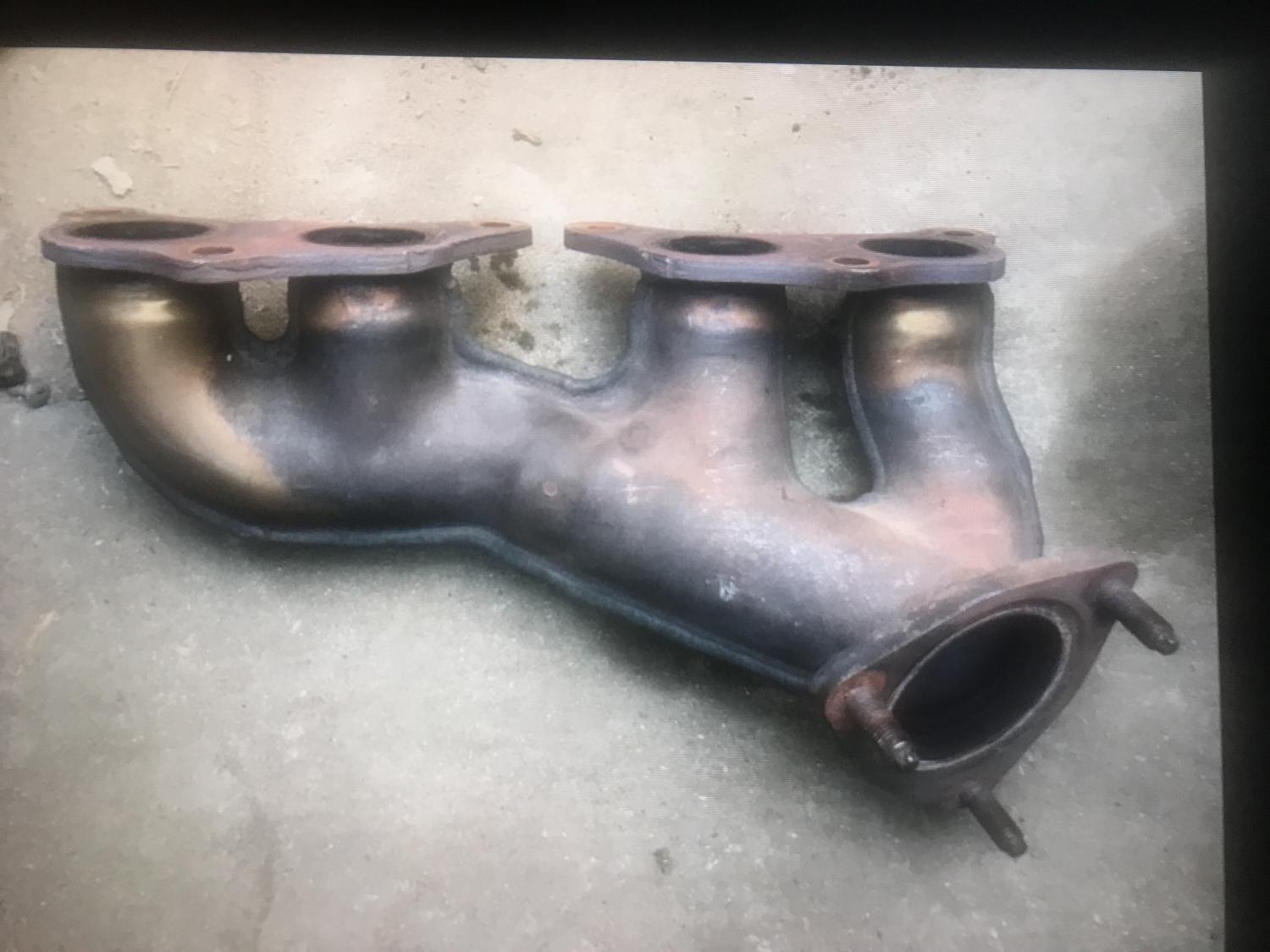

Newbie here ! I was planning on swapping my headers since it has a crack on it with a 2002 Toyota Tacoma headers . I know that everything above 2001 and up they came factory with these so called mini headers . They’re for my 2.7 3rz . The seller sent me some photos and I was asking for some type of identification numbers on the headers so I could verify them but he said he couldn’t find any. Can someone tell just by these photos ? Thanks !

That pic is the old cast type header (or maybe something aftermarket??) , not the new Tacoma Mini Header. If someone is trying to sell you that, don't bother.
The new OEM mini header is a welded pipe type of header. If you search this site you should be able to find all the part numbers you need.
The upgrade needs a LOT of nuts and bolts and gaskets and a heat shield etc. It's a lot of work to assemble the needed list yourself. A member on here (@Deathcougar) sells a full kit ready to go. Maybe get in touch with him.

Thinking about this overnight. That is NOT a factory cast manifold either. Do not buy it.
The OEM 4runner header (cast or newer weld style) only neck down to 2 ports where it joins the cat pipe. the last 2 to 1 blend is in the cat pipe. There are 2 smaller ring gaskets between the manifold and the cat pipe, not one big one.
Not sure what that part pictured is from.
Here is a link for the kit. Has some pics in it of the part you need.https://www.toyota-4runner.org/for-sale-t4r-items/163216-tacoma-4runner-2-4l-2-7l-mini-header-kit-new-$325-maryville-wa.html
The above link also answers the question as to what the above pic is; 2wd header which is not compatible.

thanks! the guy who was trying to sell it to me said it was from a 2002 toyota tacoma. i know some of the factory tacomas came with the mini header and i just wanted to be certain. thanks for the link!
Just to clarify, that header he sent you a picture of isn't a cast manifold, but it IS a stock manifold for an 01-04 2WD 2RZ. The 3RZ (4wd and PreRunner) used the tubular manifold I sell in my kit, which matches your downpipe.
If you ever buy a used one, you'll need 01-04 3RZ ONLY
