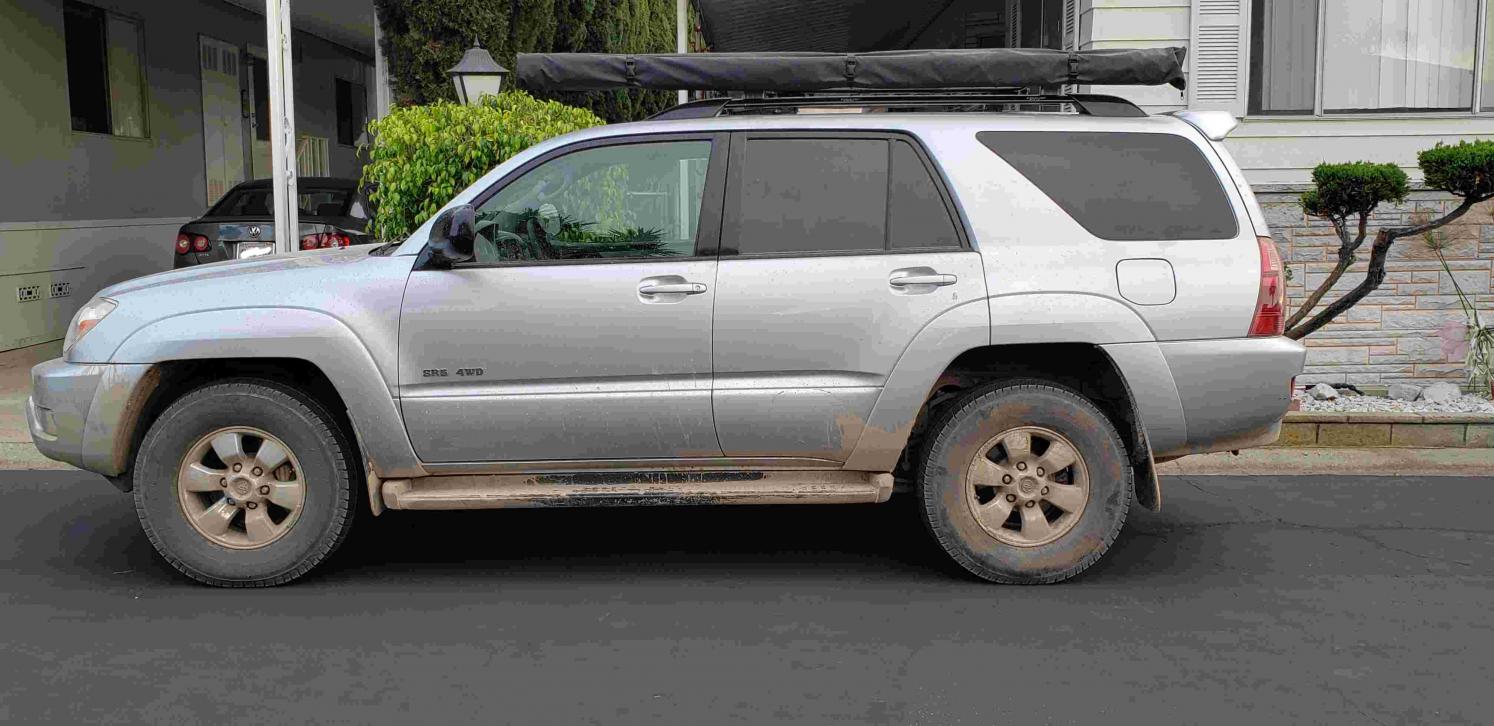

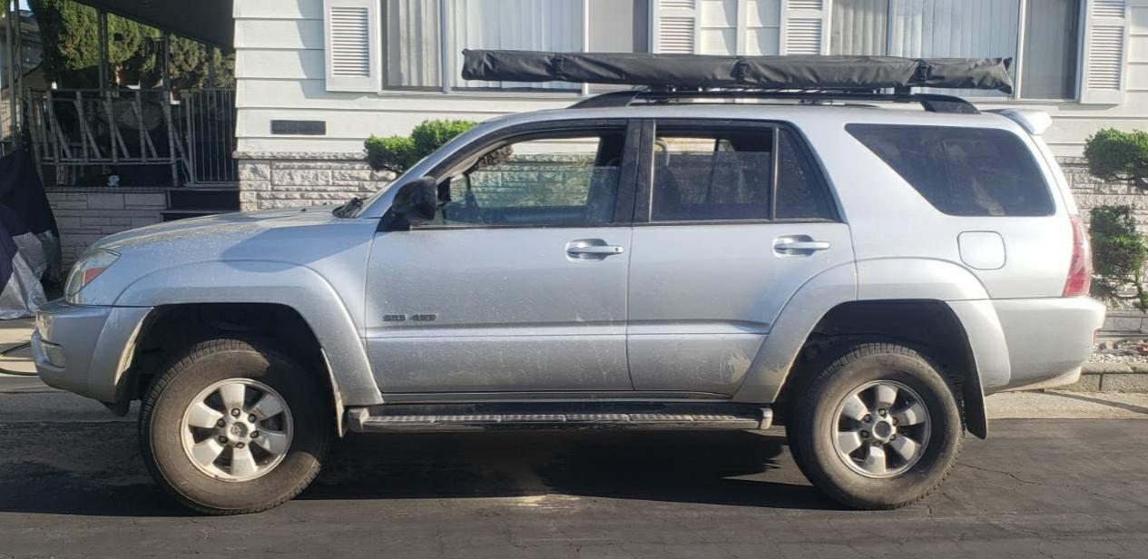

Recently did a taco swap up front from a 19 TRD off road set up. Got the whole kit under 2k miles for $140. It lifted the front up way more than I thought it would, to the point where I had some serious negative rake. Couldn't source any fj coils, but I did find a set of 14 4runner coils, paired with 1.5" Daystar spacers for $80, so I went that route instead. The coils were actually a little shorter than mine, but thicker and stiffer, so it all worked out and she sits pretty level now, gotta say I'm really happy with this set up, no more mushy suspension. Have no idea how much lift I got, as I didn't really take any measurements, just kinda winged it while we were rebuilding the front CV axles.

Thanks for the info. Idk about fitting right onto the shock mount, was quite the tight squeeze that took some muscling, but eventually it went on lol. I'm assuming it's because it's a poly fitting rather than metal to metal like the stock bushings? That or it's cause I mistakenly bought the red bushings and not the black hourglass, but I was under the impression that they both worked the same. Either way, they're on now, and she rides nice. Thanks again!
