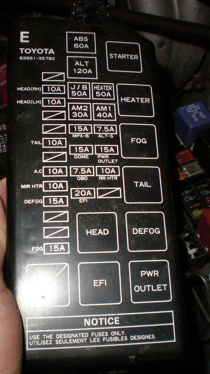

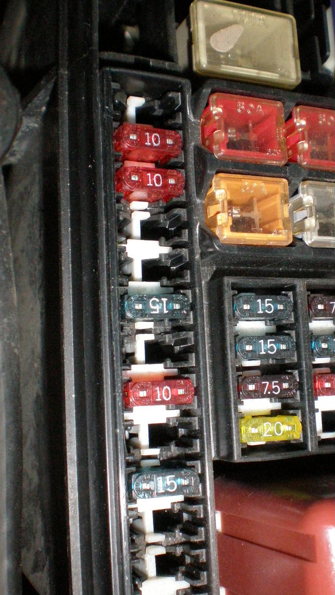

Yeah, there is a 10 amp fuse that always blew for me too. Its in the fuse box under the hood and it's called TAIL 10AMP
It kills the corners, tail lights (not brakes), and the interior lights.
I blew through something like 5 fuses so I swapped it with a 15Amp about a year ago, no problems since.

oh thanks I'll check that right away! I didn't notice that my tails were out until last night... but my interior lights have been out a while.
