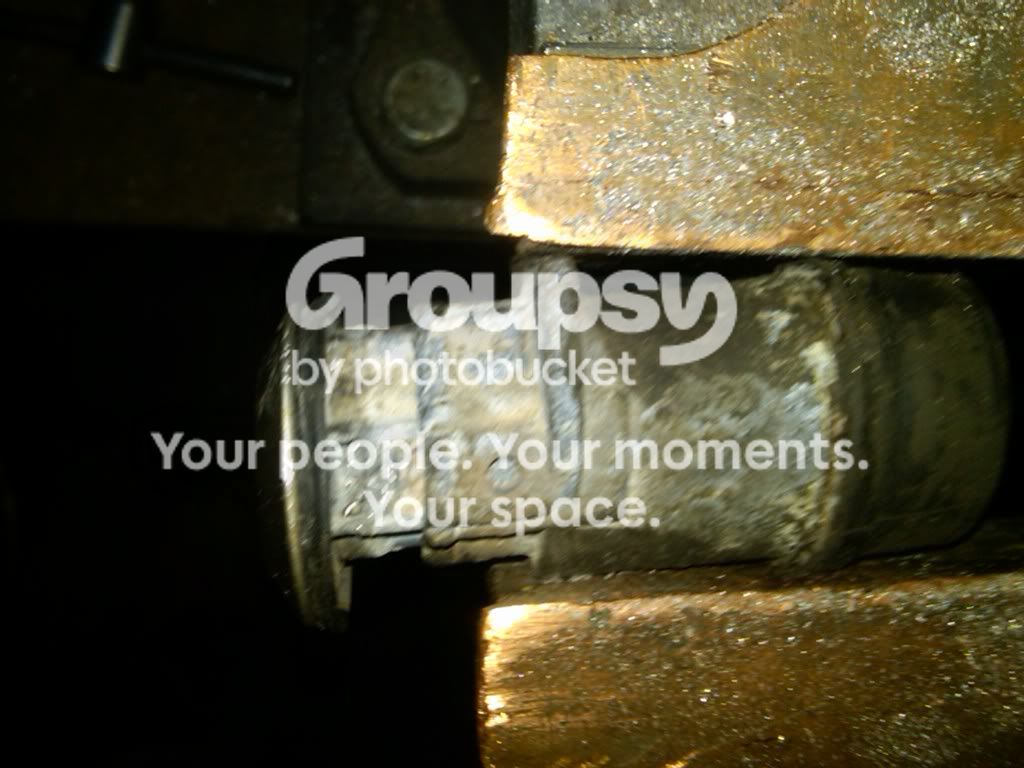

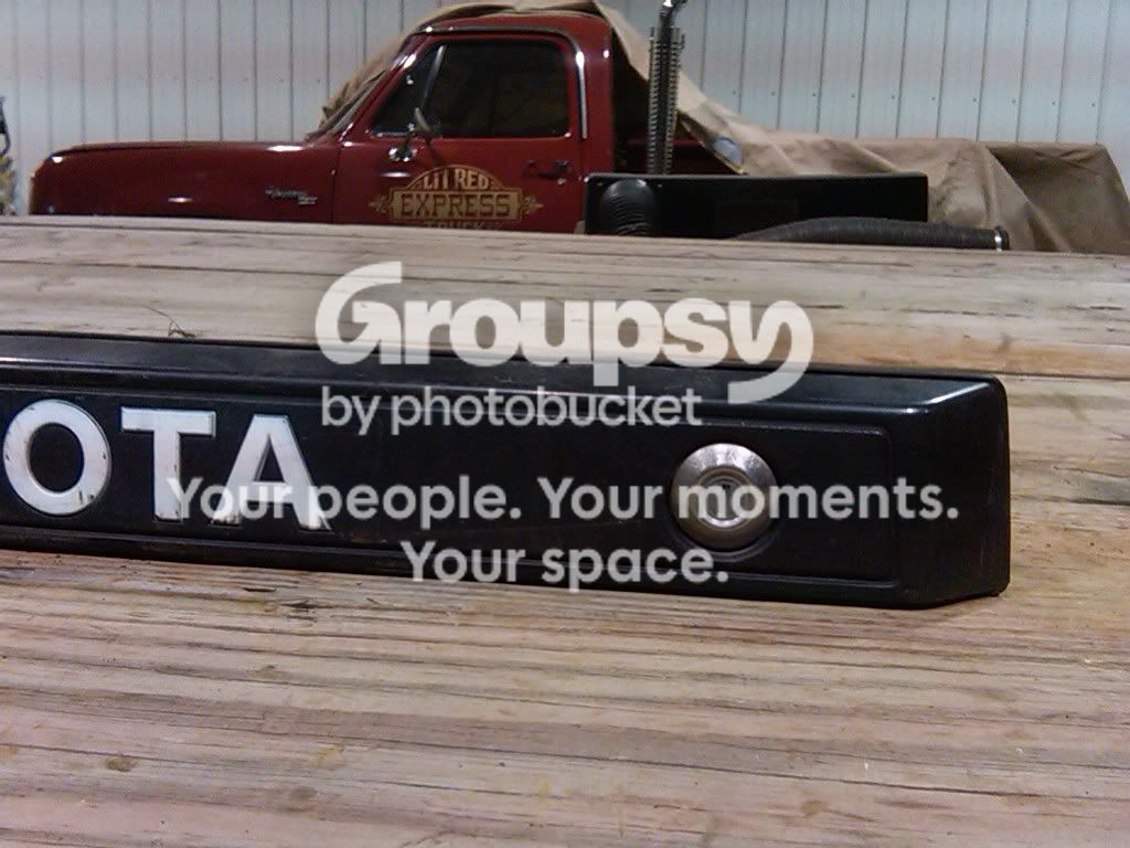

You then need a 10mm wrench to remove the two set screw to get this piece
IMG00099-20110215-1722.jpg~original

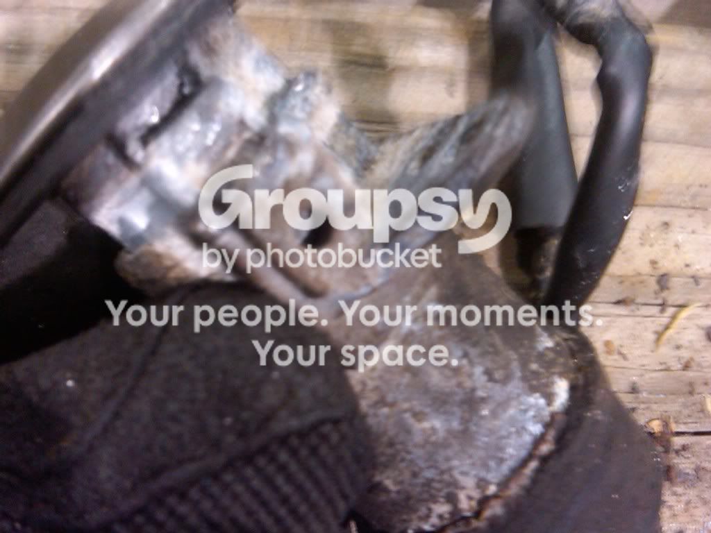

Once this is removed you will need to take out the set screw that holds the switch to the lock cylinder
shown here is i had already removed the set screw to show it better.
IMG00108-20110215-1754.jpg~original
IMG00105-20110215-1754.jpg~original

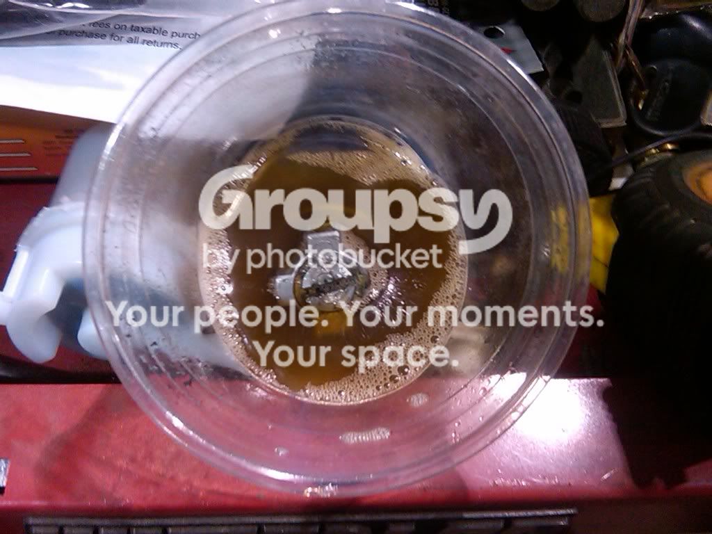

Next if your lock cylinder will not turn you should soak it in a solution of 3 ounces PB blaster and 3 Ounces common paint thinner.
IMG00116-20110215-1814.jpg~original

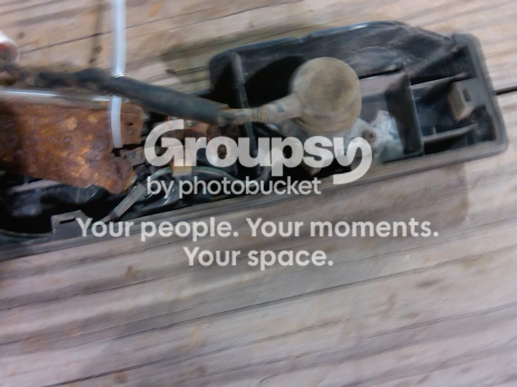

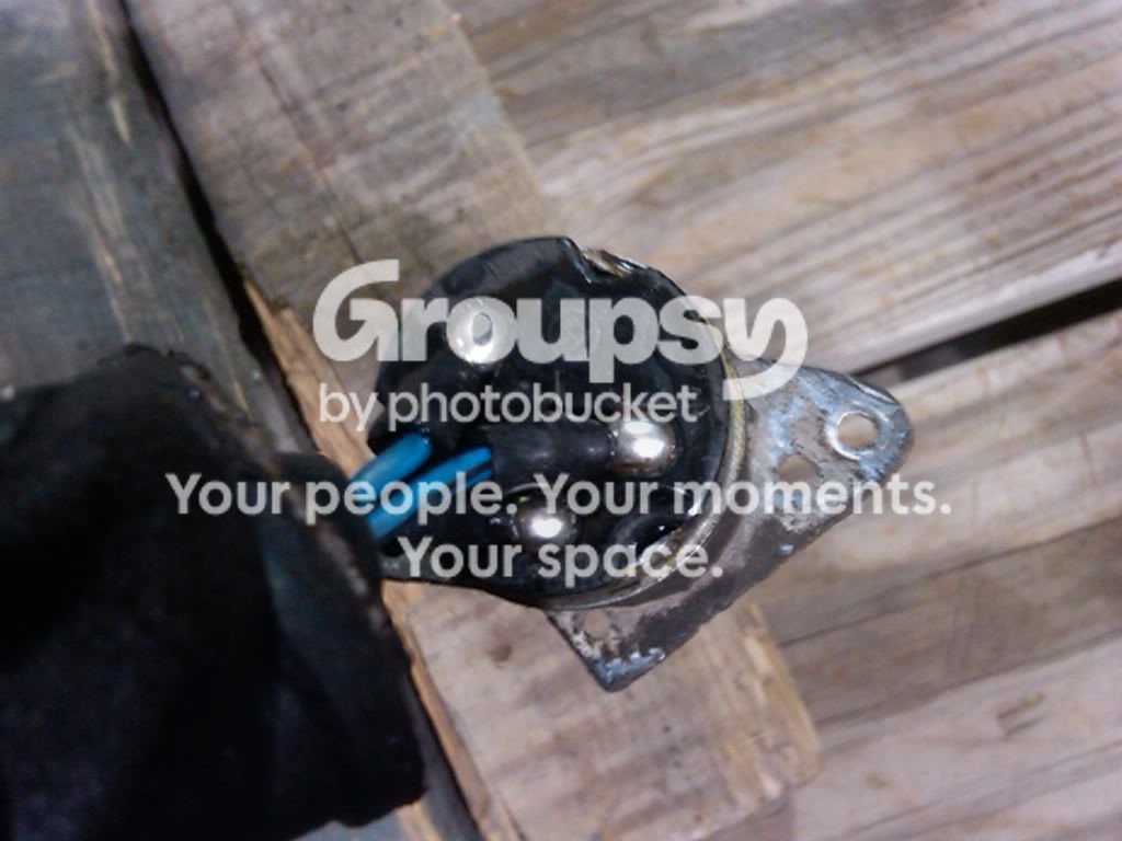

Ok so you will have two parts now, you will need a can of electric contact cleaner. You should spray the contact cleaner inside of the switch unit by using the small hole on the side or the switch cylinder rotating assembly pictured below.
IMG00111-20110215-1755.jpg~original
be very liberal with the spray! next use a standard flat head screw driver to rotate the switch back and forth and back and forth and repeat this till the contact cleaner is dry and then repeat this again.

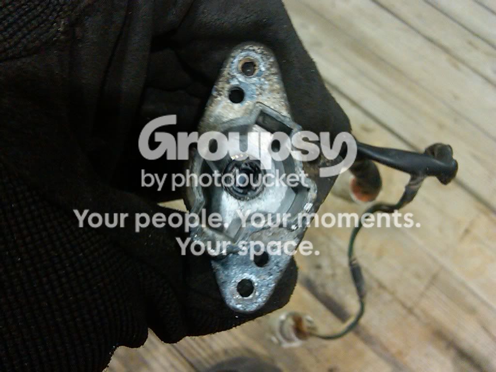

Now if this does not solve the issue stay posted im working on the switch after i buy the heat gun to un-stick the glue that holds the switch to the switch cylinder.
IMG00115-20110215-1808.jpg~original
next up is to heat the switch cylinder to loosen the glue once this is done you can use a needle nose pliers to pull the black unit from the cylinder.
