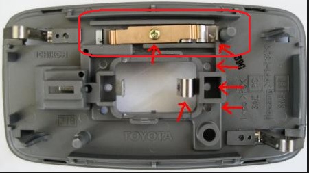

The contacts in the light switch itself were the culprit in my case.
(Ignore the arrows in the pic) What I am referring to is the section circled in red.
