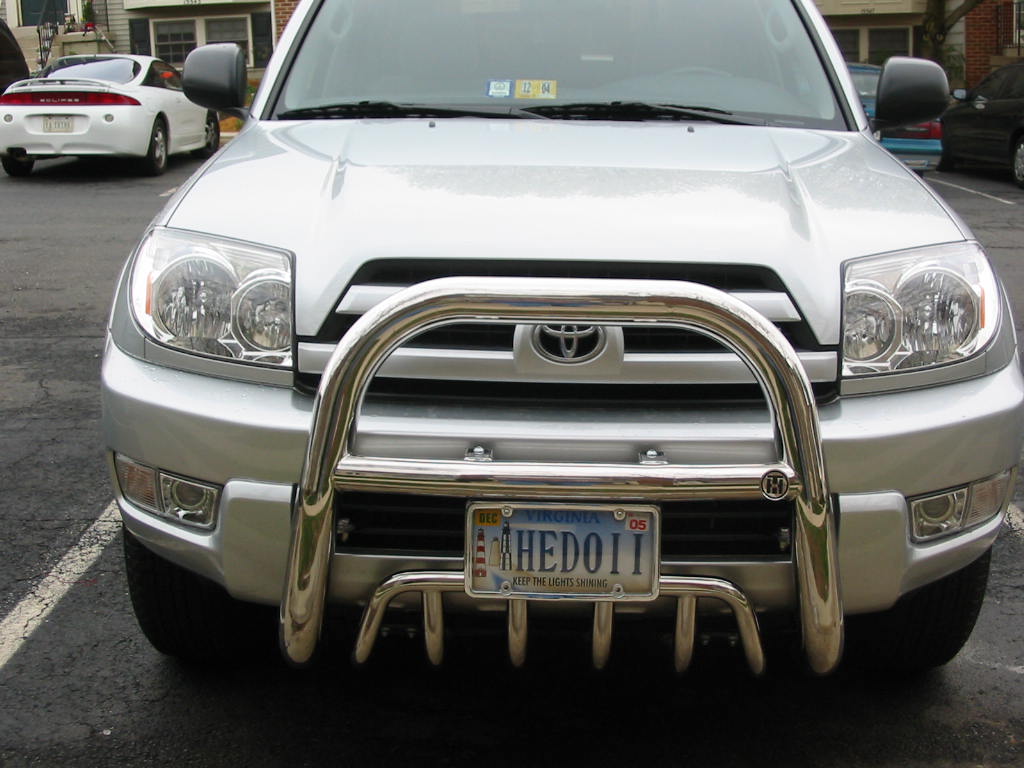

Man, that looks real nice! I'll have to keep an eye out for your Runner!

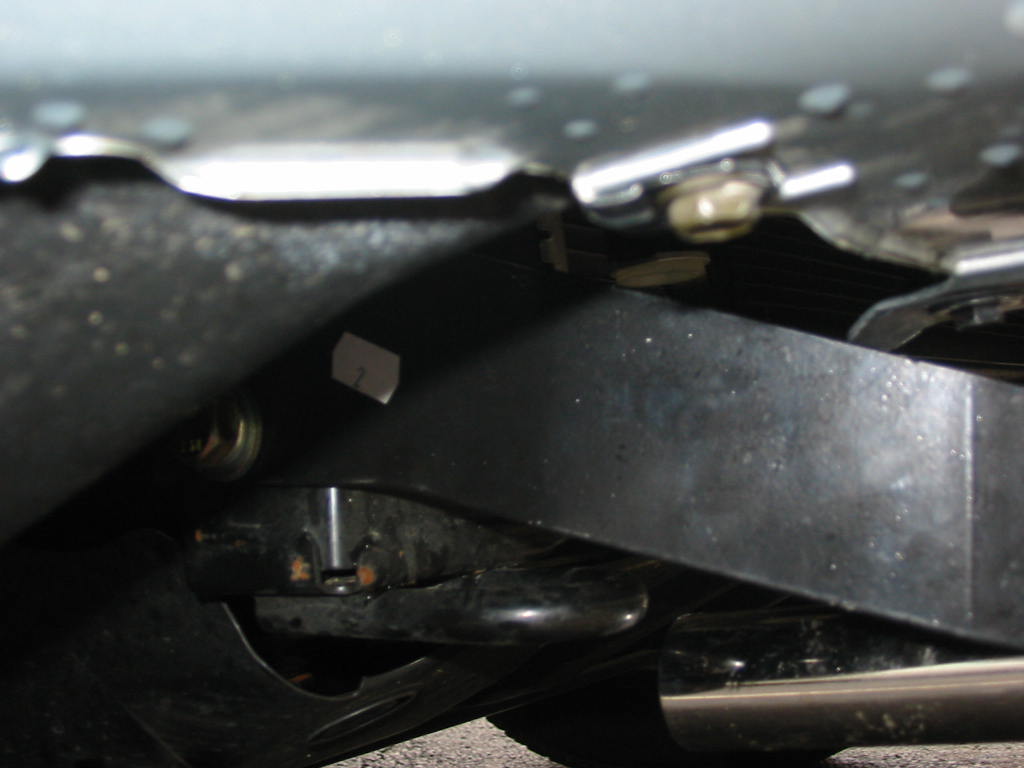

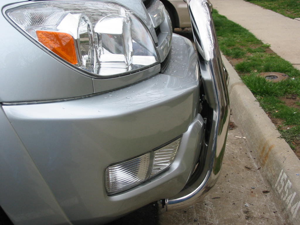

Some questions for you. How much does the bar stick out from underneath? What I mean is do you lose some ground clearance and if so how much (estimated)
Since you have the tall bull bar, do you have any issues with hood clearance?
Is it predrilled for mounting lights?
640 shipped is an excellent price, I'll have to inquire if they have the low version.

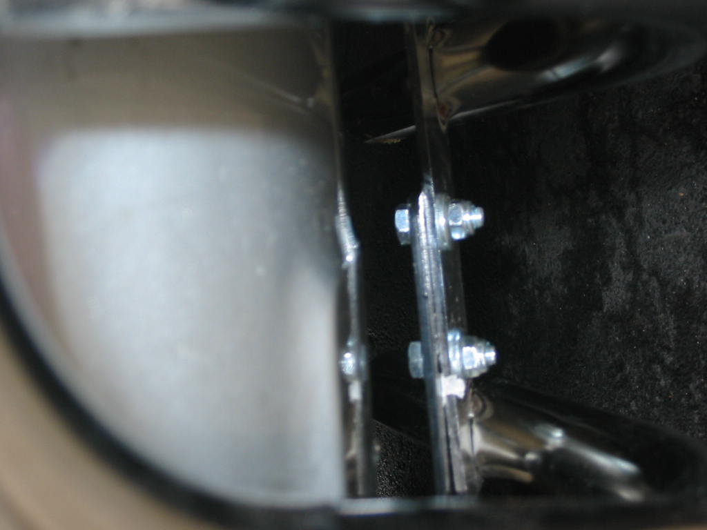

have to say they are different. just one thought though, in the 2nd picture, is it just me or do the mounting bolts/nuts seem a bit small and thin? i would have thought for a brush guard you would have gotten something abit beefier for mounting bolts.

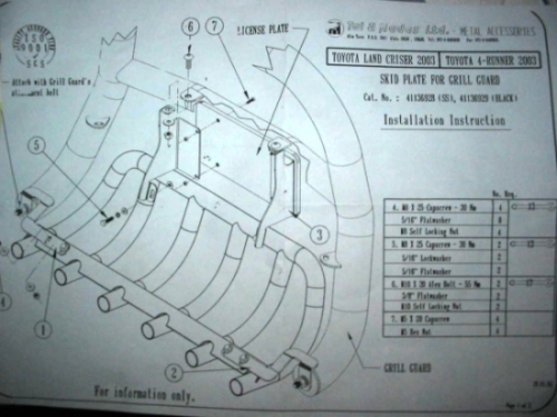

The nuts/bolts attached to the frame underneath were 3/4( not sure what mm that is). Nuts /bolts used to attached skid plate to guard were 13mm.
I think the only lost of clearance would be about 3'' around the bumper.
Skid plate cost by it self is 249.50. Center Guard is 388.00
Lights could be mounted were License plate support bolts are attached.

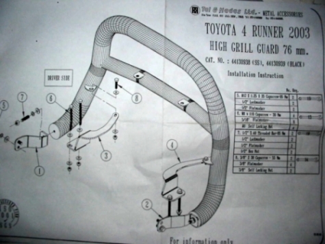

also Instructions only show the guard & skid plate....they do not show were they are bolted to the frame. It ook a few minutes to find the placement for the middled supports for the bar. Will post pic of them later tonight.
The reason I went with Stainless.....I thought a black guard would make the 4R look shorter since the color of the 4r is titanium.
