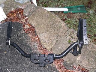

Well, I just got back from my dealership and found out the problem. I have a heady duty hitch reciever. It's not the same design as the one's which I'm sure you guys are refering to. When I looked at another '06 with the other type of hitch, it's simple. Unfortunately, I don't have it. Left with 2 choices; have brackets custom fabricated or see if anyone would like to trade up to a heavy duty hitch. See you in the classifieds!
Bob
Here's a pic of what I'm dealing with. It has a Toyota part number, so there must be two types. Any help greatly appreciated.

That's what I thought as well. I spent the day at 2 different dealerships, and there really is no rhyme or reason to it. V6/V8, SR5, SE, LE, totally random. But, thanks anyway.
V8 4runners come with the weight distributing hitches that can safely pull 7000LBs. The V6 4Runners come with the Weight Carrying hitch good for 5000LBs.
Well at the 2 dealers I went to today, it was random. V6/V8 didn't matter. That's what I had initially thought as well, but upon further review, it's not the case. I actually spoke to Hugo at T & H and he wasn't even aware that this style came stock. I forwarded him the picture as well as the part numbers. When I had the parts guy at Toyota try and look it up, the only trailer hitch was the smaller one. They're making this way too complicated for a hitch.
