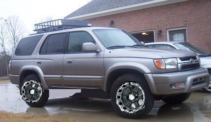

i also did a little paint editing to get a general idea of what they will look like. i think they look pretty sweet. i also took the running boards off while i was at it :bigok:

well with around 450 dollars what would you suggest?
and yea my MS paint skills are off the chain
yea but i want to get an inch wider on my rims, that way i can fill out my fender flares a little better
