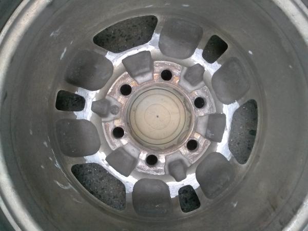

I've done it. Here's the finished product:
You just need to knock down that edge on the backside of the wheel. I went through a couple of grinding wheels to do two though, that aluminum is tougher than it looks. If you take you time and take an even amount of material off each one there's no need to balance. My wheels were fine with no steering shake even at 70+ MPH.
I did it to 2 different 3rd gens and didnt notice any balancing issues. Have over 20k miles on 1 of the runners. I'm not saying to do it or not, but I did it and havent experienced any negative effects. That's a small sample size.
