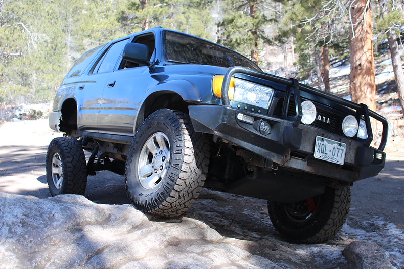

Just get some spidertrax 1.25" spacers from wheelers (link). I love the look of these stock wheels with larger tires.

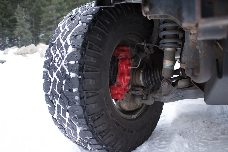

I can't find a good side shot to show the fitment, but this is as close as I could find of mine:
So with 1.25" spacers and those wheels I can fit the 231mm calipers on with no issues? If so I will go that route because I do like my wheels and my spare matches...
You know, grinding it down is a legitimate option if you like your current wheels. I did that until I scored a set of TRD Tacoma wheels. No issues and no rubbing.
