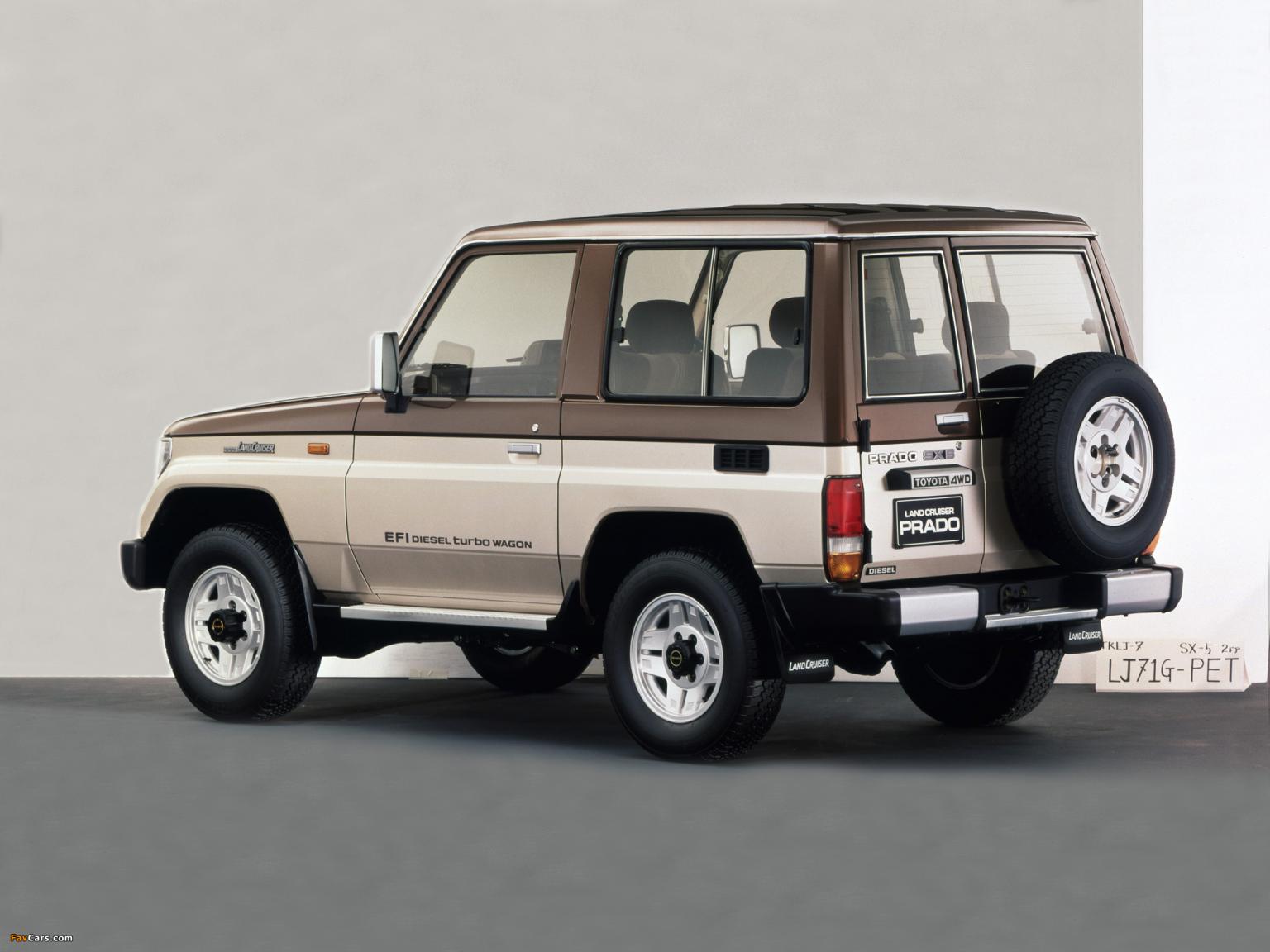

I have a 3 Door 1990 Prado ( Diesel Turbo) the engine got bitten by the "2LTE Head Bug" and it is over heating like crazy....
A lot of people suggested that I swap in a 5VZFE of a 2002 4 Runner
This is how is looks like (not the actual pic)
