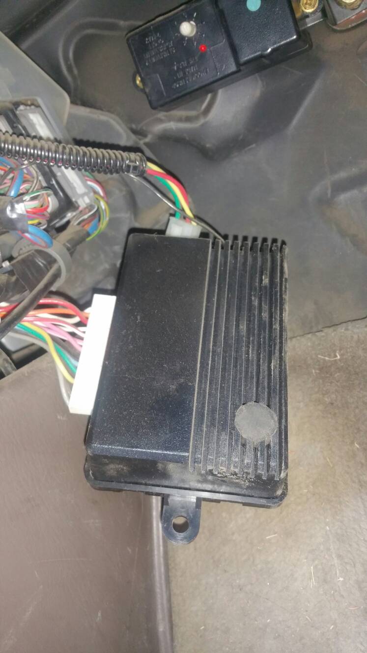

Update: im pretty sure i found the unit
Here it is and the motion sensor mounted up behind it, does this look familiar to anyone?

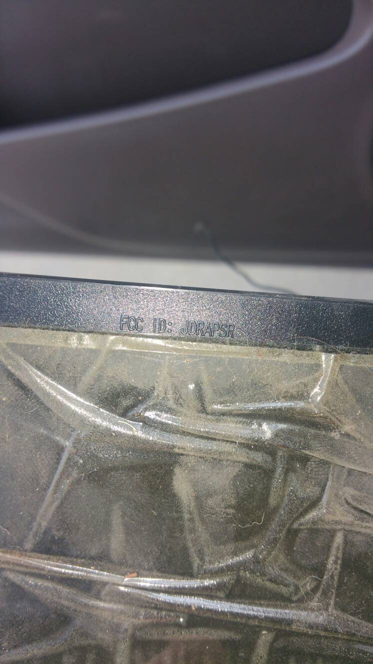

No, there is not a box under the drivers seat, looks to be like the dealer port added tds system after some research now that i have the fcc id.
For anyone with the same system this is the fcc id for the remote JDRAPSBT they are scarce but not extinct. I messed with my system and it all seems to functioning, im debating on whether or not to order a remote and see if i can get it to work
Probably a long shot but would anyone have a wiring diagram for this thing? Seems like it would he easier to just wire inna updated system.
