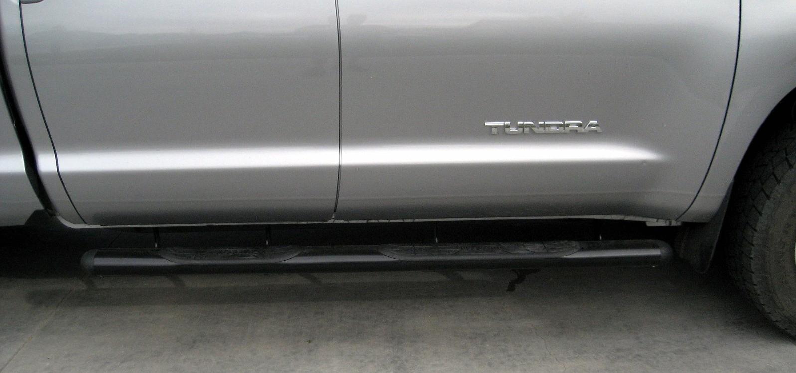

Just looking at your pictures, to me the rocker panel cover is just a beauty thing, my 07 Tundra was all exposed like that. I have a pair of DEEZEEs on order, but am thinking of canceling them, I found the n-fabs for $330 and free shipping. I can live without the beautification, for nice solid step rails.

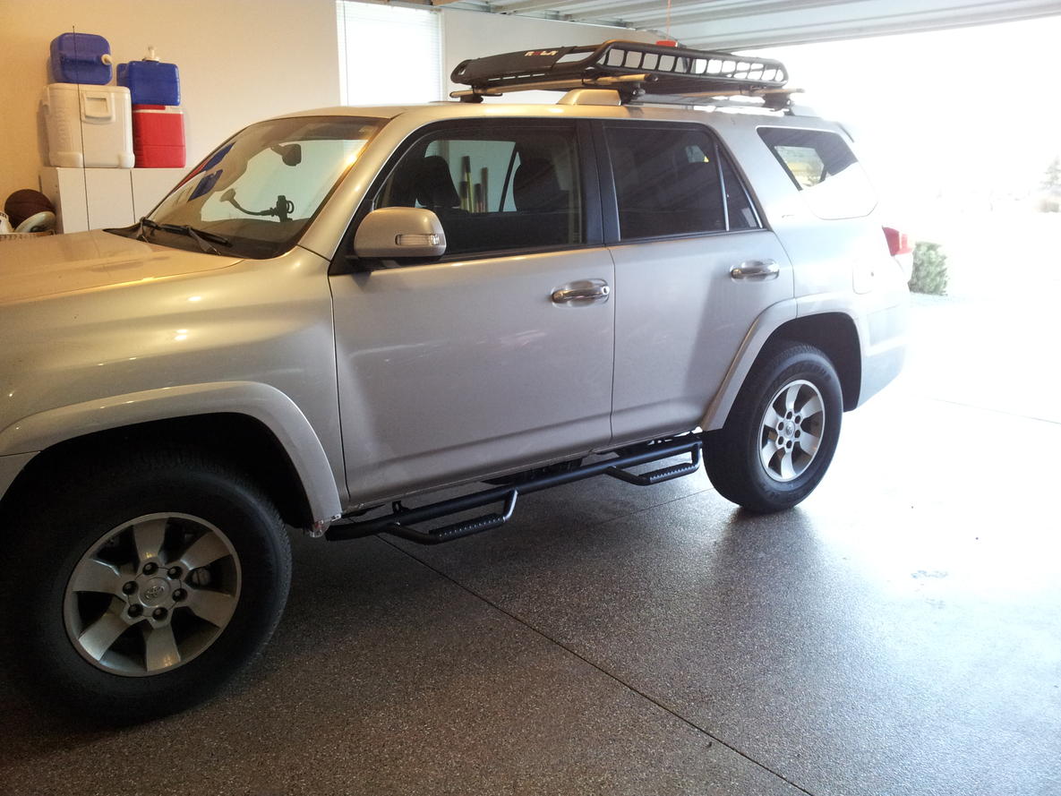

Just put the N-Fabs on, only thing I noticed and maybe missed in previous posts was that the front mount only attaches with one bolt. The rocker panels use two but one of them is not useable with the N-Fabs. I stood and bounced then retourqued to 13lbs. I called N-fab and they recommended 12-15 so I split the difference. I will probably copy the OPs method this spring or summer when it is decent/warm outside.
were these a direct bolt on after the rocker panels were removed?
