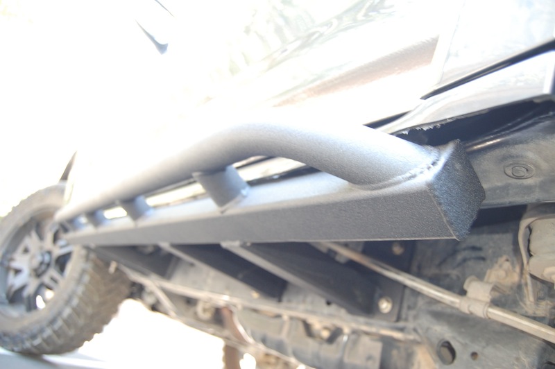

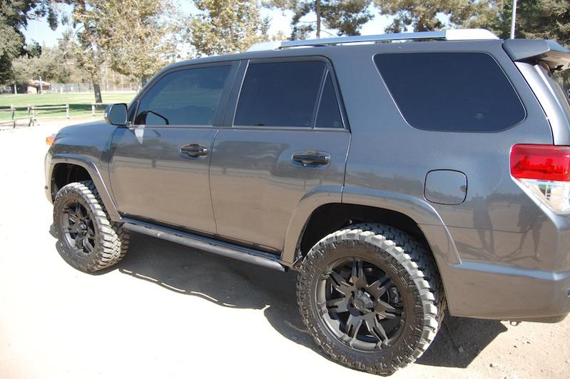

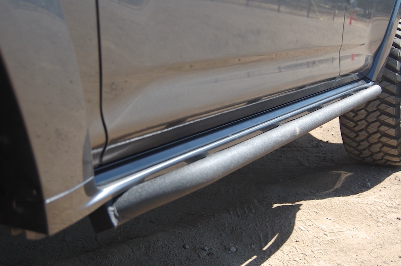

My sliders are from Demello Offroad but I cut my rockers to fit them and to retain the "finished" look.

see i think if they were longer in the front and back you wouldn't even need the rocker piece.
The rear wouldn't be too bad, but the front would remain an issue. You would also have some holes that are susceptible to rust. I would not recommend going that route. just my 2 cents.
