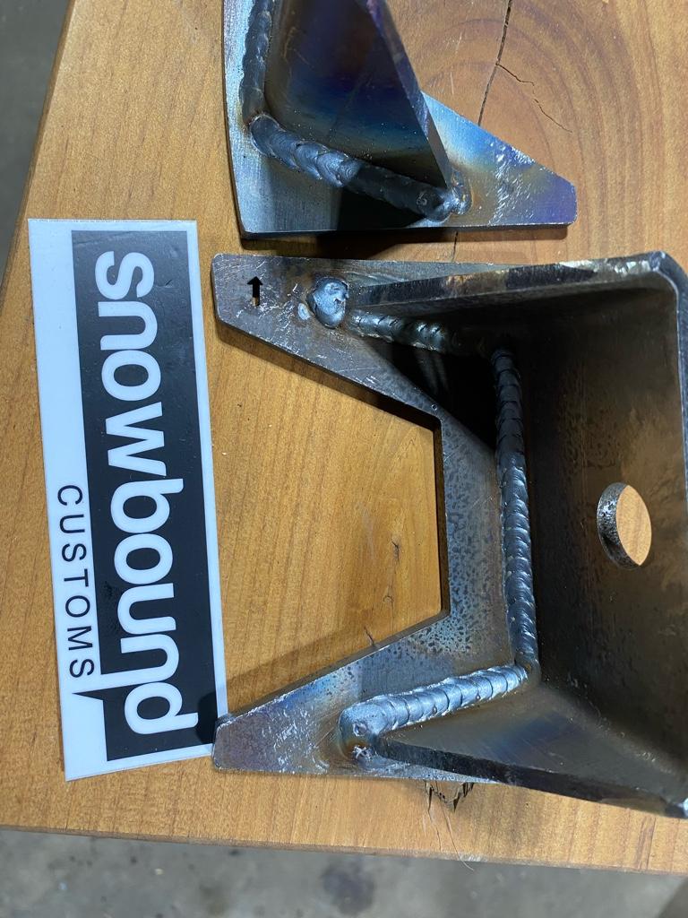

I contacted them about it. This is a Snowbound Customs product. They said with my setup, 2" dobinsons and 265/75R16 I wouldn't need wheel spacers. Hope that helps.
there's a guy in here who developed a design that he said was based on the N215 4Runner design but iirc, it would require a wheel spacer.
also, I'm not sure if he was planning on doing some mass fabbing and selling

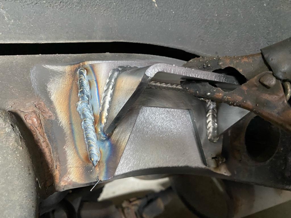

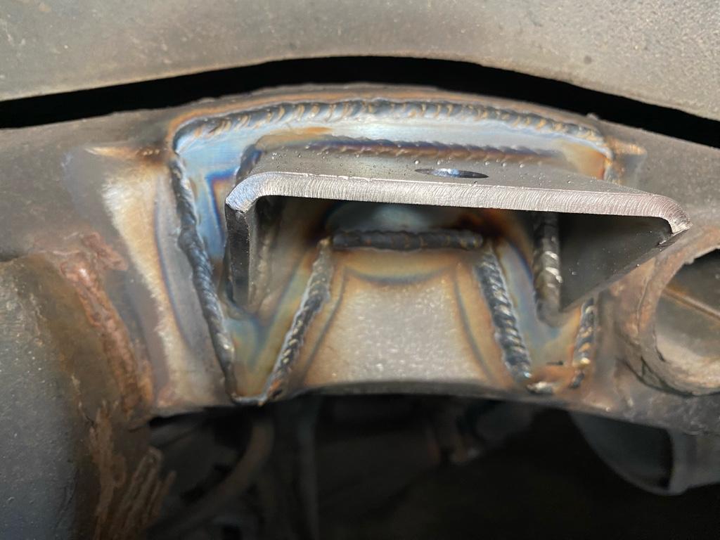

I love mine and took ten minutes to weld each one on.
My Build and Repair thread has the install. But, I’m thinking about creating a new thread for the install.
No backspacing required. I think snowbound mentions it will take a 2” shock and still have clearance.

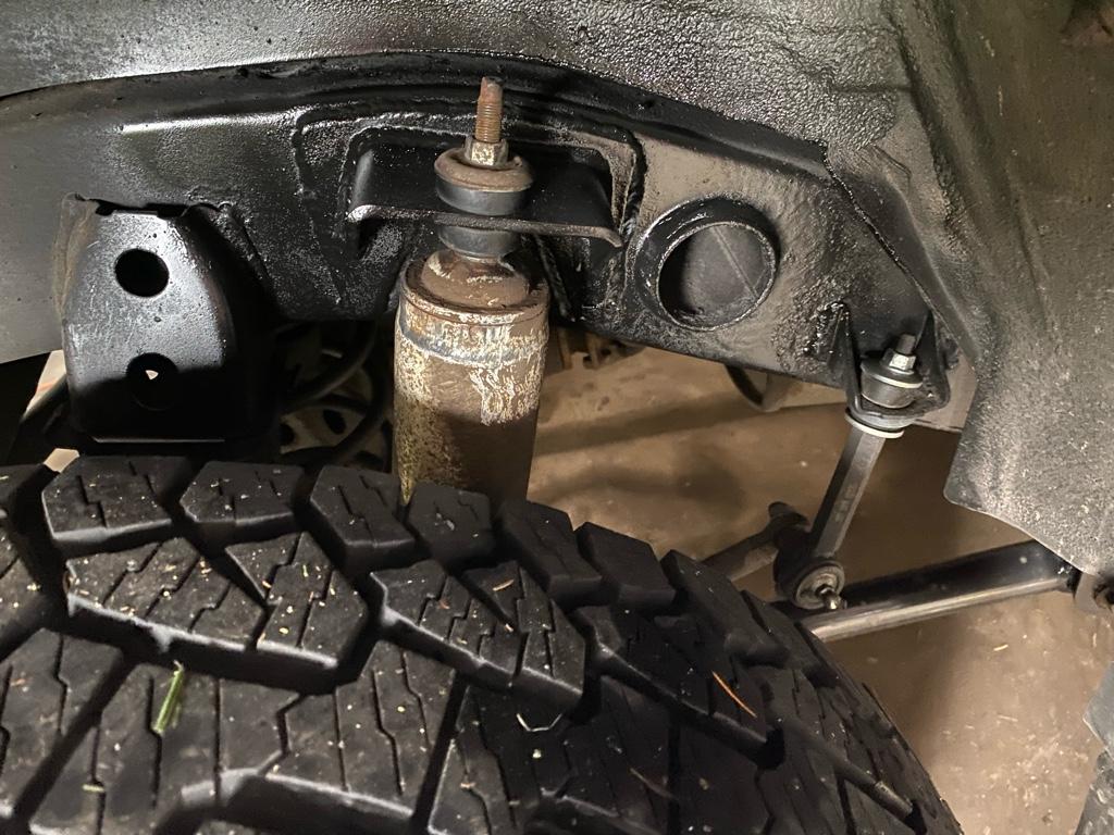

I probably am going to have to do this to Tetanus1 as it passenger shock came through the coil shock plate.. :/

Did it improve the ride quality? What do you like about it?
I mostly like it for accessibility and ease of installation.
Ride quality wise, it may be a little firmer. However, going over bumps in a turn at speed seems more controlled. And my Gabriel’s are not the softest of rear shocks.

been running like this for a while
started here
https://www.toyota-4runner.org/3739060-post246.html
https://www.toyota-4runner.org/3739977-post249.html
https://www.toyota-4runner.org/3741921-post250.html
it's been fine and I don't really notice a huge difference between the stock ride on my other 98 and the outboard shock mounts.
The huge difference is swapping shocks in and out... if you’re wanting to do that the outboard is like 2 mins. if you wanted to run longer shocks it's totally an option, I just have not tried it yet. I posted all the .dxf files so if you want to have my design cut and can weld it's an option.
