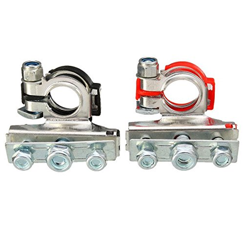

i have searched and not been able to locate any good information on what battery terminal clamps are good for many accessories. My positive battery terminal is kind of getting crowded with wires (pics to follow later)... and i am looking for a reputable reliable solution like this:
Downside fo the above is people are saying its cheaply made and flimsy. Also i dont like the way the plate acts as a washer, so i would change that too.
is there a good solution out there? Am i missing it? I am not the most electrically inclined and could definitely be missing it. also im not willing to change out my batter at the current time for one with additional posts. Int he future though that is a definite possibility.
please help!

you guys are awesome. All good solutions and all a bit different from one another! i am leaning towards the terminal block option as i think it will be the cleanest looking install if i can find a place to mount it.
