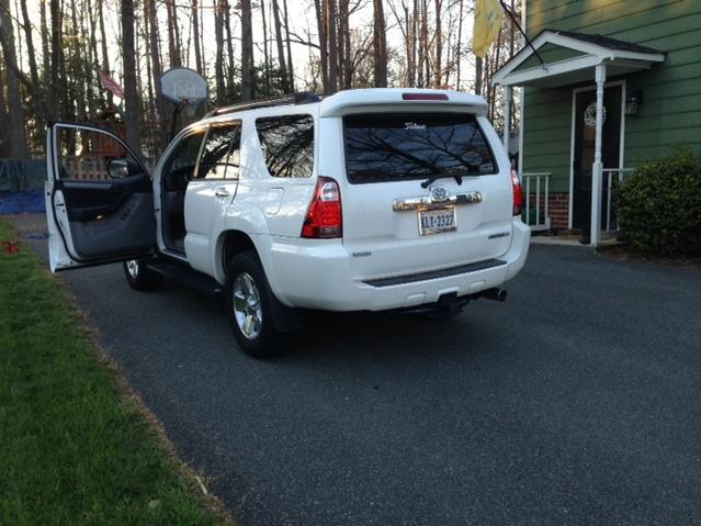

OK, so I test drove this today.
2006 Toyota 4RUNNER
It's pretty clean. Husband is a Toyota mechanic, they did the timing belt at 87k miles, and he has done all the work. They are second owners. It has been in my area since bought, so no rust or salt problems from the north. Mileage is 96,000.
I did not know it was all time 4wd. How do you all like that?
The V8 sounded nice.
We negotiated 15k. KBB is 14,800 excellent condition. I haven't pulled the trigger yet, just wanted to see what all of you thought.

I hate the AWD. I would much rather have the t-case that comes with the V6 to reduce wear and tear on the front end, and to save 0.5 MPG.
But that looks like a really sharp 4Runner. Appears to be well cared for from looking at the pic.
