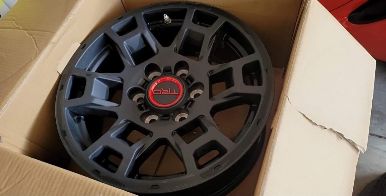

So stoked to have found a set of the 2021 TRD Pro 4Runner wheels. Love the center caps and how they’ve evolved vs previous years. Now to get some tires and get these bolted on!!!
