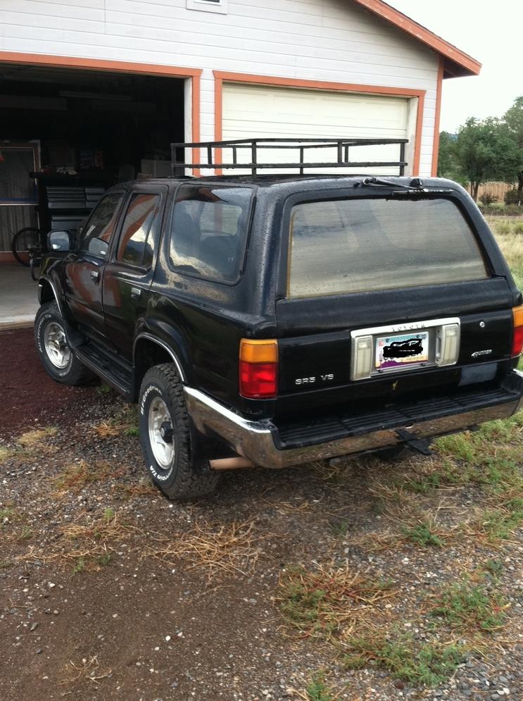

Okay...it only landed because I did a down-and-back to Tucson on Friday night! So here she is. I've got a laundry list of things to address...I'll be glad to take suggestions for parts sourcing, part brands, or anything else you'd like to chime in on.
From what I understand, the engine was rebuilt 5K ago...the clutch was 20K ago...and has had a lot of new steering components installed, and new(er) Rancho shocks all the way around. That said, it drove surprisingly well for the 4 1/2 hour ride back to Flag. It was a little steamy for a while, as the a/c is inoperable at the moment...and trust me...the heat coming from the floor/firewall was a reminder of my prior T4R. :flamethrwoer2: It's got 3 really good BFGs on it...the other, not so much.
So...here's the list so far:
1) Fix that damn brake light - I already pulled the cap...it wasn't low on fluid, and unplugging/plugging in the connector didn't do anything either...
2) One new tire, coming right up!
3) The driver's door needs help. The power mirror doesn't work, the lock tumbler and door handle linkage are broken beyond repair.
4) UNCOMFORTABLE SEATING! Gotta do something...just not sure what...
5) Skid plate = missing! Too much is sticking out to not be protected by one...
6) Splash guards in front wheel wells...also missing. See #5.
7) Left turn signal assembly is smashed in the front. Don't need help in getting picked up...better find one of those quick!
8) Rear hatch lock...not sure what's up, but it won't budge...
9) Windshield trim (the top side)...anyone know where to get this?
I know this is mostly piddly stuff, but since the soon-to-be 16 year old daughter is likely to be getting behind the wheel, I need to make it safe for her. After this stuff? Who knows...a good bath...a little scrubbing...then gas it and go! :driving:

Okay...it was a long day in the driveway, but we got some stuff done:
Driver's door: Replaced the power mirror (thanks ebay!), but the lock/latch mechanism was a beeotch. Not so much that I couldn't get everything to fit, but when I reassembled everything with the junkyard parts, the power lock actuator didn't work, and the new lock tumbler wasn't tight enough. $h!t!!! :redbrick: :redbrick: :redbrick:
So...I disassembled EVERYTHING...tightened up the lock tumbler clip...stole the good door handle-to-latch linkage from the junkyard assembly, and attached it to the assembly that was in the car, and reassembled everything again. Success! The door handle opens the door...the key locks and unlocks all doors...
Skid plate = missing...but for a reason! When I got underneath to wrench it on, I found that not only was one of the front holes bashed out of shape, there was a bolt broken off flush in one of the rear attach points. I used a beefy screw gathered from the junkyard and a large drywall anchor to attach the front...will need to get a tap-out to back out the broken bolt on the back side. It's pretty secure on three points for just road driving...
Left turn signal assembly replaced with a junkyard piece. Since this thing took a minor shot to the driver's front corner, reattaching anything is an adventure. Ended up routing out one of the screw holes with a larger size drill to be able to cut the angle to the screw attachment in the bumper. Still a little jacked up, but it is complete, attached, and functional.
Head light assembly - replaced the entire unit with a junkyard piece. Once again, the shot to the front made lining up anything a challenge...plus, the PO had used some interesting fasteners during his own repair attempts (phillips screws + nuts?). Gotta love changing sockets for every fastener. Getting the grill wiggled around everything was fun, too. Bent bumpers make fitting parts a PITA!! The junkyard headlight worked, and doesn't point down at the pavement...so...SUCCESS!!
I will need to find some grill anchors at the junkyard...it's so effed up, it is more of a "floating" piece at the moment, and probably could stand to be replaced itself. Maybe on the next JY visit...
Rear hatch lock...nothing wrong. Just needed to put the window all the way down! I got a trim piece for the rear window, but the clips are shot. Probably have to go to the dealership for those...
A long day of frustration...but it sure makes up for it when you can actually get something to work!!! :banana:
