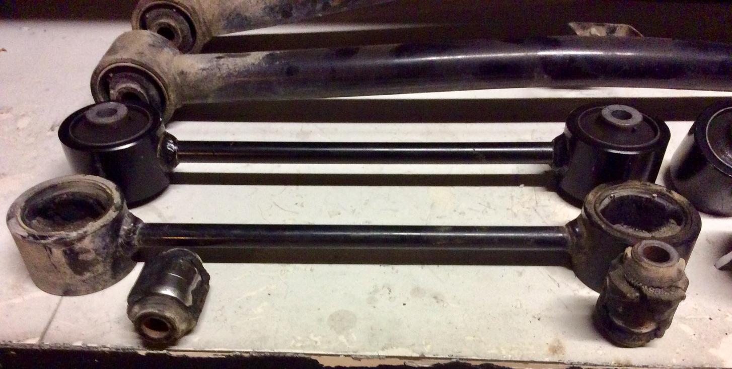

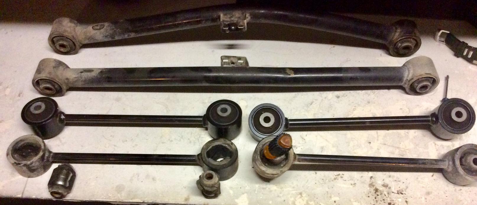

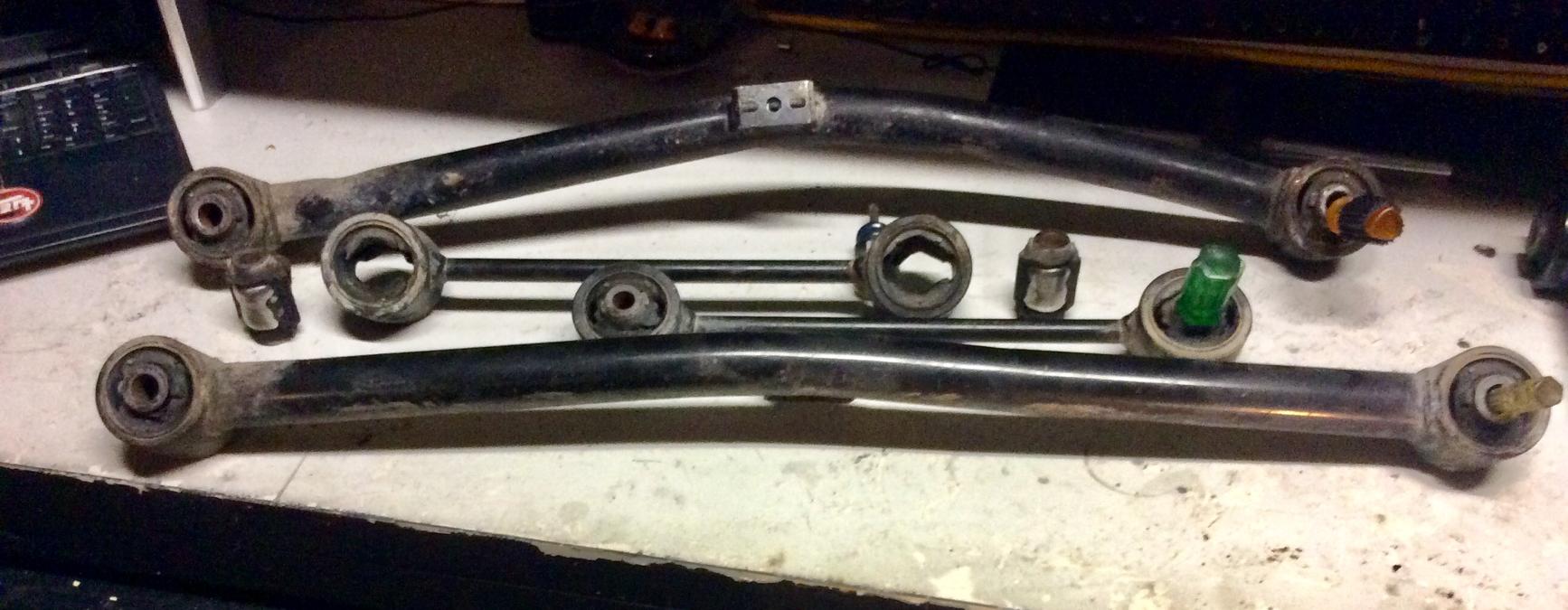

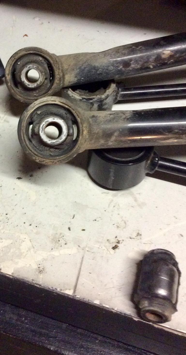

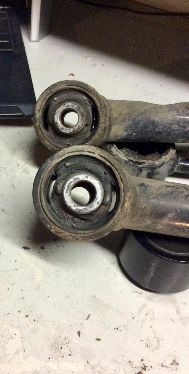

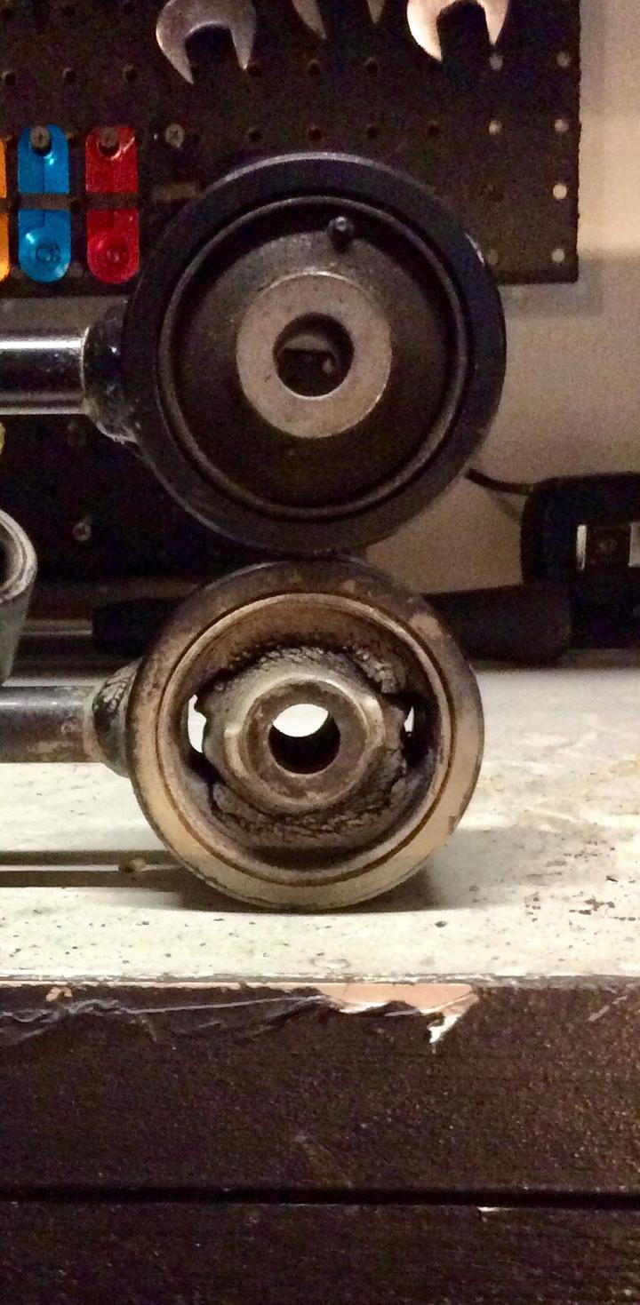

So I was replacing my rear lower control arms with a new set I acquired cause they were bent as you can see in the photos which I knew was contributing to my issues but what happened next was when I decided to go ahead and change the uppers with a brand new set as well figuring why not since I have them .. which all 4 links are brand new 5th gen OEM bars.
Well when I pull the bolts the centers of the uppers just fell out into my lap ...so those haven’t been doing anything at all and when you look at the photos the bushing on every single arm you can see thru them and are only attached by a couple sections of rubber ...I can pretty much tap the center sleeves out with a hits of a hammer ...so the rear has been just floating along aimlessly ...in a since
The upper uca’s are original stock one the lowers have been changed twice due to bending them...

well you werent lying, there is definately no wondering about whether or not if those are bad lol. glad you found that before it caused an accident :cheers:
Wow. Yeah those two little rubber slats that hold the arms together aren't very tough. In all reality one should loosen all control arms with that style bushing when lifting a rig, then retorque with the vehicle sitting at static height to help not preload the bushings. But with any offroading and articulation it's going to wear, especially at 300k that's damn impressive really! I swapped mine out for energy suspension poly bushings around 130k miles and even my stock ones were pretty worn, really tightened up the road manners. The only downside is they get squeaky at times but I think it's worth it for the 360° rotational ability with minimal bind in the bushing and more controlled ride.
