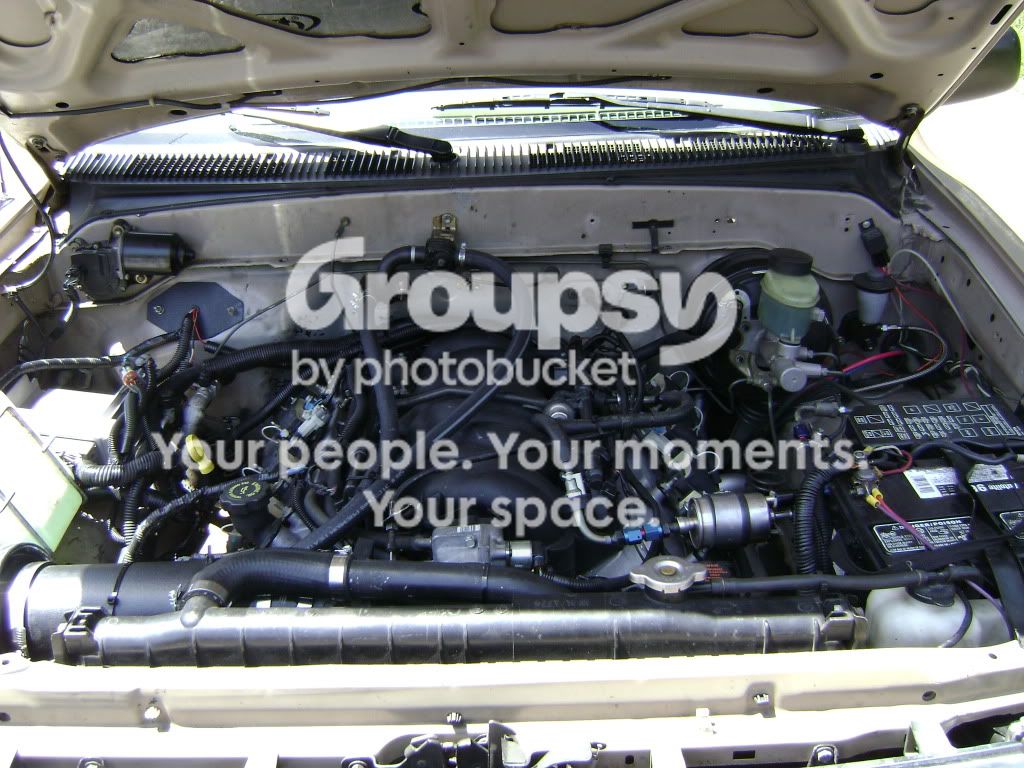

I did the big three and it felt like it made a difference when starting. Also installed a 2nd battery and about to do the CS144 alternator upgrade 140amp easy and cheap.
So far the stock alternator has been fine charging 2 Batts and accessories though.

It's the same thing as putting Chevy axles under a Toyota for a SAS setup. Not too far out of the norm anyways.
At any rate, the CS144 is not a "Chevy part" but actually an ACDelco product, who does make some Toyota parts.
Some chevy parts are considered an "upgrade" ;)
