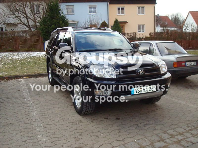

Stock:
DSC06865.jpg~original

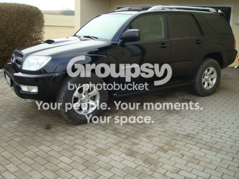

Spidertrax spacers and Daystar 2.5" lift
DSC06941.jpg~original

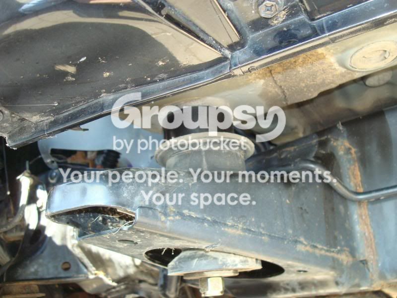

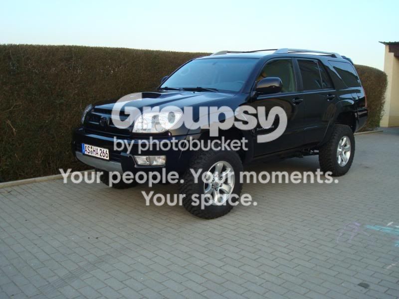

1.25" 4Crawler Roger Brown body lift
DSC07016.jpg~original
DSC07017.jpg~original

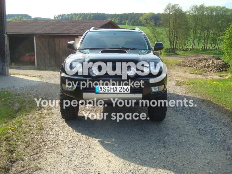

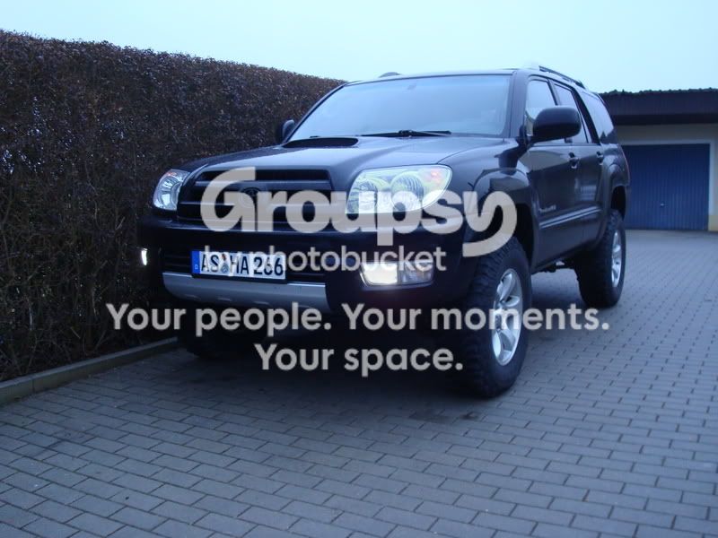

KC Slimlites (130 watt titanium finish) and blacked out headlights
DSC07097.jpg~original

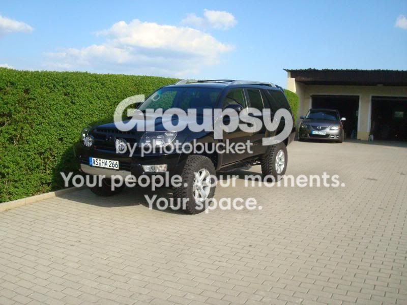

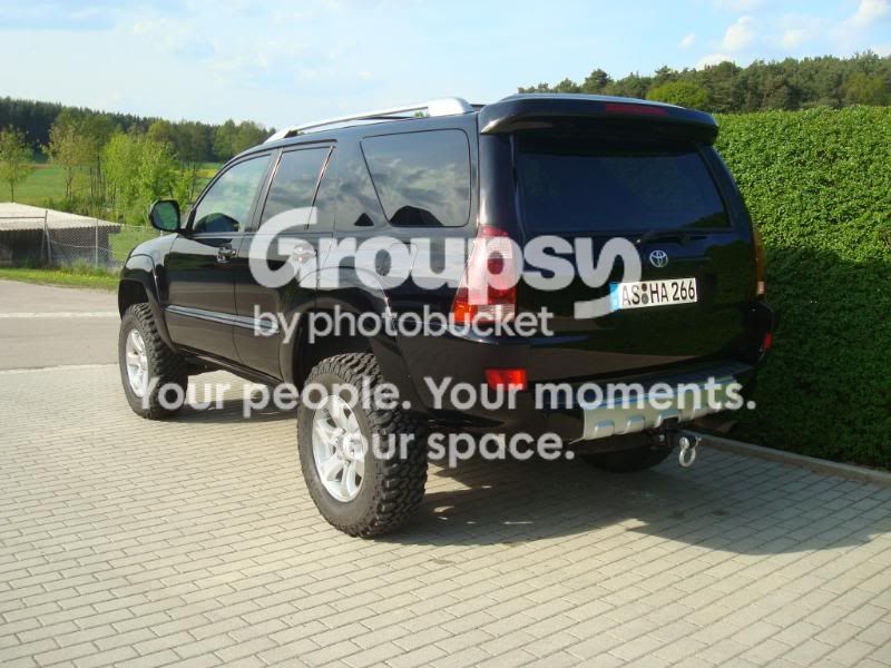

Debadged and waxed
DSC07099.jpg~original
DSC07101.jpg~original

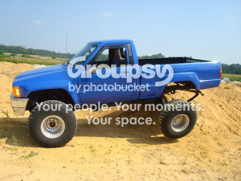

And here is my '86 pickup, 6" lift, 35" M/T's, fiberglass bed. Next mod: Going to paint it flat black.
DSC05723.jpg~original
DSC05916.jpg~original

How are you liking the RB body lift? I am kind of considering getting the 1" one but am not sure how it will look with my sliders

I am really impressed with it. I got the kit with the heavy duty bolts which are larger than stock and also had to get the steering shaft extension since I got 1.25". The 1" does not require the steering extension. Also I had to lift my radiator but no biggie. I did the whole thing in my driveway with simple hand tools, took me about 3 hours or so to finish it. Next thing I want to do as far as the body lift goes is I want to weld in some new brackets for my spare tire carrier since I have a full size spare (32") I want to lift it up an inch, I want to do the same with my fuel tank too. Pretty much tummy tuck what I can underneath and give some more clearance. I also want sliders so I am probably going to go with some weld on ones since I have the BL. Overall though I like it a lot and what my intent was as well was to get a little more clearance so when I get the Icon 3.5" kit I will have enough room to clear 34" or maybe even 35" tires with some minor trimming.

Makes sense about wanting to tuck everything up there. I just want a little extra clearance under full stuff since I get some minor rubbing. What made you decide to do the heavy duty bolts over the standard? I do not want to have to start drilling things out, since I want to be able to return it to stock without issue. Are these the standard size lift blocks or "ultimate" lift blocks? Also, did you have any issues with the bumper lining up after the BL?

I just figured that getting the HD hardware seemed like a good idea. I wasn't too thrilled about having to drill stuff out but much to my surprise the bolts actually fit just fine. Granted I had to use a ball peen to get them through (very lightly) but the hardware all fit into the holes very snug without drilling. I got the ultimate lift blocks, painted them black myself. On RB's website it says the 1.25" lift most closely matches up to the front bumper if you bring it up one set of holes. I didnt even mess with the bumper and it looks fine to me. If you look hard enough you can see a little bit of gap under the headlamp trim but its nothing major. Plus I was looking at how the front bumper mounts and if I moved it up one set of holes I would have to not use the inside bolts as there are only one set of holes for those. So I just decided to leave it since it looked fine and just keep all my bolts holding my front bumper.

Exacty you have it all understood. If you go on his page and (roger brown where you order the kit) you look at the instructions for 4th gen 4runner it has a link and the directions are perfect, breaks it down to the simplest task and has a ton of pictures. Let me know if you have a hard time finding it or need help with anything at all. Oh and dont fill your washer resevoir for a while before doing it because you will have to take it out and try as I did I still managed to spill all the fluid I had in there when I took it out lol.
boostedprozac said:
awesome! I can't wait to try it out. What did you use to jack up the car? Blocks with a hd jack?
Yeah I loosened the 4 bolts on the passenger side and removed the 4 bolts on the driver side and jacked the body up with my craftsman floor jack and wood block on the body right next to the frame about the middle of the body or so. Put the new mounts in, hardware and did the same thing for the other side.
Your 4R looks great!
Quick question about the KC's you installed....I was wondering how you mounted them and if you get any bounce when you are driving with them on? I have PIAA's installed on my bumper and no matter what I do, I can't get them to not bounce. I have them mounted to two different anchor points via an L-bracket underneath the bumper as well but they still seam to bounce on me.
