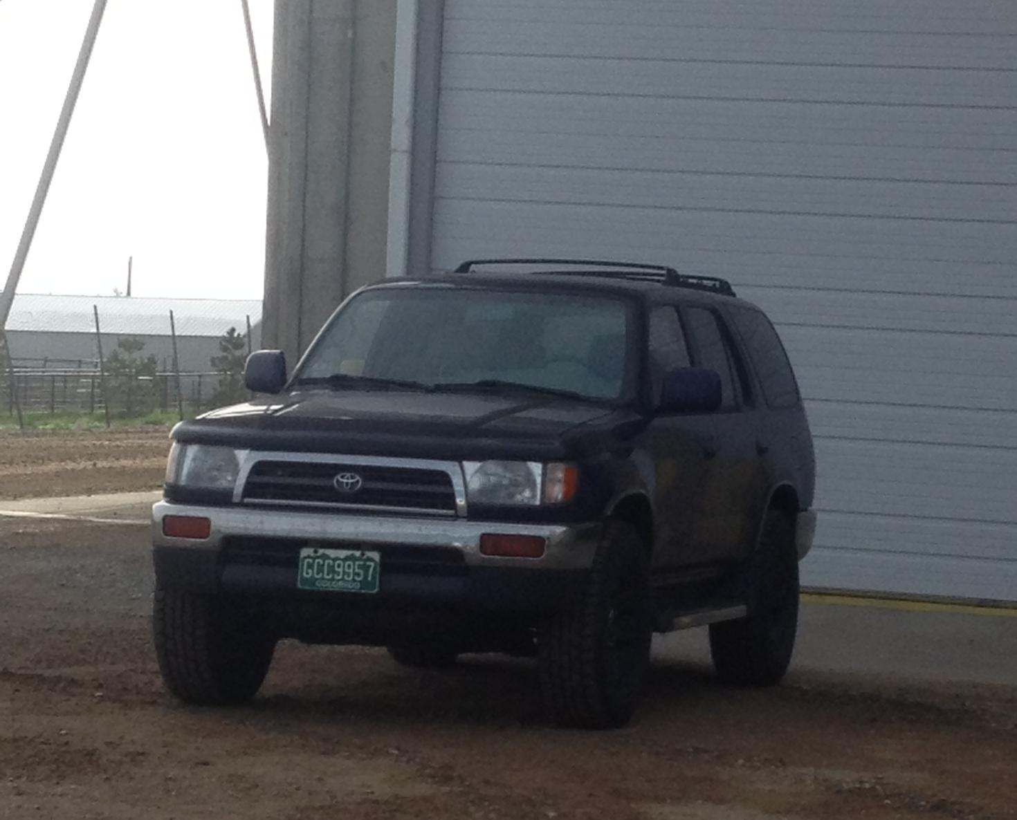

I love mine as well i have the '97 model and she just hit 130,270ish. :cry2: My parents actually bought her when she was just at 5 miles :bounce:. Wanting to add some mods to her just cant decide!
P.S- her name is also Stella!
