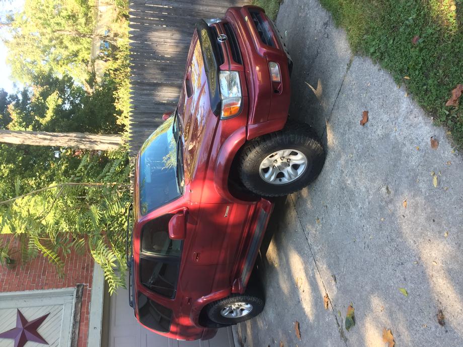

I cannot decide what to do. Ive never been a fan of running boards, but they actually look decent on the third gen. I guess I'm looking at it from a clearance perspective. I won't be doing any off-roading for a little while, but winter is coming. Personally, I'm leaning towards taking them off, I've always liked the look of the big finders without running boards. What do you guys think? Sorry for the sideways image.

Personal preference, but 98% of the members on here will instruct you to take them off or risk looking like you're driving a mom-mobile. Personally, I like them for a number of reasons and can't find too much that I dislike about them being on my truck.
Pro's:
- They are fantastic for keeping rocks, mud, sand and silt off of your paint whenever you're driving. Those who remove their running boards get plenty of rock rash on their rocker panels.
- I have a wife that is 5'2" (and is also 5 months pregnant) and a 5 year old daughter. They both thoroughly appreciate having the running boards to help get up into the vehicle.
- Keeping mud, sand, silt, snow, etc... off of the side of the car also means that less of it finds its way onto your pants legs when you're getting in and out.
- I think it helps balance out the appearance of the truck, making its body height seem more in balance with the length.
- Lastly, with just a 1" lift (highlander springs), I've never rubbed them on rocks even when on fairly difficult trails for a mostly stock rig. I've crossed the continental divide on a bunch of old mining roads and have never hung them up on rocks. This includes running Tomichi Pass, Hancock Pass, Old Monarch Pass (this is essentially a gravel road), and Tin Cup Pass in Colorado. Tomichi, Hancock and Tincup Pass all have hairy sections with somewhat significant boulder fields, and I've never been limited by my decision to keep the running boards.
CONS:
- If you're doing more serious trails, they don't provide body protection in the rocks.
- A large number of people on here feel that their manhood is challenged if they're driving a vehicle that in any way resembles a grocery getter. I find this to be more of a flaw in the security of their self image than I do a flaw with the vehicle.
When we were in Colorado over the summer, a large number of Jeep guys sneered and scoffed when I was asking about the aforementioned trails and tried to get info about them (primarily if they were still snow covered and if they were on fire during this last firestorm season they were having in Colorado). I would constantly hear, "you're planning on doing those trails in THAT?" While nodding towards my truck. Also heard was, "you know, it gets pretty hairy on those trails. You sure your rig is up to that?" We'll, being Jeep guys, they tend to disregard anything that can run greater than 100k without engine replacements, but my truck never even broke a sweat on those trails. I watched some of their scoffs turn into bewilderment as I knifed up some of those climbs.
They don't even sacrifice much clearance. Look how low the frame is compared to them. You're gonna need a lift if you really want clearance. Otherwise, you're just getting your rocker panels beat up. Frankly, the only place where I see that people prefer them removed is on forums. I removed mine and the rest of the world asked me why my 4Runner looks so weird.

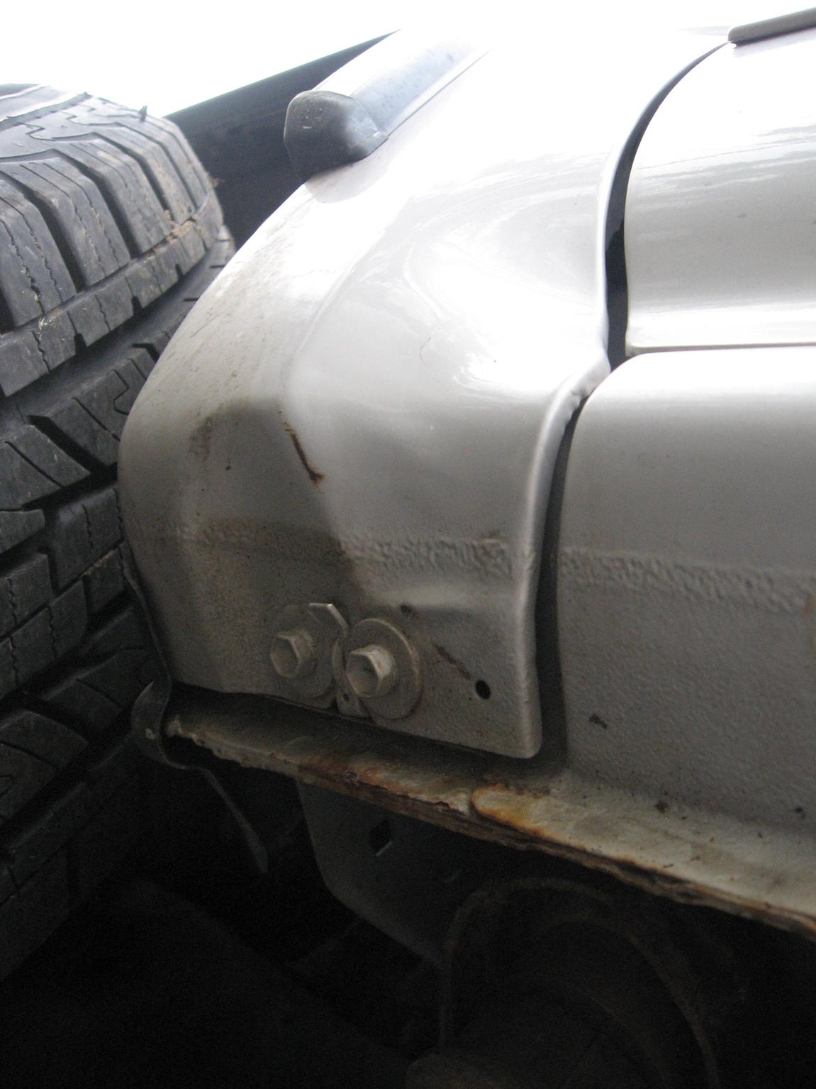

I disagree, the plastic from the running board rubs against the paint removing it & starts to rust the body, ask me how I know. Adding mud flaps prevents rock rash. They also keeps moisture trapped in the pinch welds. I wish I took them off many years ago.
Have you seen the 4Runners that never originally had running boards around here? Paint beat up and rockers rusted to piss. There's pros and cons to everything. I like to remove these things every few years and clean up the dirt that gets trapped under. These are twenty year old trucks and doing this makes sense as maintenance at this point. Give me a few minor paint touch ups over all that exposure the rockers will receive without them in any scenario.
It's kind of like criticizing the boxed frame for collecting moisture more than a C-channel. I'd rather maintain the boxed frame than have a weaker C-channel. You could weld some sliders under there, but I've seen sliders come down on rocks and dent the rockers anyway. There's pros and cons to everything.
Last month I was out with my mom's 4runner that I'm fixing up, limited edition with running boards. In a sketchy section I caught a big rock and bent the running board. The problem is they are attached with 3 brackets that run left to right so if you hit a rock they DO NOT slide, they grab it and can do serious damage. They are in no way sliders. They stick out several inches, reducing not only your clearance but width. True, rock sliders will do this too but they slide, they don't grab and bend/rip.
