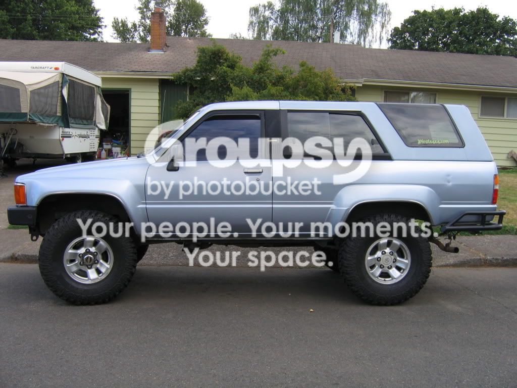

33"s will fit with no lift , here is an inexpensive way gain more lift on the cheap Toyota 4Runner 2" Lift Kit 4WD 1985-1989 -- Fat Bob's Garage Online Store
ifs-aal45.jpg~original

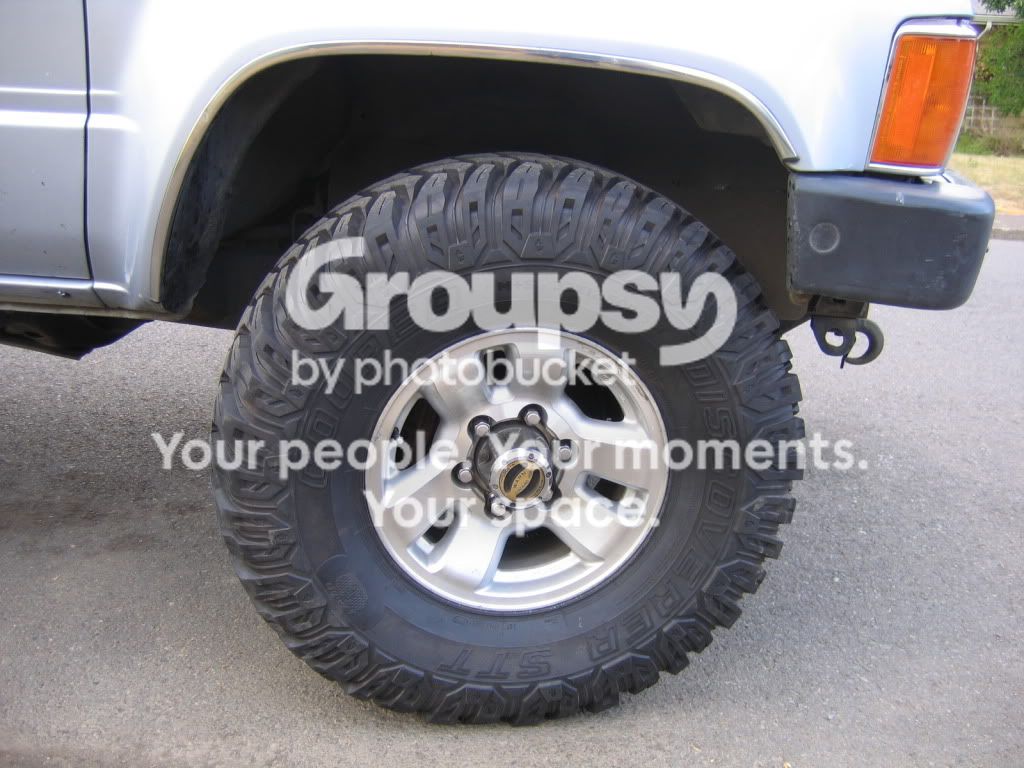

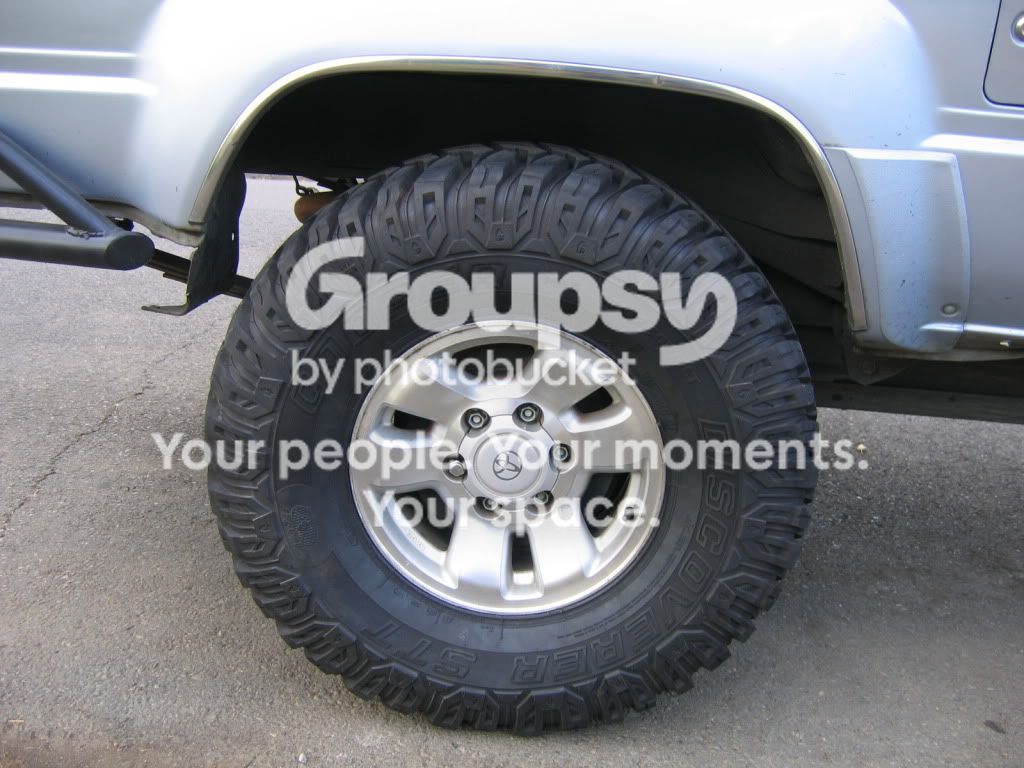

here is mine 33"s and no lift
misc2010010.jpg~original
misc2010011.jpg~original
misc2010012.jpg~original
33s will fit stock but they will rub in the front. I just put a set on my 86 and had to do some cutting. I had a saggy rear when I got mine. I put a set of add-a-leafs in and that cured the problem(stiffened the suspension a little tho).
