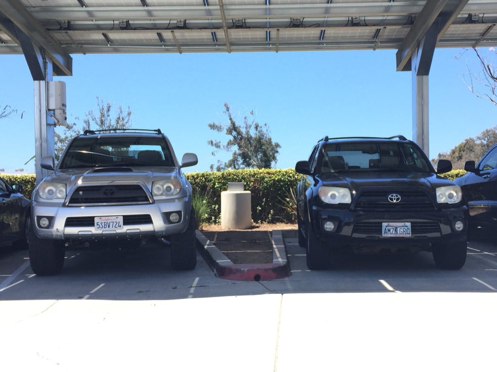

I ended up getting king 650# and have a 1/2” top out spacer. Driver is 6th perch and pax is 5th. I do have the metal tech rear coils. The driver side coil helps with the lean.
I think if I had an extra 1/2” of lift it would level it but I’m afraid to add anymore lift because I don’t want to bind up my cv axles.
If I end up getting a steel front bumper I will probably get a new front spring coil setup.
I don’t have a side view right now.
I’m off on my perch settings, I was thinking there are 7 but actually there 6. My driver is down 1 from the top and pax 2 from the top. Sorry for any confusion.
This is for the 6112’s paired with king 650# coils

When I had the 6112’s with the coils they came with and .5” spacer it looked very good with my 895e, and the handling and off-road characteristics were great. I had 5160 rear shocks. I went with the metal tech long travel rear end which raised my rear 1”. That’s why I added the king 650 coils.

I was at the highest perch setting driver and down two perches passenger. The spacer went on top of the top plate. After I put in the new coils I lowered the driver one perch from the top and left the passenger in the same perch as before. I did it like that because the rear coils I have now help the driver lean.
