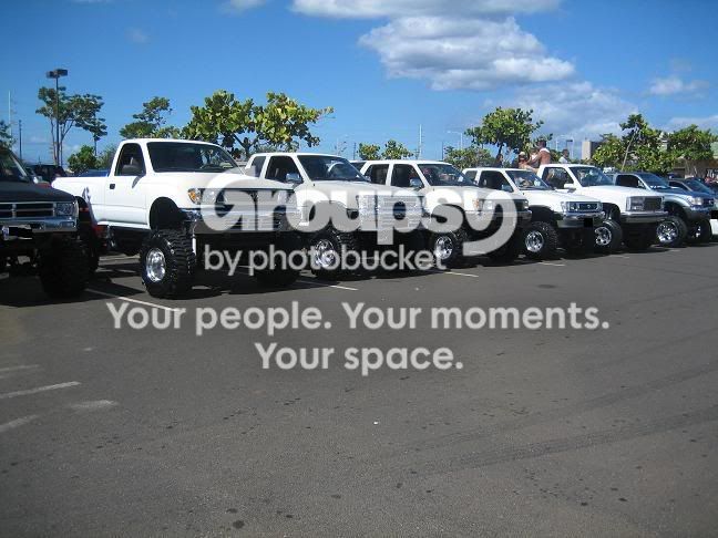

have you been to Hawaii all the trucks there have 3inch wheel spacers, i my self have 1.25 and got no problem so far but anything abouve 1.5 is kinda pushing the wear on bearings and stuff like that
