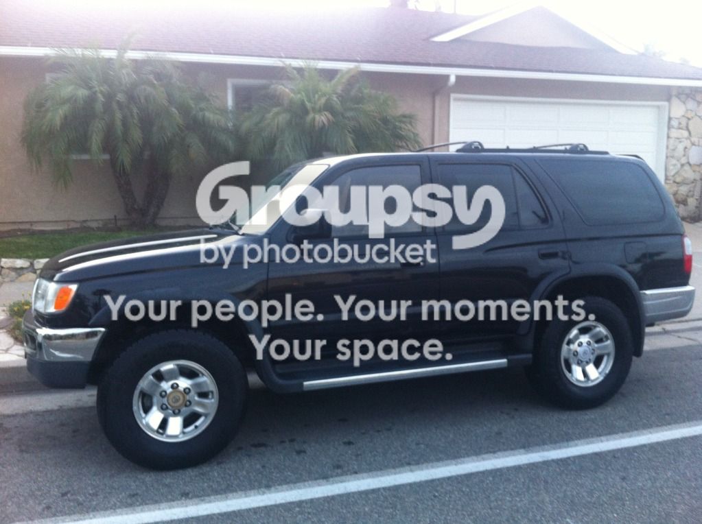

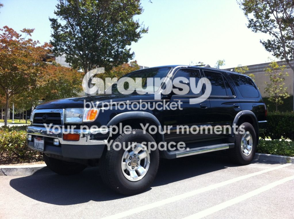

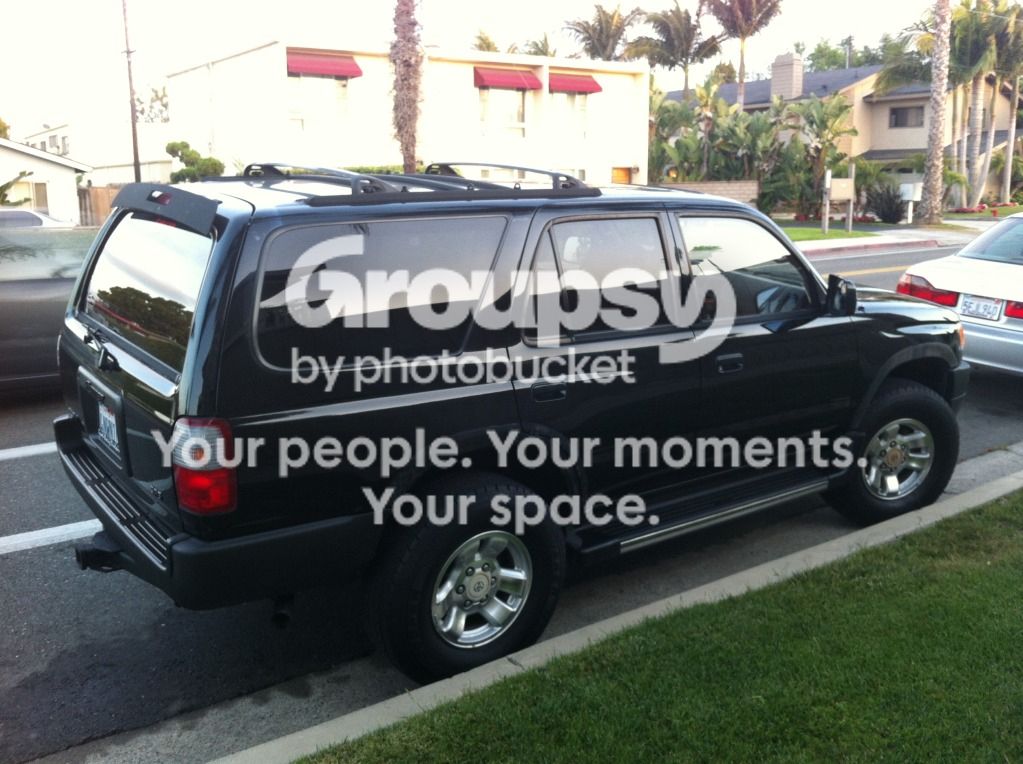

I'm new to this forum & to 4Runners, but have off-roaded in Jeeps for years. Last week I purchased my first 4Runner from my Boss for a great deal. He was the original owner of this 1997 SR5 4Runner, and sold it to me for next to nothing. Its well taken care of, but will need some mods before I can consider it "mine"!
The day I bought it:
IMG_7991.jpg~original
IMG_7955.jpg~original

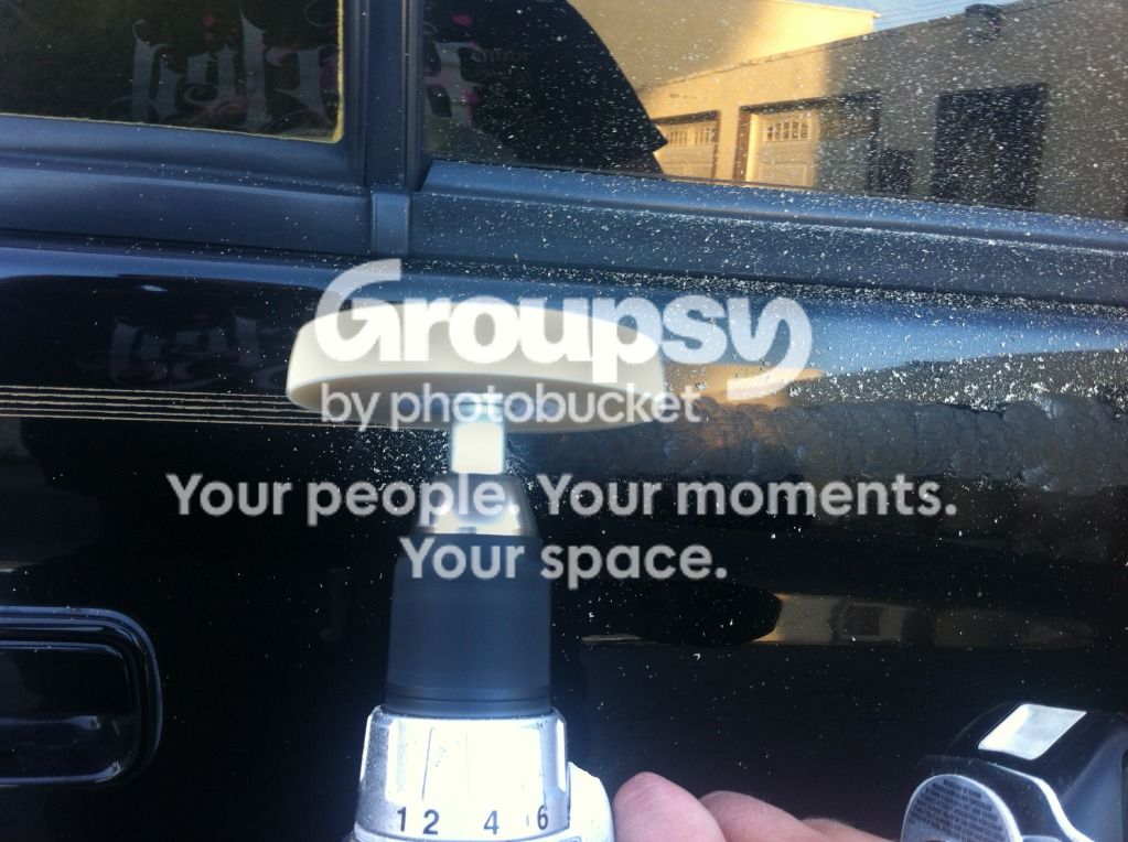

The pinstripes were faded and cracking badly, so those were first to come off!

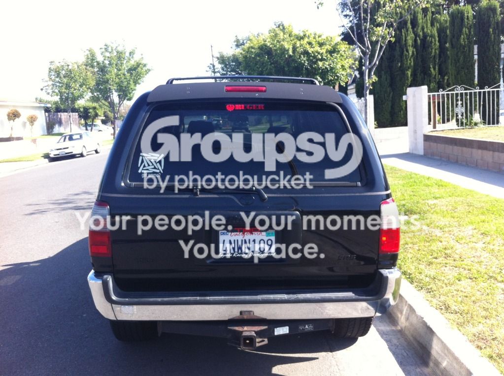

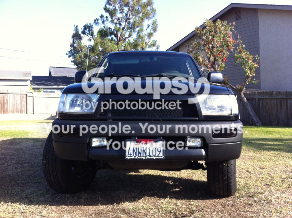

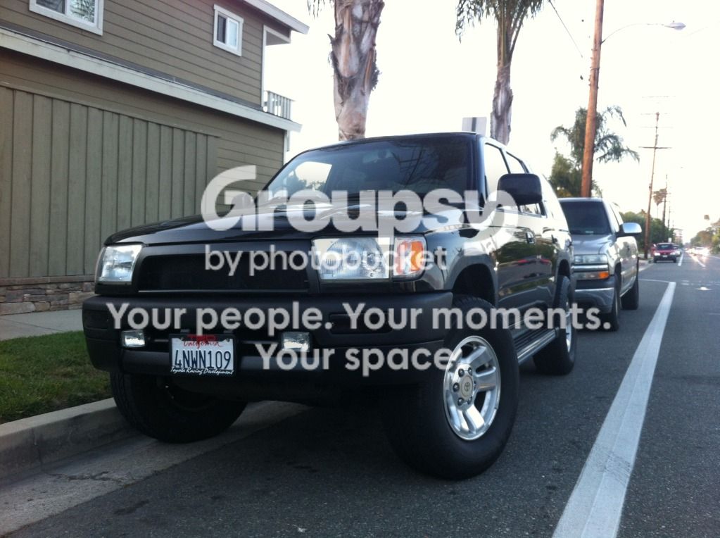

Next was to get rid of all the chrome bumpers... I think they date the car as a mid 90s SUV, and they had to go! Time for more paint!:artist: While I had the bumpers off, I also did the Satoshi grille mod!
IMG_8101.jpg~original
IMG_8104.jpg~original
IMG_8105.jpg~original
Next up is the stereo, removing the running boards, and painting the flares to match the bumpers!
Stay tuned!.....
Looking good! Love that pic showing the grill mod. Very tasteful. What did you use to paint the chrome bumper inlay / rear bumper cover?
Bumpers look sweet. What prep/paint did you use?
Same way I had done my jeep a long time ago...
Sanded with 100grit, cleaned & degreased, adhesion promoter, 4-coats of spray-on bedliner from a rattle can.
They hold up pretty well, and touchups are easy. It'll hold me over until I get an Outdoor Logic bumper down the road.:cheers:
I had those awful gold badges also, so they promptly got a coating of Plastidip.
Smart move for the future mod of taking those running boards off. One of the easiest, quickest, and cheapest (FREE!) mods you can do.
Grill looks fantastic.
Looks great man! What kind of pad/disc did you use to remove the pinstripe? I have a friend with a white '97 that has the gold striping, and he really wants it gone. :)
3M makes a wheel specifically for that job. Its called the "pinstripe removal wheel". It's literally a giant pencil eraser you attach to a drill. Spin the drill up to 3,000RPM and watch it take the stripes right off! :gun5: It's $30 on Amazon.
It leaves behind a rubbery residue, but just rub it down with a bit of cleaner wax and it comes right off. The whole truck only took me 60mins.

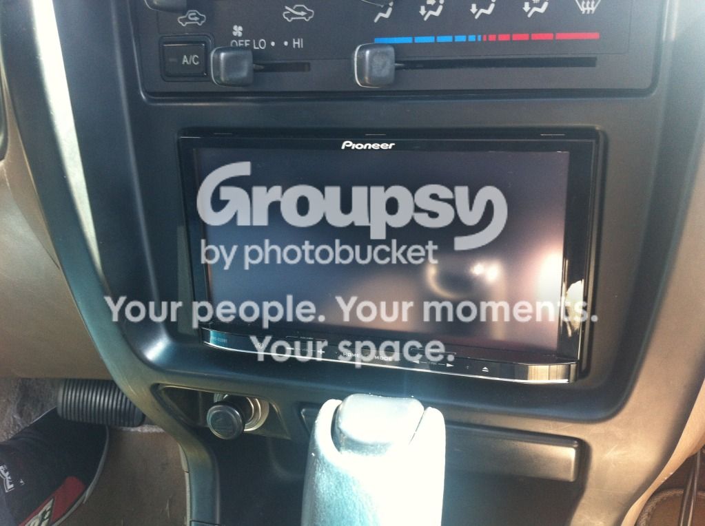

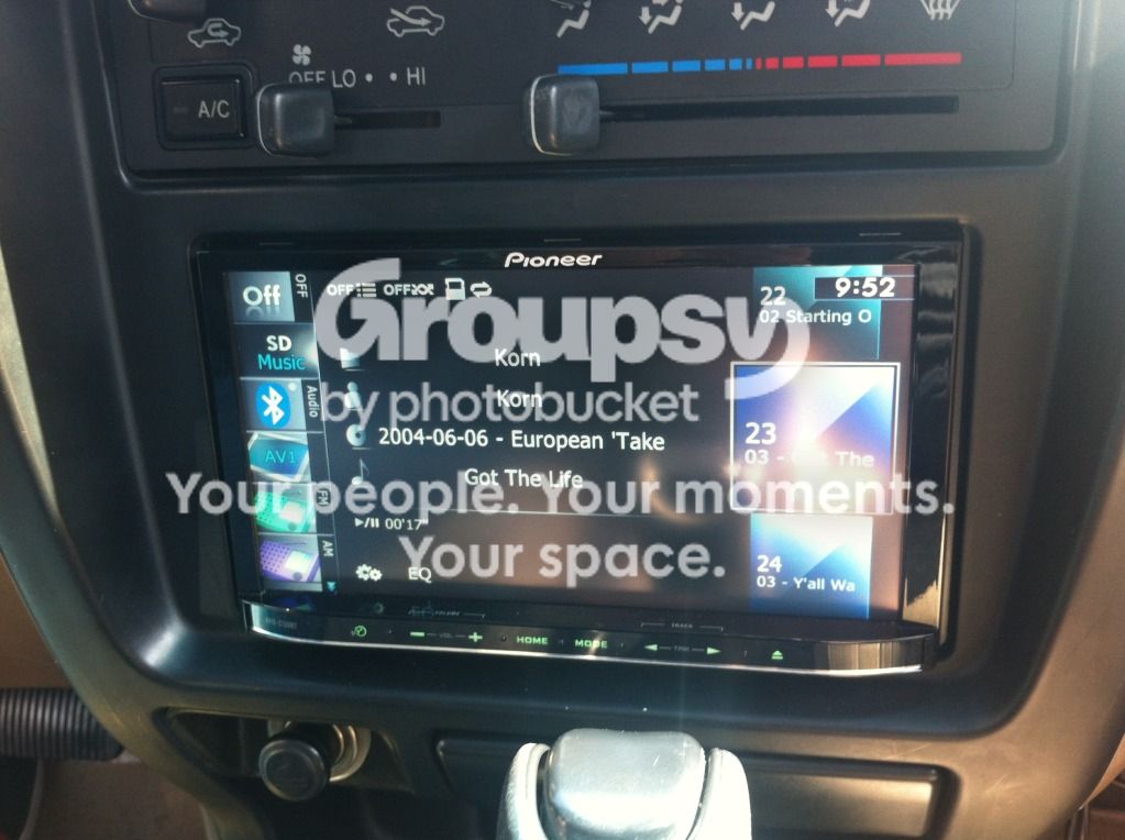

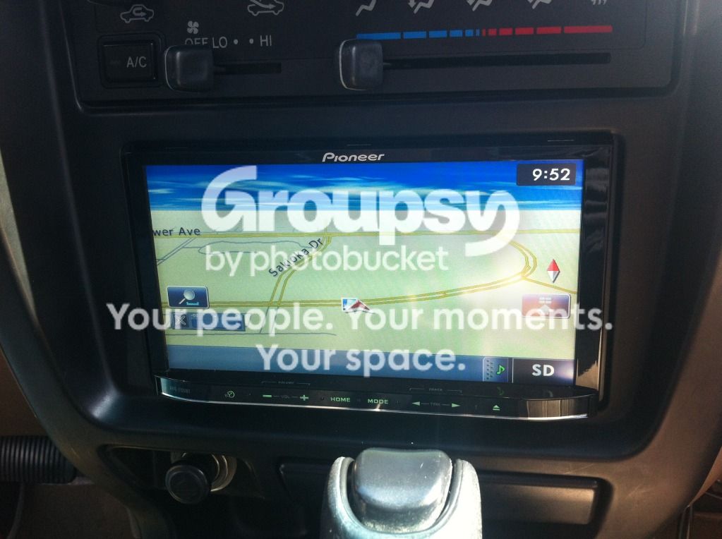

Pioneer Head Unit (DVD/NAV) hooked up:
IMG_8162.jpg~original
IMG_8165.jpg~original
IMG_8166.jpg~original
IMG_8167.jpg~original

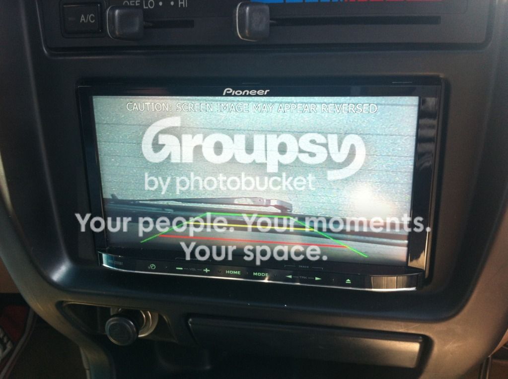

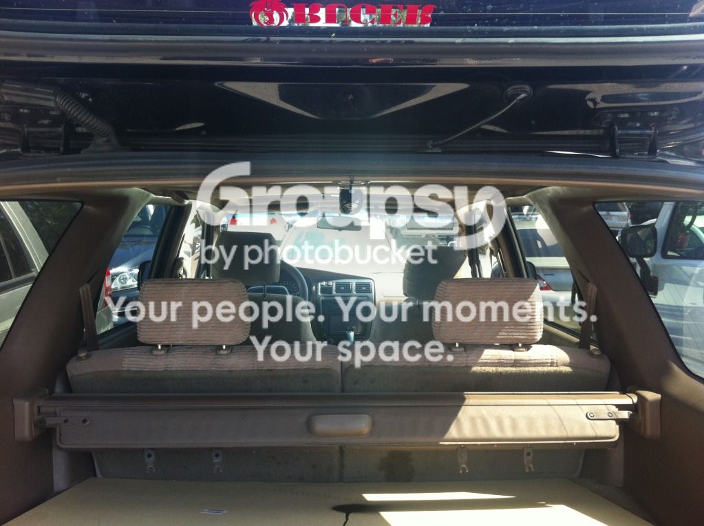

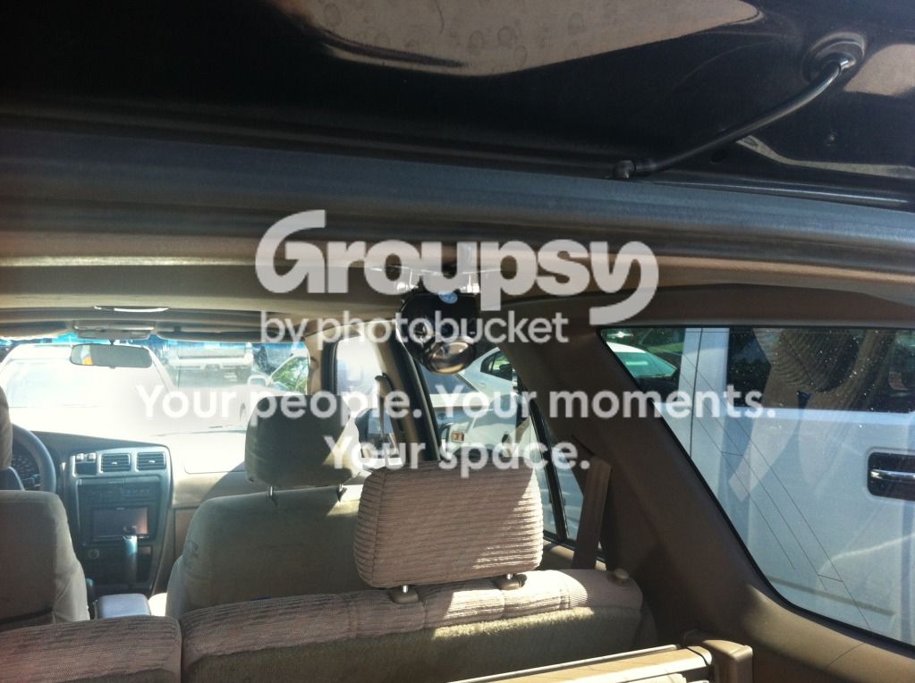

Back up Cam pointed down towards my hitch. The red line is even with my hitch when the tail gate is open:
IMG_8168.jpg~original
IMG_8169.jpg~original
IMG_8170.jpg~original

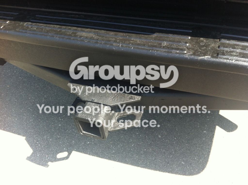

I also repainted the hitch with some rust converter rattle can stuff. Came out okay and will hold me over till I can afford a REAL bumper.

Which Pioneer is that? I'm jealous of it regardless :D
Really nice rig! I'm not the biggest fan of painting everything black, but it actually looks pretty good! I'm about to cover the entire underside of my rig with rust converter and then chassis paint - that's another mod to think about that doesn't cost much but saves you tons of money down the road...
Very nice beginning. Great taste in mods. Keep it up!
Thanks!
It's the Avic Z120BT

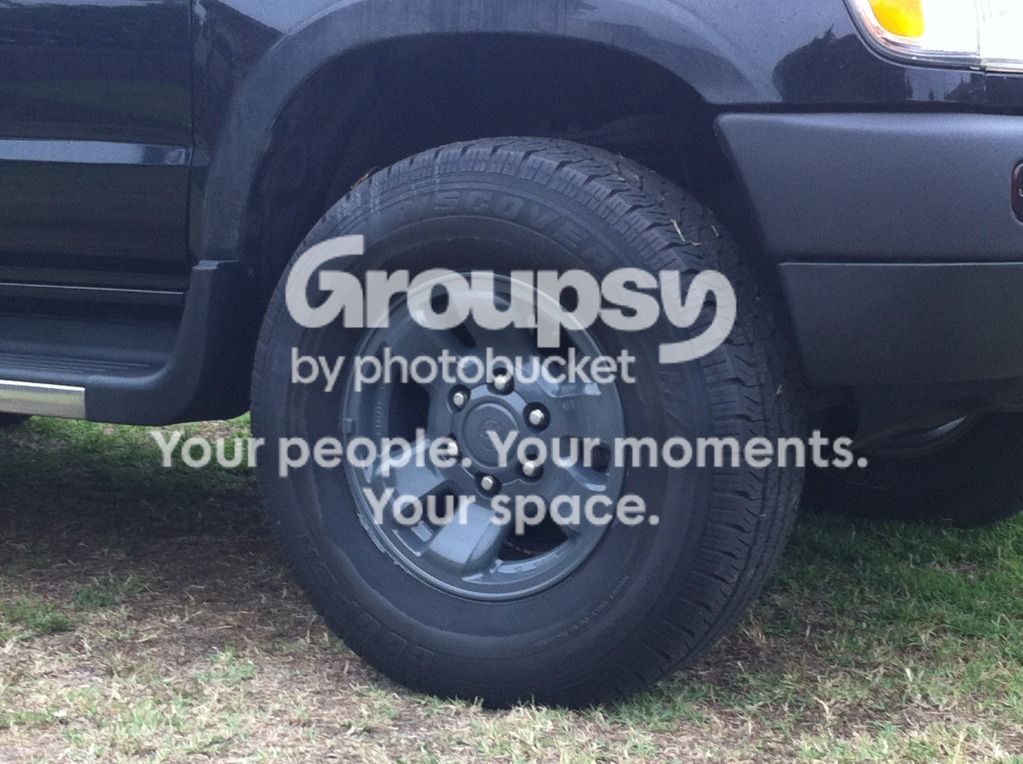

Finally got the rims done, but I'm not 100% happy with the color. It looked more metallic on the cap of the spray cans, but in reality its just a gloss graphite color. I may re-do them with something better down the road. I was pissed since my prep and spray job was one of the best I've ever done.
4RunnerRims1.jpg~original
4RunnerRims2.jpg~original
Flares are finally dry, so I may put them back on tonight if I get off work on time.
i like the wheels and have been wanting to paint mine just plain black. what method did you use to prep/paint yours? the index card way? i dont plan on having the tire removed for paint.
Yup - Index card method. I prepped them by sanding down rough/oxidized parts with 150 sand paper, cleaning, and then using 2 medium coats of primer.

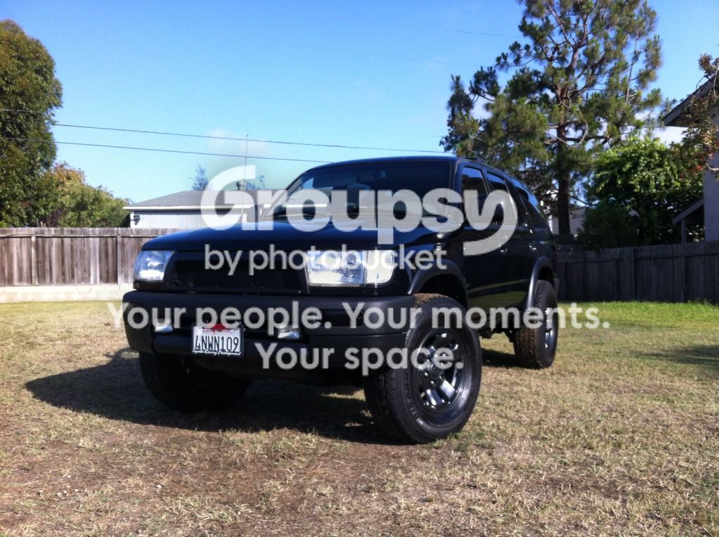

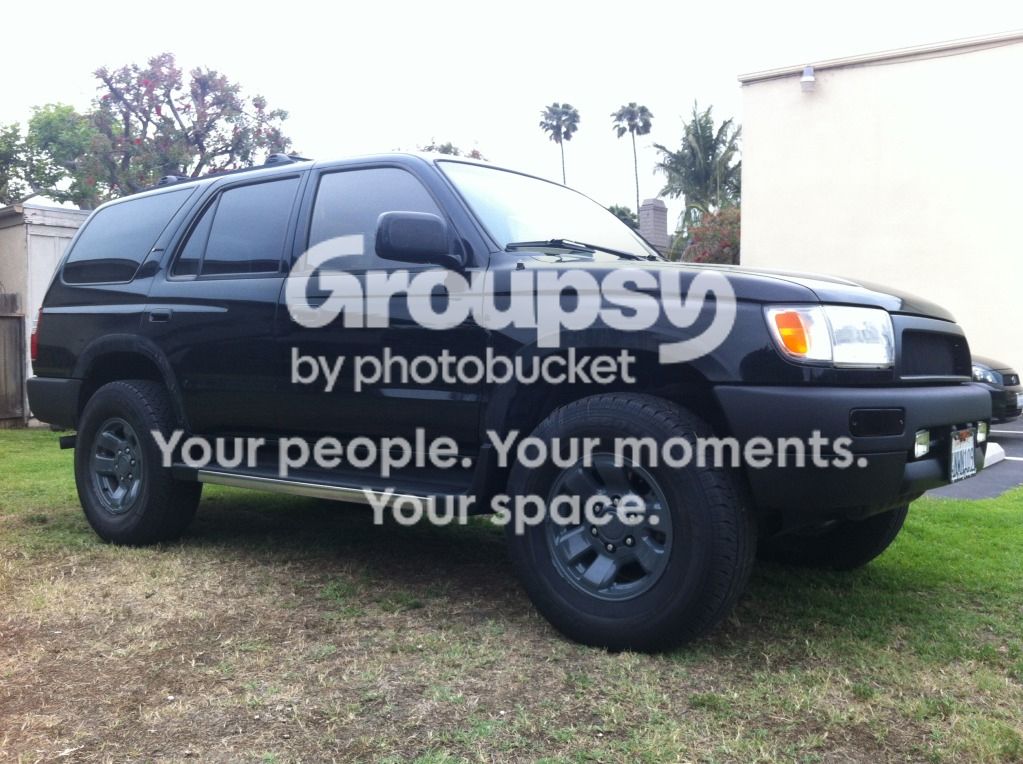

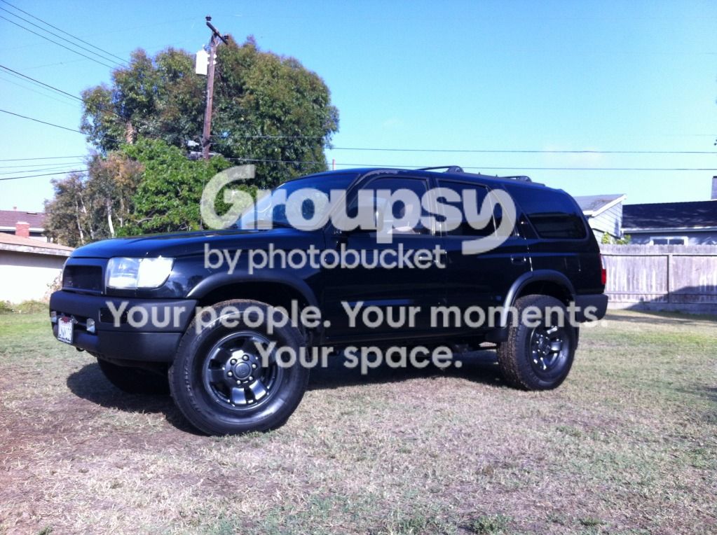

Okay... finally had some time this weekend to give the 4Runner some TLC.
Finished up the flares, and got them back on
Removed the running boards
Re-Painted the rims the Metallic Charcoal I wanted the first time
Installed 1.5" Spacers
Washed and Waxed it
Installed Clear Corners
Oil Change/Filter change/PCV Change
