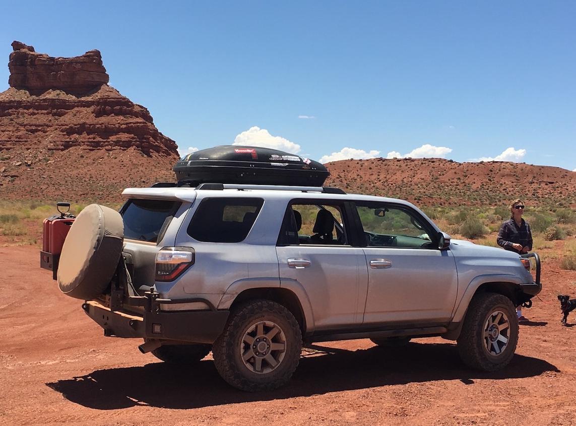

I hate you. Kidding of course but you are literally driving exactly what I want mine to look like! Looks crazy good, what winch did you use in the bumper?

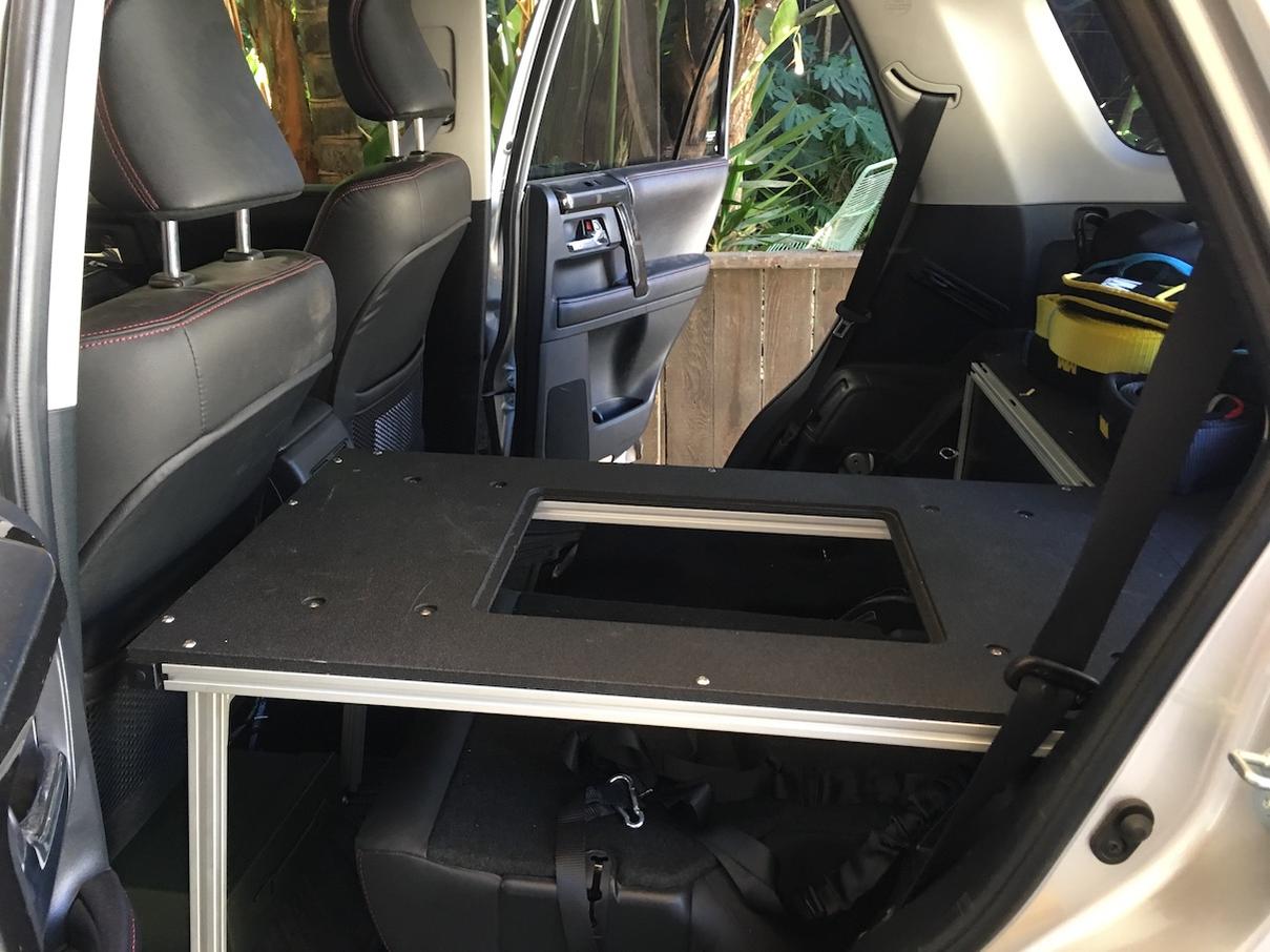

How permanent is the sleeping platform? I'd love to be able to pull something like that off but it doesn't look the easiest to remove in order to use the rear seats for passengers.

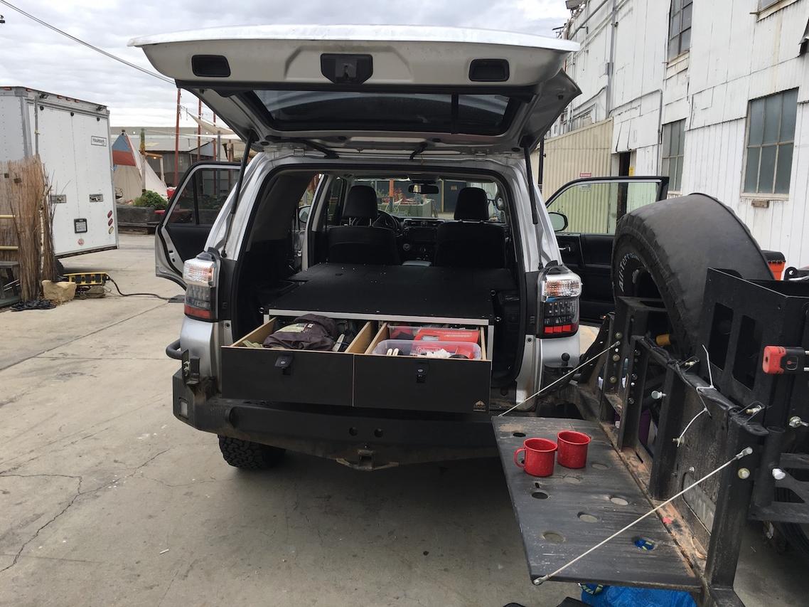

Dare I ask for a ball park figure on that drawer set up? 2k?
Oh man. It wasn't cheap. Just the drawers run a couple grand, but then I kept having them do little tweeks to them make them more suited to my needs, like adding another layer on top with line-x coating and eye-bolts for strapping things down.
And they had never built a sleeping platform like this before, so it definitely took some time and lots of thinking. But I'm really happy with it.

It's a Smitty Built -- but I've never had to use it. Really eager to though.

I'm happy to help you out with all the data you need. Just tell me what you're looking for and I'll get you the data. Honestly though, it was great building this with the Goose Gear geniuses because the have a full top-end workshop at their disposal. So all of the pieces are fabricated on a CNC machine. Not to say it can't be done with some deft table and jig saw work, but definitely a little more challenging.

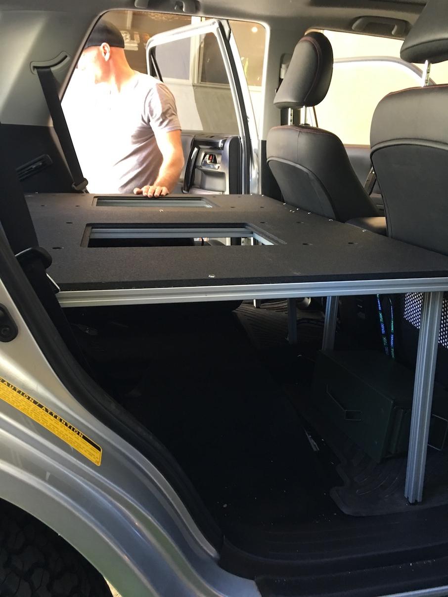

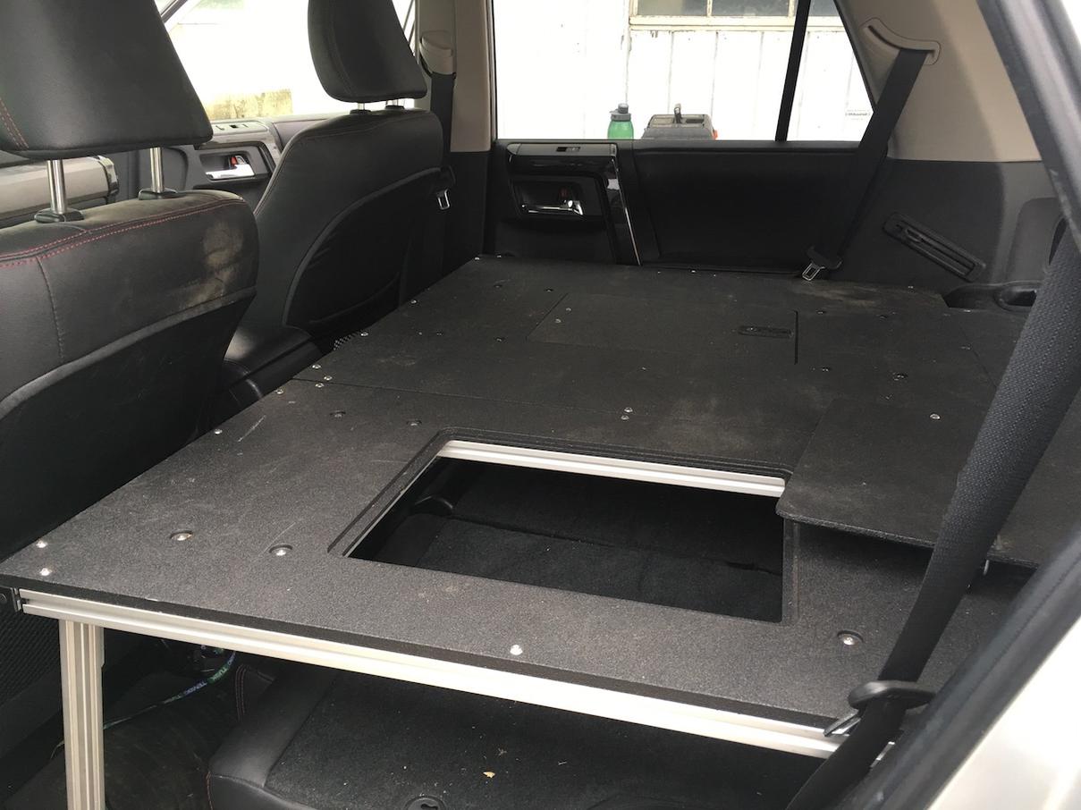

We designed it such that the platform can be removed super easily. It's a couple of Allen screws in the back connected to the rear of the drawer box, a single quick release bolt in front connecting the two sides of the platform, and a single strap for each of the two sides of the platform. The platform is cut 60/40, so that either the 2 person or the 1-person side of the back seat could be left up and the other part of the platform used.

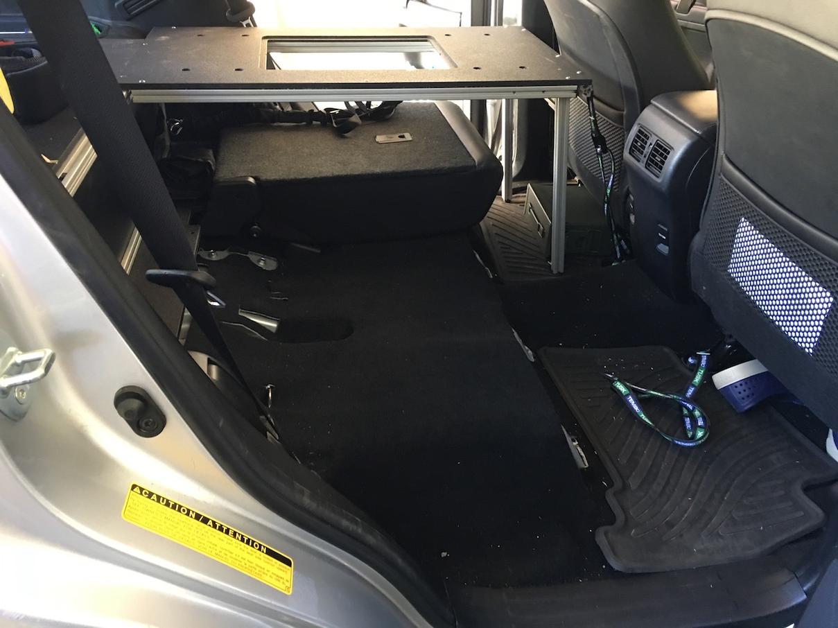

I, however, just took out the two person seat from on the passenger side of the ride, since really I never have more that just one, maybe two people in there with me. Now I have an incredible amount of storage underneath the platform that can be accessed from the side or through the portholes on top. Removing the back seat took about five minutes.
For my lifestyle this quite perfect. I can put all of the light gear/clothes in the sky box on top of the car, while putting the heavier stuff, like climbing gear and water/food, down and center in the ride under the platform.

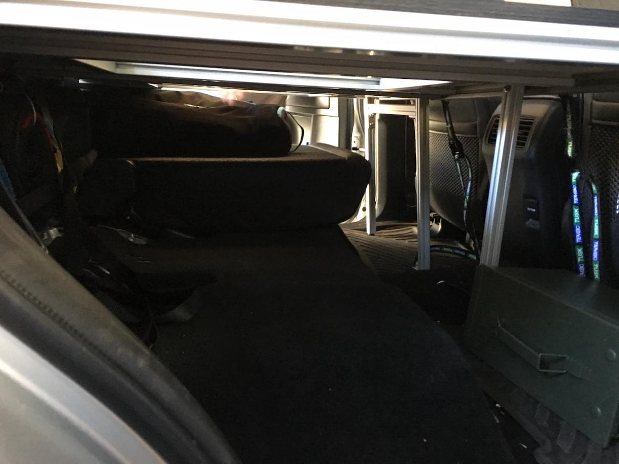

Here a couple pics with the passenger side of the back seat removed -- so much storage.

I probably wouldn't do the sleeping platform -- not the same at least. Largely because I now have a roof top tent and never sleep inside the rig anymore. Also, when you have it set up, you can't really lean back the front seats, which is more of an issue for my wife on road trips with me -- but that's a pretty big issue.
I got the 10" drawers, figured I'd maximize and have them about as high as the wheel wells. Frankly, lower might be better, largely because I now also have a refrigerator back there, and my view out the rear is shot. [But I now have a switch that allows me to turn on the rear view camera whenever I want, so I figured that out.] So I guess the 10" drawers are great -- I have a lot of gear in one and my camp kitchen in the other. I really like the drawers.
Both of these though could go the other way. Sleeping platform was great before RTT. However, in that case, I'd definitely would have gone with lower for more hear room.
If I never had anyone in the passenger seat, the sleeping platform would be great. Largely because it allows for a couple discreet layers of gear storage. Especially when I took out the rear seats, which was super easy and suddenly allowed for so much storage. I still used the platform when one of my buddies is coming camping/climbing/wheeling with me and we will be making fast tracks and don't want to be messing with tents. I sleep in the RTT and he sleeps on the platform. Given how easy the platform is to take in and out -- it's not really a problem. Perhaps making it a little shorter to allow for the front seat to lean back more would have been better.
