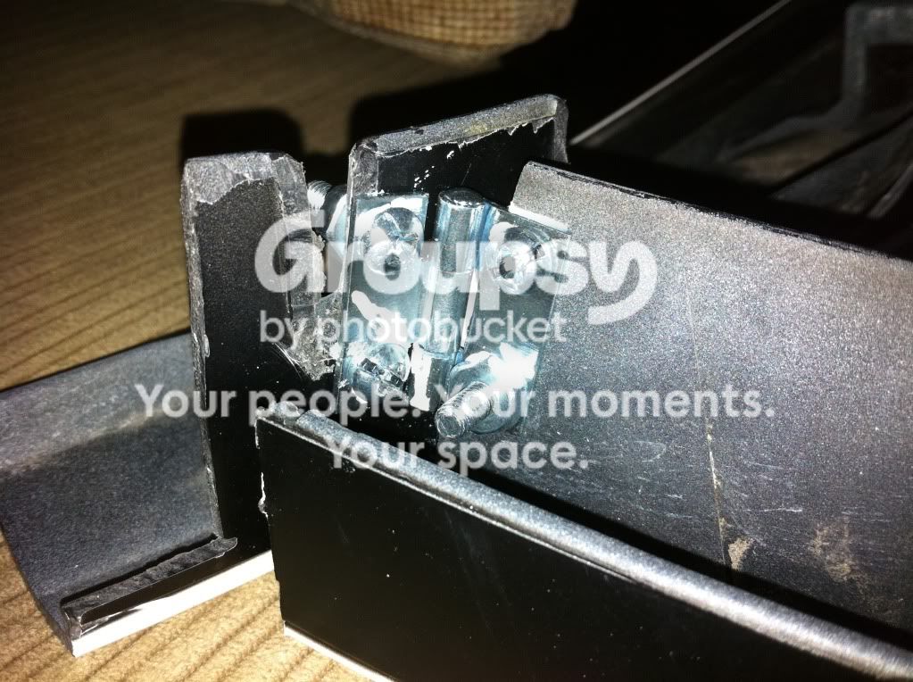

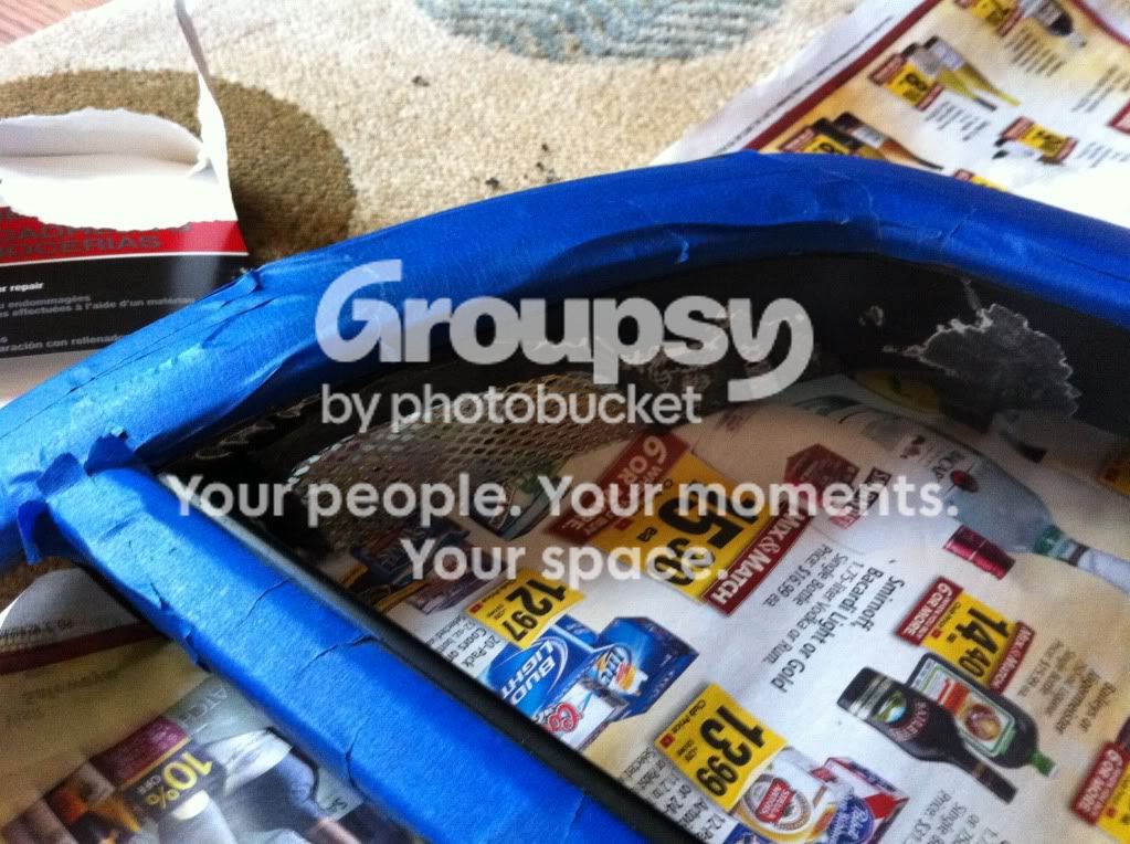

I did this. Honestly the triangle gap looked good to me with the old grill. The 06+ grill will require serious modification regardless of the option you choose. I redid 2 grills when I had my 04. The first one requires trimming about 3/4" from the bottom bar of the grill, and removing the black trim on the bumper and cutting away some of the brackets on the bumper itself so it could close. I was able to retain the holes on the bumper for the trim piece so when I traded in my 04, I could slap the old grill and trim back on and it didn't look any different.
The second grill I made was a satoshi. I cut the bottom of the grill off and cut the sides down to where it could fit on the car, again with the black trim piece removed, or cut, I can't remember. Cut out the guts of the grill and then reattached the bottom grill bar with some hinges and bondo. This method would look very off balance if you were rataining the center parts of the grill.
Here are some pics. First are of the Satoshi, I'm bummed I can't find any pics from the complete version, because it was awesome. Second few are of the first grill project.
