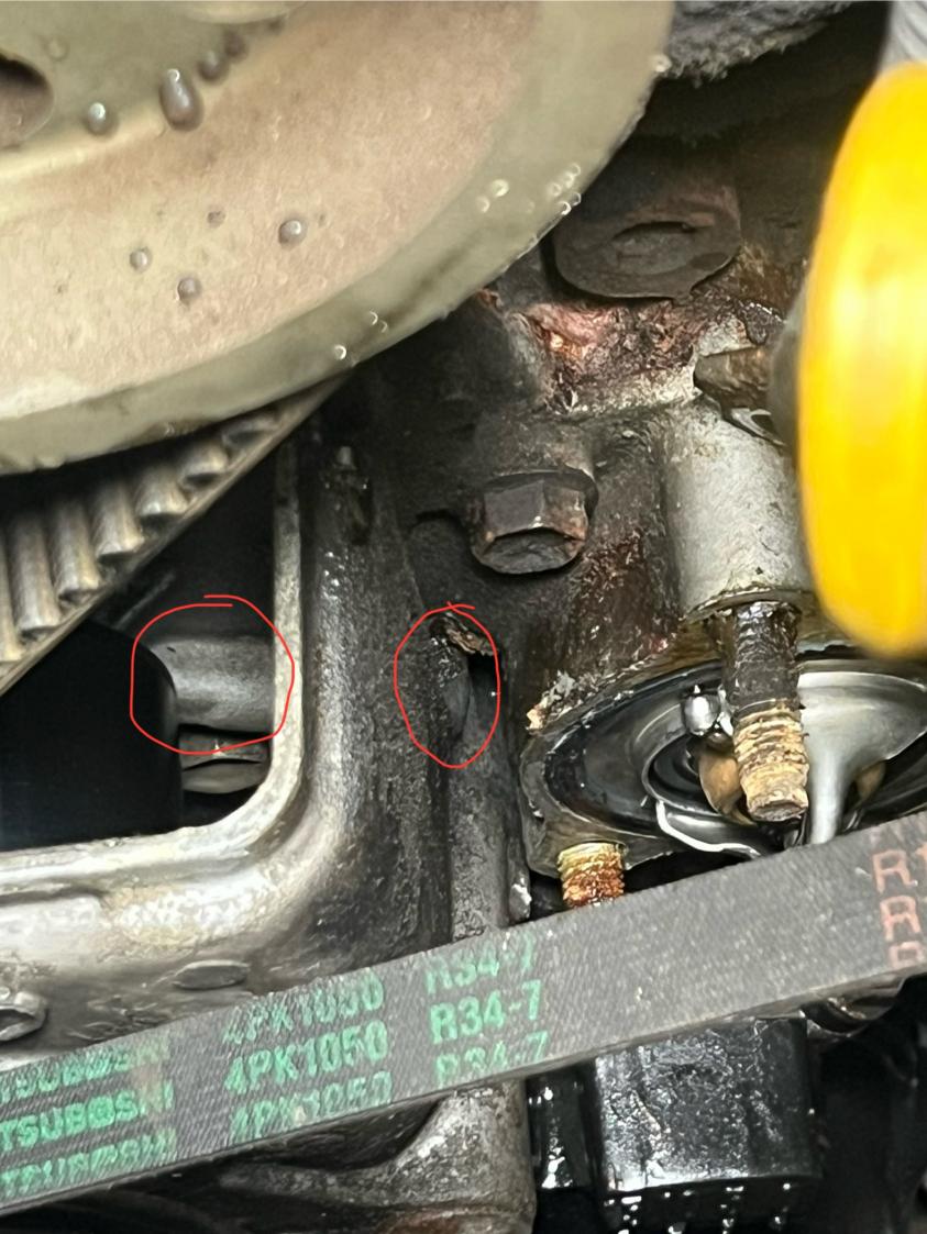

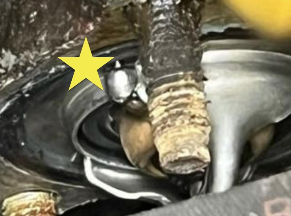

Hey everyone, sorry I know this is an old thread but I’m having a problem that may be similar to what was described in this thread.
I have a bad coolant leak, soon as I put in fluid it starts dripping/pissing out. Started slow but couldn’t find where it was coming from till I finally took it to a friends shop yesterday.
I found the leak, but I have no idea how to fix it. I initially thought it was leaking from the thermostat housing.. If you’re looking into the engine compartment from the front of the truck, the leak is to the left of the thermostat housing. I will attach pics, but after I took of the timing belt cover, I could see a “channel” of some sort (not sure if channel is the right word) that leads to a “lip” where the water drips out of. I will attach pics with the channel and lip circled. If anybody knows what this is and what the solution may be, I would greatly appreciate it. I blew into the overflow hose to pressurize the system, and there was definitely a leak coming out of the lip. It had already been leaking there but this made it obvious. Originally I thought it was coming out of the thermostat housing, but I believe it was just dripping down from the lip to the housing.

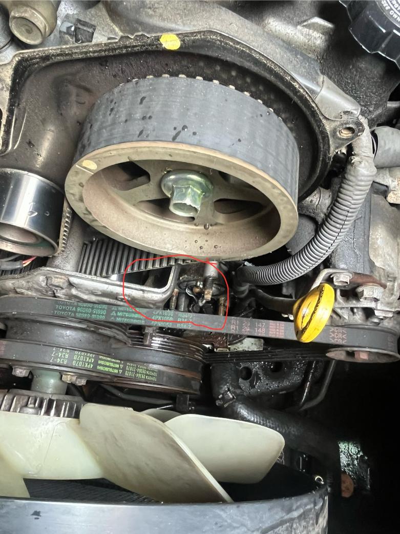

First attached image- “channel” circled on left, “lip” circled on right. Thermostat housing and timing belt covers are removed.
Second attached image- zoomed out photo, circled the area that first photo is focused on.
Hopefully this all made some sort of sense, I can clarify anything if that’d help. I’m not sure what that channel is and can’t get in to see what the lip is or if there’s any way to seal it up. Not sure if I’m missing a plug or if there is a crack? Any input would be GREATLY appreciated.
Also I’m new here and not sure where to be posting, I also tried the sticky “3rd gen all questions allowed here thread,” hope that’s okay. Thank you in advance for any help!!!!

Isn't that the water pump? If it is, that is a deliberate weep hole that they add so that when the water pump fails it wont drip onto the timing belt. Which means you need to replace your water pump asap.
I could be wrong, I don't have that engine, but it does look like it is coming off the water pump
I think you are right. The thermostat housing is connected to the water pump. I would replace water pump and thermostat housing
Thanks guys, you’re right it’s the water pump. Posted something on reddit too, thought I had notifications going to my email for T4R.org but for some reason didn’t work.
Ended up ordering an ‘Aisin’ water pump/timing belt kit on amazon for around $200. Heard that’s a decent brand? Local NAPA had quoted 470 for a kit, not sure on brand
Now that I know that’s the weep hole for water pump, I’m pretty sure it’s been leaking from there the whole time… not the thermostat housing. It’s just tough to locate that leak when it’s barely seeping out… by the time it gets to the ground it’s all over a lot of crap!

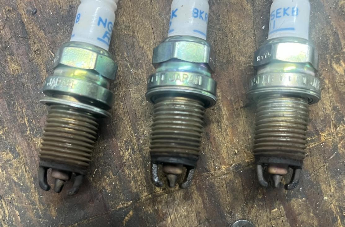

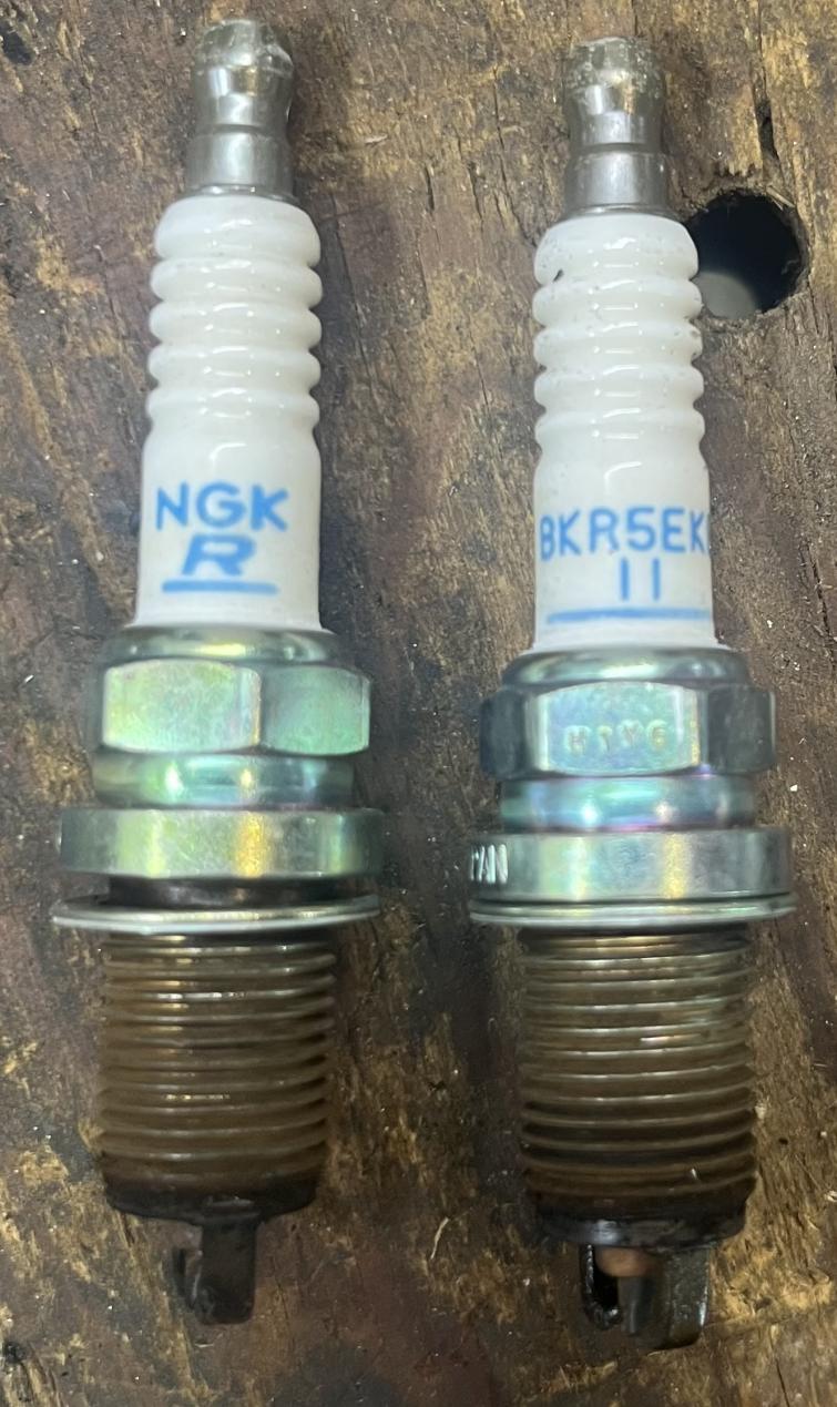

Awesome, pulling plugs now as we speak. So would you just continue as planned even though I can’t rotate the crank shaft a full 360 degrees? It seems like something has to be up.. but I triple checked all 4 of the spots I know of to check timing and they’re all spot on. Thanks for the help btw I really appreciate it.
Edit: Also, my account finally is old enough or whatever to post my own thread .. I’ll link to it here, I posted kind of an updated summary if it’d help at all. Thanks again
Problem While Replacing Water Pump / Timing Belt
Mike
Edit: got the plugs out, adding pics
