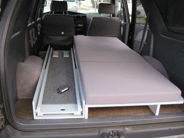

Here is the one I built: http://www.toyota-4runner.org/3rd-gen-t4rs/204882-sleeping-platform-single-person.html#post2109464
