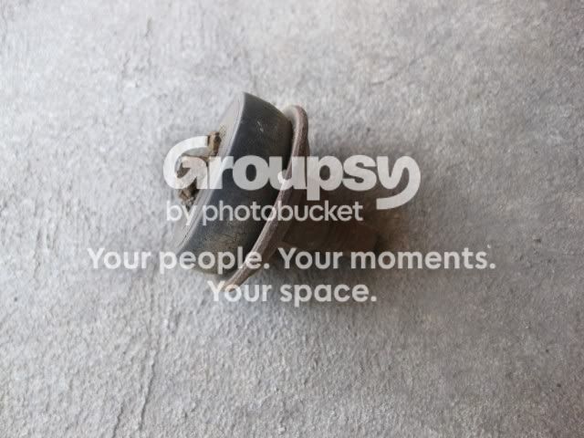

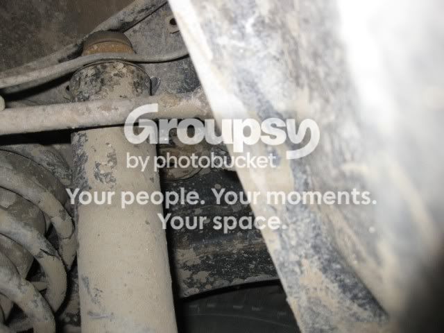

Check your rear shocks. I had a bad clanking noise this past weekend and sourced it to a left rear shock piston that snapped near the screw down nut (top of the shock piston), effectively dismounting the shock from its designed location.
Real fun going down that trail...

That's exactly what happened to mine RAB! Good call.
