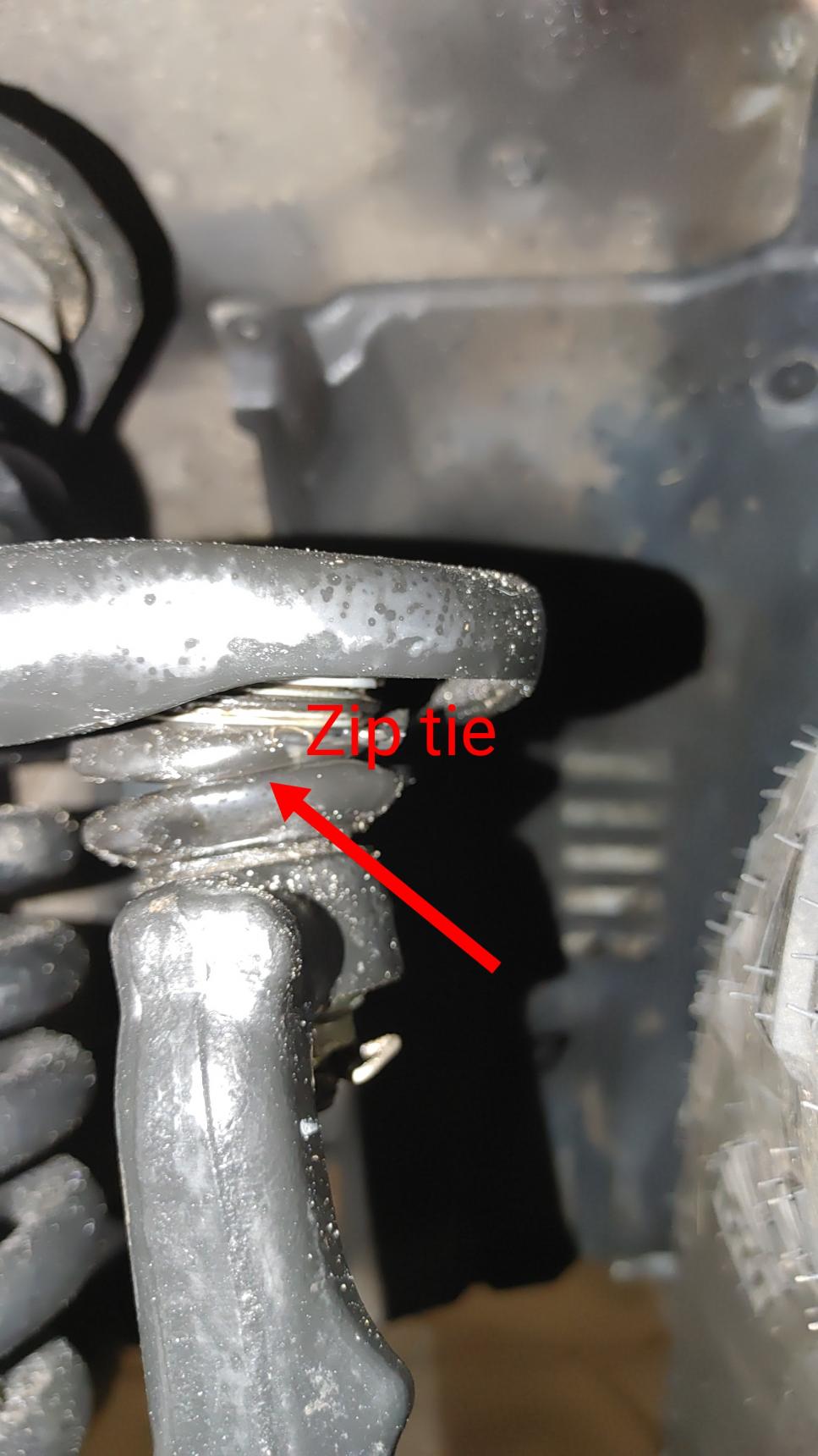

Think this will hold until my new boot comes in (2 weeks)?
Ctrulock
My upper ball joint boot slipped down. There is good grease in the lower part of the boot I zip tied. Until the part comes in do you think I'll be OK?
With the boot slipped down on the upper ball joint, I'm not sure the zip tie will do much more than retain what grease that remains in the boot and minimize clean-up mess.
Perhaps do a ball joint check for peace of mind. That should give you a good idea as to go/no-go.
