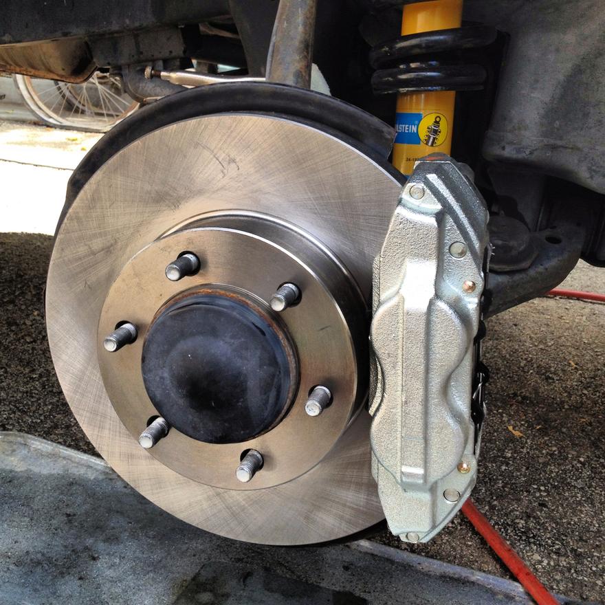

Back in Summer 2013, we started thinking about getting a trailer as an alternative for camping to my converted '73 Kurbmaster box truck. What a great idea that turned out be. In October of 2013 I upgraded our tired stock shocks to Bilsteins and did the Tundra 231mm brake upgrade. Soon after we found our slightly used (2 year old) 177 HRE rPod.

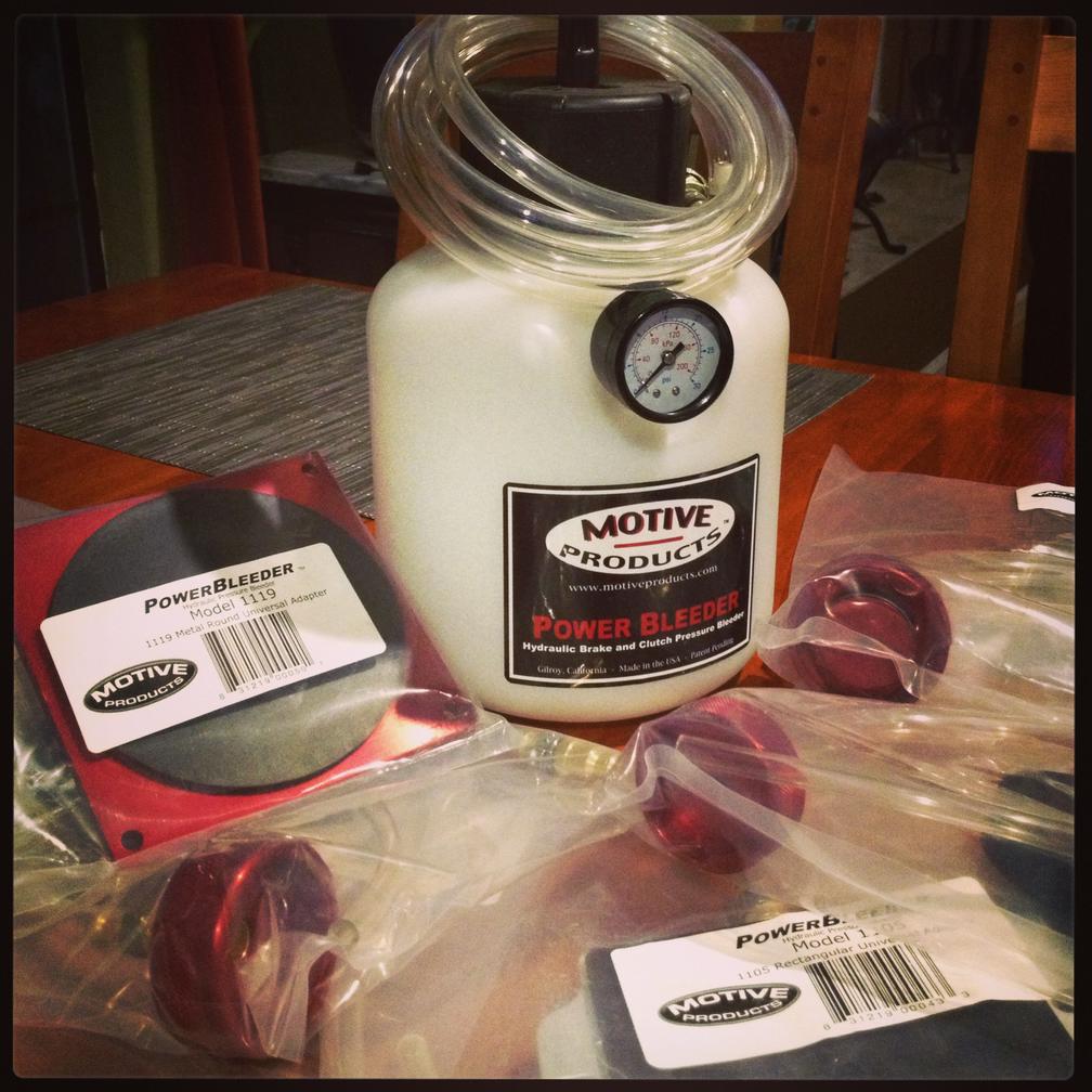

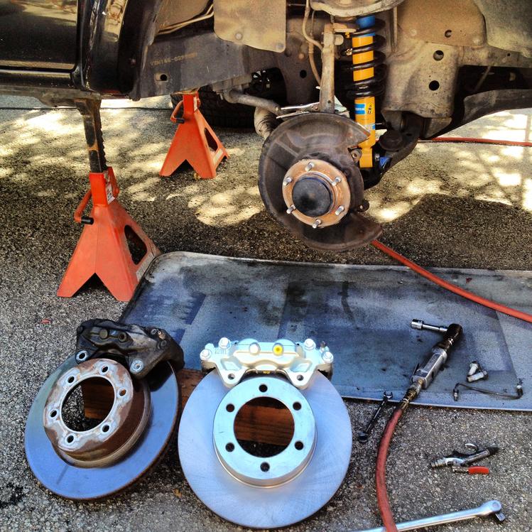

Working on our vehicles has always been a great rationale for investing in tools. While I don't use the Power Bleeder much, when I have it's been indispensable. When doing the brake conversion, I installed new shoes in the rear and bled the hydraulic system. The Power Bleeder sure makes short work of that job.

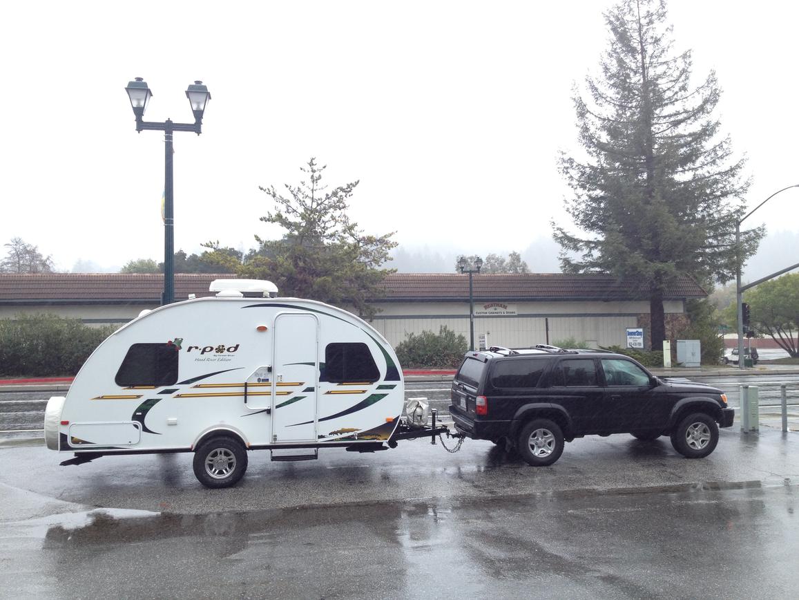

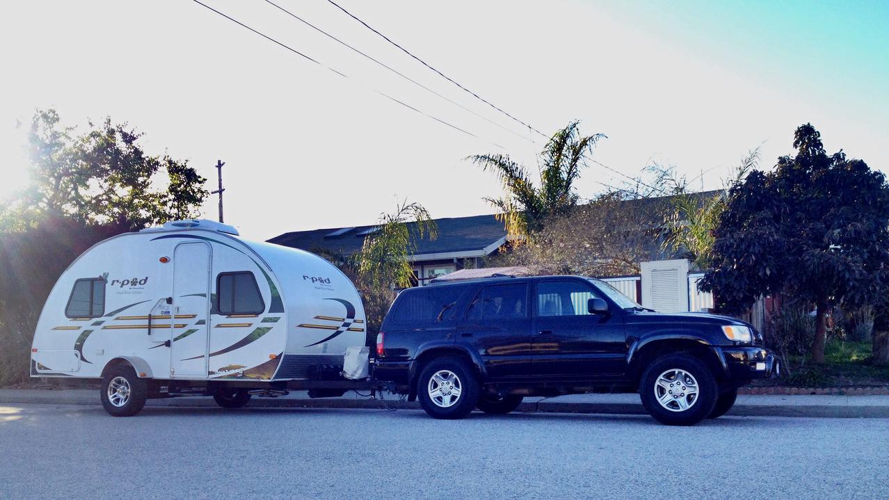

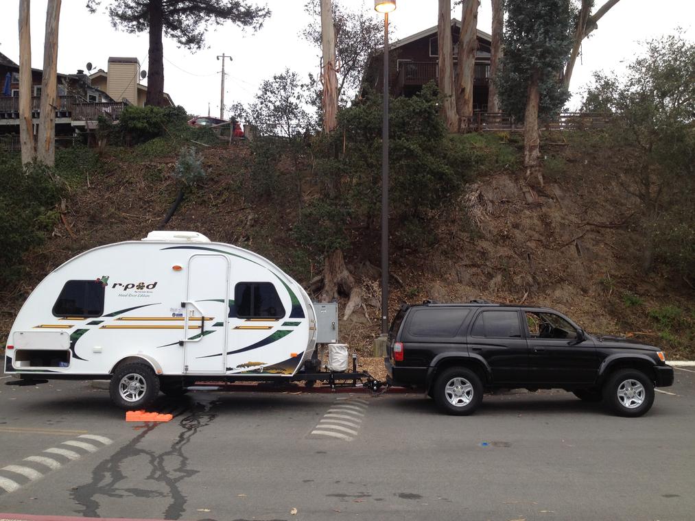

The most day to day useful mod for towing a camper trailer with our 4runner was installing Air Lift 1000 air bags in the stock rear springs. Here are three staged pictures to show 1. The stock springs sagging under load with a tongue weight of around 350 pounds. 2. After the Air Lift bags were installed and 3. With Air Lifts and a Fastway E2 Wright Distribution Hitch to lock the trailer's tongue and the truck's chassis into a relatively rigid single structure.
With the WDH and the Air Lifts, I can add pressure (typically under 25 psi) to tune the front/rear height of the 4runner to level it out, even when sporting a fully loaded truck and wet trailer.

We love the trailer. BTW, it's not a fifth wheel. :) Originally I wanted to buy a large RV, then we started looking at Airstreams, but would have needed to upgrade to a bigger tow vehicle to get the water storage, waste water storage and ammenities we were looking for. Turns out Airstreams are really heavy for their interior square footage and length. When we found out about rPods, they seemed the exact right solution.
They weigh under 4000 pounds. They carry 50 gallins of fresh water, with 30 gallon black and 30 gallon grey waste tanks. The Hood River Edition (HRE) version has a 4" frame lift for clearance. Ours has a slide out for the kitchen which opens up space; it also has a 3 fuel frudge unit. We also have a toilet and shower (wet bath) and trailer is equipped with a "queen sized" bed, AC, heat, a small dining area and under body storage. Plus at 6'4", I can actually stand up in it. I put in a marine inverter and we run a pair of 6 volt deep cycle batteries for 12V DC. All this in a trailer that's under 24 feet from ball to bumper.

Mentioned a few posts above... I am running Air Lift 1000 airbags in the stock coils. The benefit from my POV to using stock coils and bags? 1. Our Sport rear coils were not sagging and simply upgrading to Bilstein shocks gave it a really subtle comfortable ride. 2. The airbags with stock springs effectively give it a dual rate spring with the top being the soft stock spring rate, and the bags providing a much firmer variable spring rate under load, and adding pressure to the bags also slightly lengthens them reducing the portion of the spring that's the softer rate. I really dig the airbags. Next mod will be to convert them to individual feed lines, rather than a T.
If there were a slightly firmer spring set with relatively stock travel height I wouldn't mind swapping those in with the bags. But I like the comfort of the stock spring rate around town.

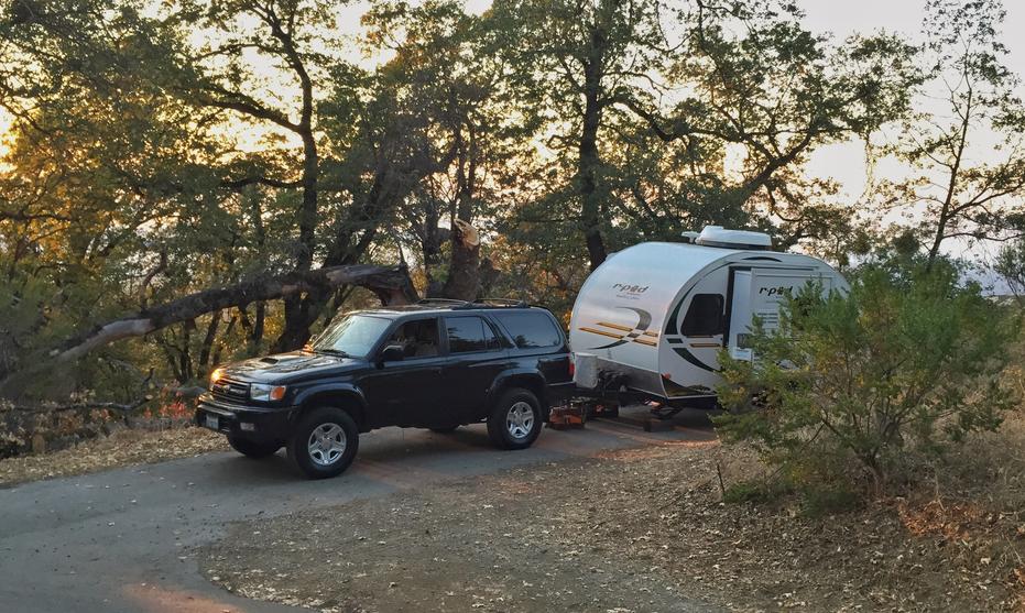

Why do we love glamping so much? The new backyard. The quiet. And the food. Eggs from our chickens, and bacon bloody marys on Fremont Peak, above Hollister Hills.

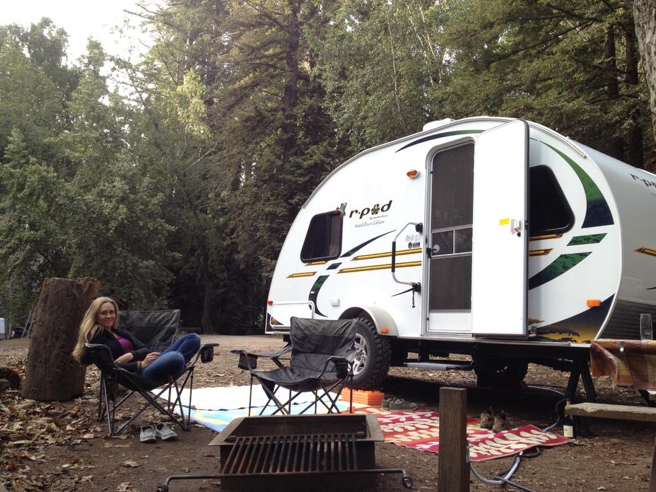

More glamping. More truck. Big sur, right on the river, for Valentines Day weekend getaway.
