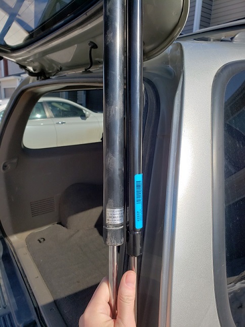

Today I replaced the lift supports on my 4runner's tailgate.
I ordered the aftermarket Strongarm replacements. They went in fairly easily, but I lost one of the e clips, so I had to run to Napa to get a new one.
The aftermarket supports are def thinner than the KYB stockers. We will see where they are in a year or two.
But right now they have no problem holding up the tailgate! :tea:
Looks like you went with the heavy duty ones. These things are great man. I just installed a set in December and I love them. They are phenomenal. The hatch pops right up with just a little pull. I have to stand back from it just to make sure I don't knock my own teeth out.

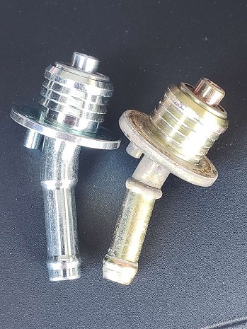

During some of the cold nights (below 20f) the 4runner has no brakes. The pedal is hard and the truck wont stop.
But usually pulling the parking brake or pumping the brakes restores full breaking. Feels like a vacuum issue. With a bit of research I saw people having a problem similar to mine that was fixed by replacing the brake booster vacuum valve. So that's what I did!
Current miles: 259153
New valve on the left.

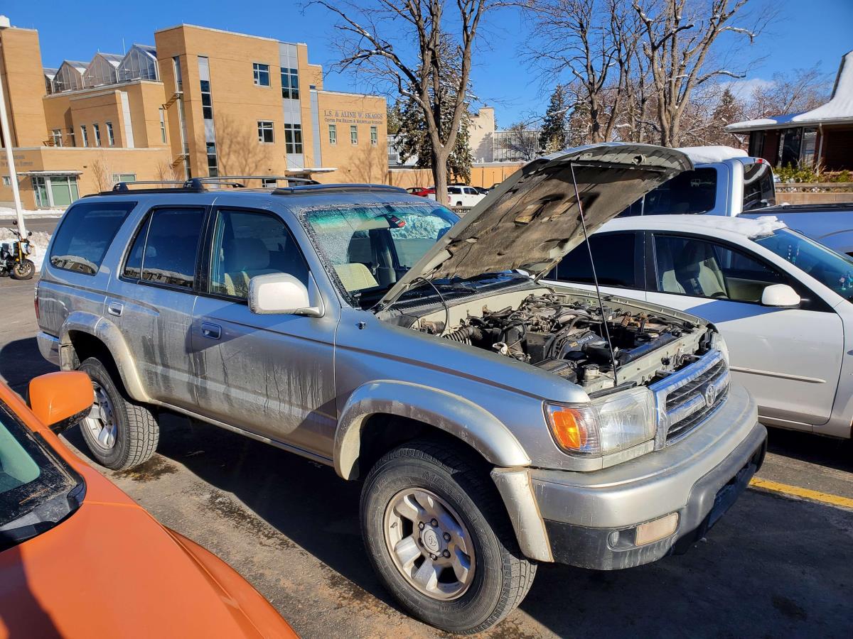

A sad day.
Today my 4runner let me down. It started fine this morning, drove me to where I needed to go, but when I came out a few hours later, it wouldnt start.
Sounds like its not getting spark? I can smell gas when I crank it.
Oh well. It's being towed to the mechanic.
I went out to check on it since the tow was taking way long, and it started! I first tried at 9am, then at 1pm it started and ran fine.
I drove it to the mechanic, he is going to drive it for a few days and see how it behaves. But when he checked it today he wasn't able to find any codes, weird fuel pressures issue, or anything else.
:shrug:
Mechanic was able to reproduce the issue, it was infact the fuel pump!
OEM parts ordered.
