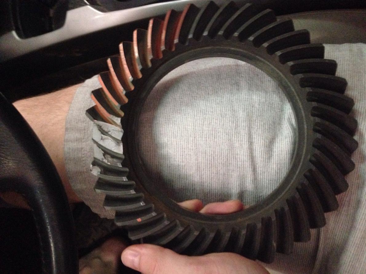

My buddy told me about a differential speciality shop in town that has great reviews so I decided to have it towed there and I'll let them figure out what's wrong. If it wasn't my DD I would attempt the repair but I need it back in working order as soon as possible. Crossing my fingers it is something minor haha.
Just got a call from the shop---broke some teeth on the ring gear. Looking at around $850 out the door.
So $900 later and I have this nice paper weight.
