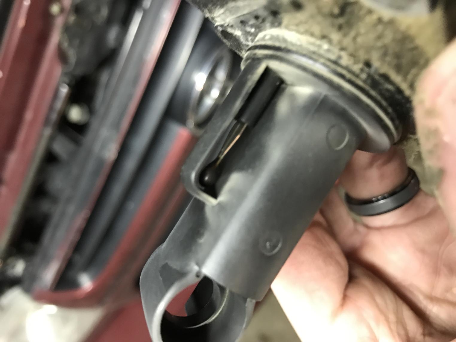

I've been getting around 10mpg lately. Part of that is the use of 4WD and idling to warm up before driving, but it cannot be that bad for just that reason. Before it got cold and started snowing, I was still only getting 13 mpg. With newer plugs/wires I thought the MAF had to be filthy. Well, I guess that's not the reason with how clean it is. Back to the drawing board.

I was expecting the hot wire to be filthy, and as you can see it's clean. I was just hoping for an easy scapegoat.

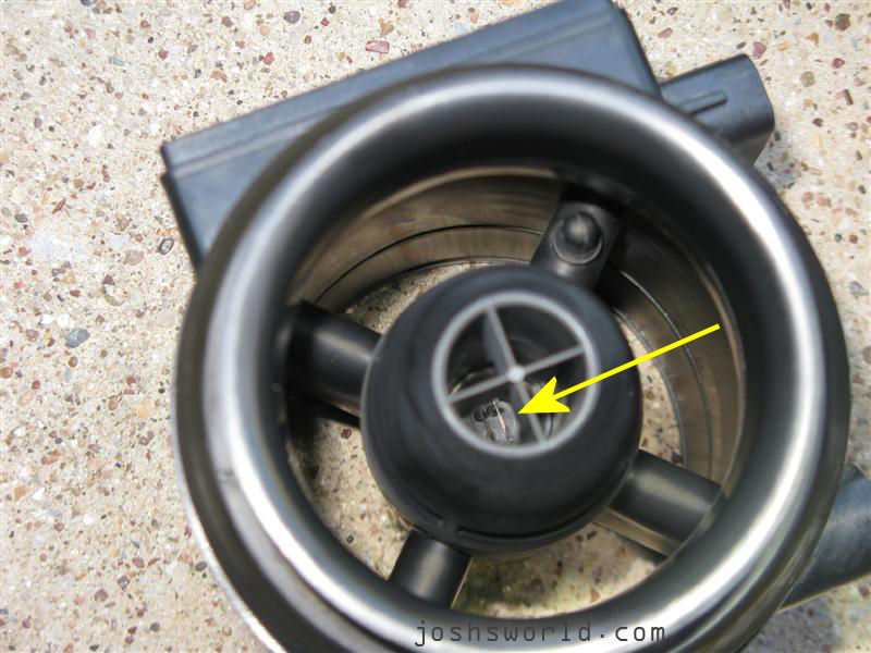

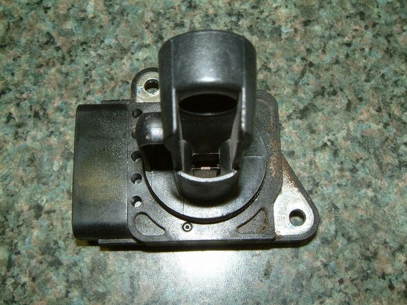

You need the clean the little wires down inside. Here's both 96-98 and 99-02 styles.
Thank you! I appreciate it. I'll pull it back off and get these. I got everything pretty good but honestly completely forgot about these.
