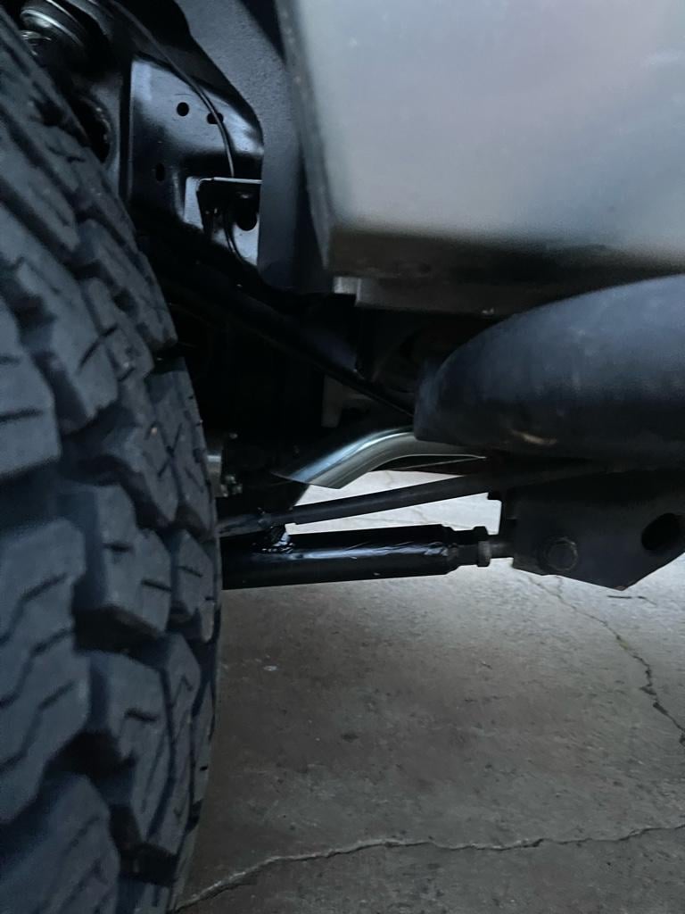

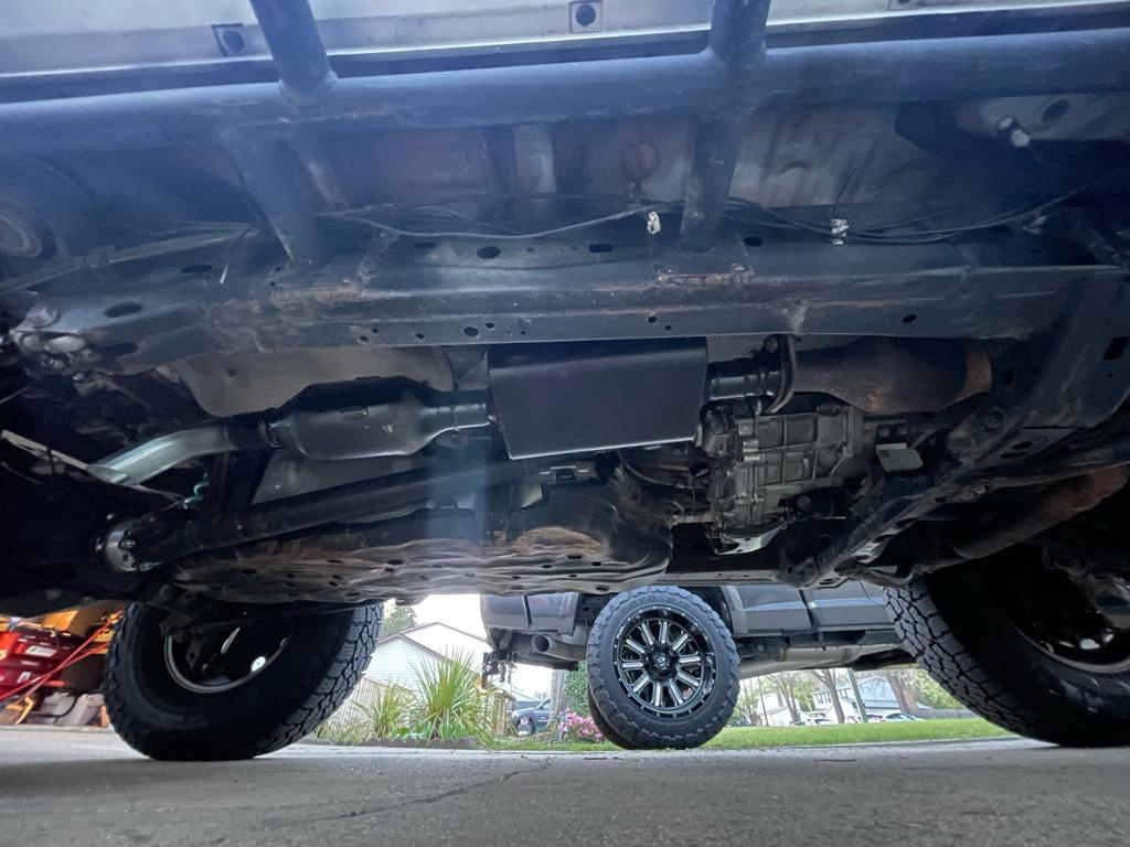

Mine is now before the muffler and after the y-pipe merge. Had a shop weld it basically between the two exhaust hangers.. I did it on a Gibson side exits exhaust and it's quieter than stock now. I did do a 1/4 wave drone-delete, but I'd bet the resonator and stock muffler will probably be fine alone since there's no drone on the factory system.

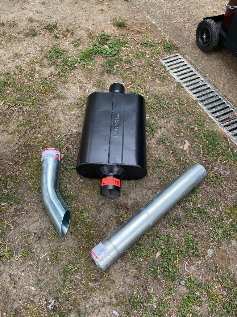

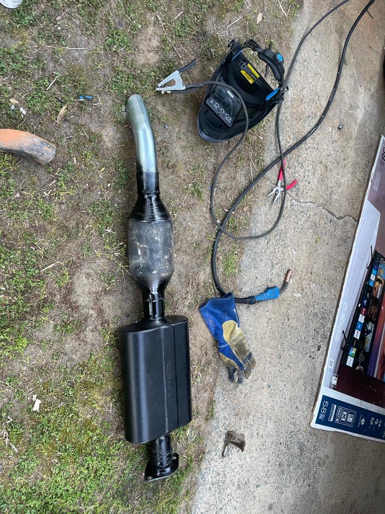

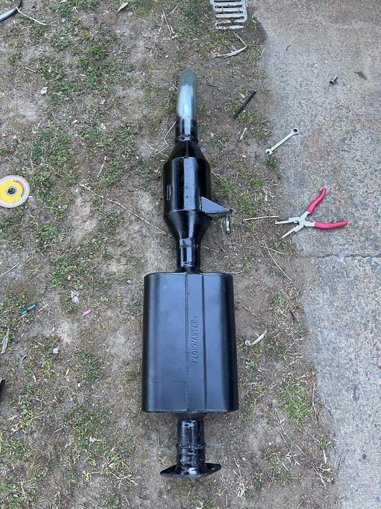

This is the route I went.. a bit backwards from a resonator delete.. I actually did a muffler delete at first and left just the resonator, it was too raspy at full throttle being a V8. Recently what I did was buy a flowmaster exhaust, chopped it way back just past the Y-pipe, and built the muffler/resonator combo with a 45 degree down turn tube. The sound is louder, cleaner and overall phenomenal. because of where it dumps there is 0 in cabin smell. If you have your own welder you could do something similar for a little over 100 dollars :)
