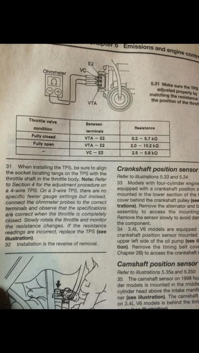

In the manual, the diagnostic procedure indicates that you need to check the resistance between the top and bottom pins of the 4-pin sensor. I got P0120 yesterday, and tried to check my TPS this morning, but realized that it's the 3-pin, not the 4-pin.
With the 3-pin sensor, should I still be measuring the resistance between the top and bottom pins? The reading I'm getting between those two pins isn't in the 1.2-3.2k ohm spec in the manual, but the measurements between the other pins do fall in that range.

[MENTION=620204]jlevers[/MENTION] Here is the test procedure from a Haynes manual for 3 pin TPS on a 5vz-Fe 3.4L and probably all 3 pin TPS on this Gen as they do not differentiate between 4-6 cyl for this procedure. Mine tested fine but had dropout readings between 10-20% on the Scangauge throughout its range 10-75%, I expect heat and vibration will change these readings and difficult to test under those conditions, OEM was $100CAD so I replaced the original TPS, drives much better.

Great, thanks to both of you -- I think I'll just buy a new one, because as you both said, they're not crazy expensive but they are hard to test.
