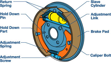

If none of those suggestions have worked and you haven't resolved it by now, it sounds exactly like the e-brake spring hitting the back of the axle flange as it's rotating. I swapped out rear rotors on my 06 and ran into this problem. Does it sound like its coming from one side only? You will have to take that wheel off, unbolt the caliper bracket ( 2 bolts ) , remove the rotor and spin the axle by hand checking behind the flange (inside the ebrake assembly) with a flashlight. Mine was a blue spring with a rod through it attached by a hat, also known as the hold-down spring located on the diagram I have attached. Let us know if this was the problem on yours and how you have fixed the issue.
Just to clarify , this issue was one my 06 with 4wheel discs... the diagram is just a reference for what the ebrake assembly looks like.
