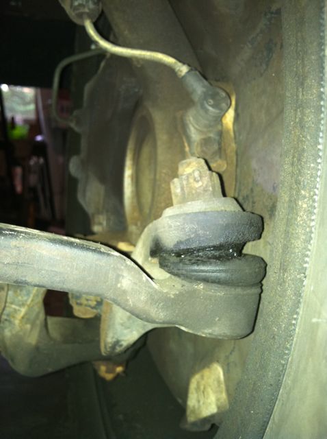

Me rotating passenger side tie rod with my hand, ironically there's a feeling of drop-off and slop on passenger side when going over a pothole.
YouTube - IMG 0222

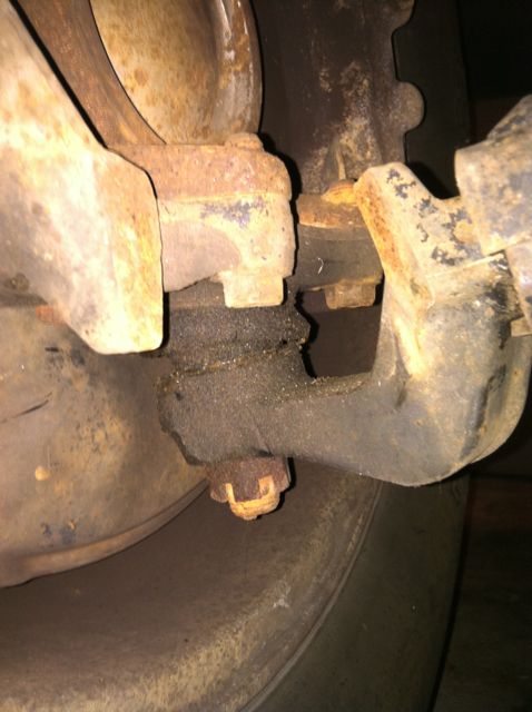

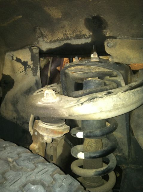

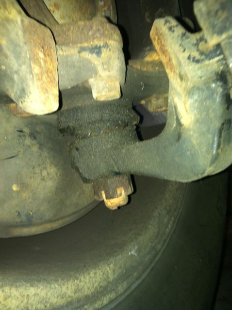

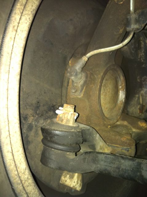

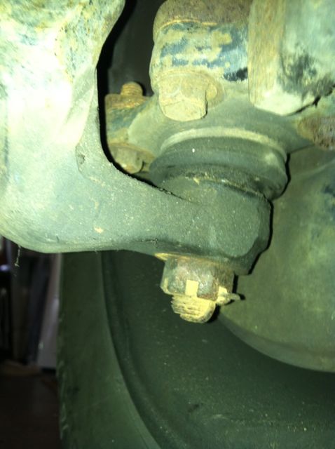

Additionally, took some pictures of other steering/suspension components.

I think thats normal. The outer tire rod (the part you were twisting) attaches to the inner tie rod, The ITR is a ball joint, so that rotation should be fine. If you think it could be loose pull the steering rack boot off and check it out.

Ok, driver's side OTR did not rotate like passenger's, but I replaced that less than 3k mi ago.
Still trying to pinpoint front end jello. Anything else look like it could be causing issues?
I jacked up the front end this morning and moved the tires up and down, side to side. Only movement was up and down with the upper control arm.

Define front end jello. For starters it looks like you have original everything under there. Is that correct?
My best guess for one spinning easier than the other is you have a worn Inner TRE. if the ball joint has play in it, They almost all do, then you could perhaps have less tension on the tre and make it easier to spin... If that makes any sense

rjaudi- AFAIK everything is original, going on 227, xxx. I'm the second owner trying to pick up the pieces..
