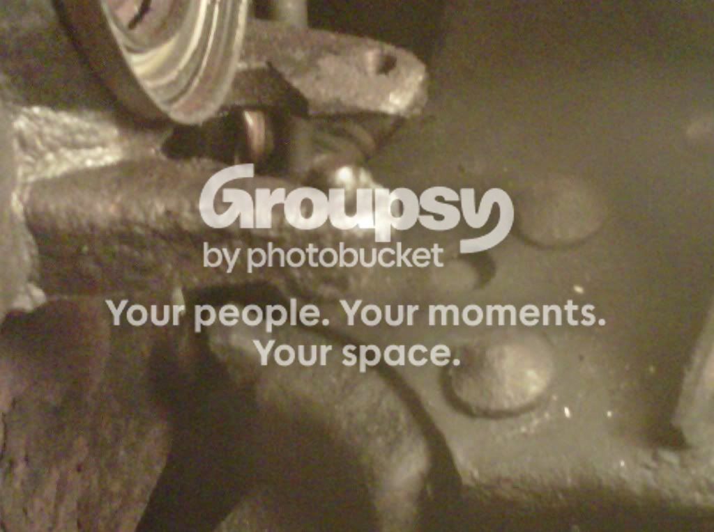

Heres what happend to me while removing the lower ball joint today :sobbing:
brokenbolt.jpg~original
Lucky I can put the project off since I have another car. But it still sucks.
That broken piece is the LBJ right? So now you just need to replace the LBJ too? Sucks it broke, but if it broke, then you probably needed to replace it anyway. Better now than driving down the highway.
I already am replacing both lower ball joints as part of the project . Thats one of the bolts that holds it in place , thing snapped right off . I should be able to drill it plus about 1/4 is sticking out at the bottom so that will help aswell.

Curious if this works. Those bolts are probably hardened, and may be very difficult to drill without a high quality drill bit.
Those bolts are soft. That is why they break often.
If the bolts won't move, the best method is to use heat (oxy acetylene torch) and they will come right out.
Shocking it with a hammer might help.
Use a antiseize when reinstalling and you might not have the problem in the future.
