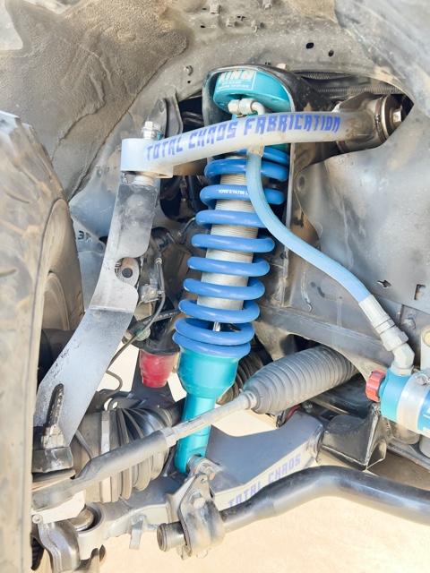

No concern that the bump stops wont function properly given their height and changes in travel?
If you wanted definitive confirmation that the bumpstops would stop uptravel prior to the shock bottoming out, you can remove the springs then reinstall and cycle with a jack.
Or play it safe and install the spacer.
I'm confused as to why the spacer is required. Is the DK LCA at an angle or lowered at the bump pad? The increase in downtravel would be unrelated as that is most likely just due to the balljoint at the spindle and/or angle of the arm.
I'm pretty sure it's because the bump stop would sit lower due to the way the arms are fabricated. Without the spacer, the bumps most likely wouldn't engage properly
