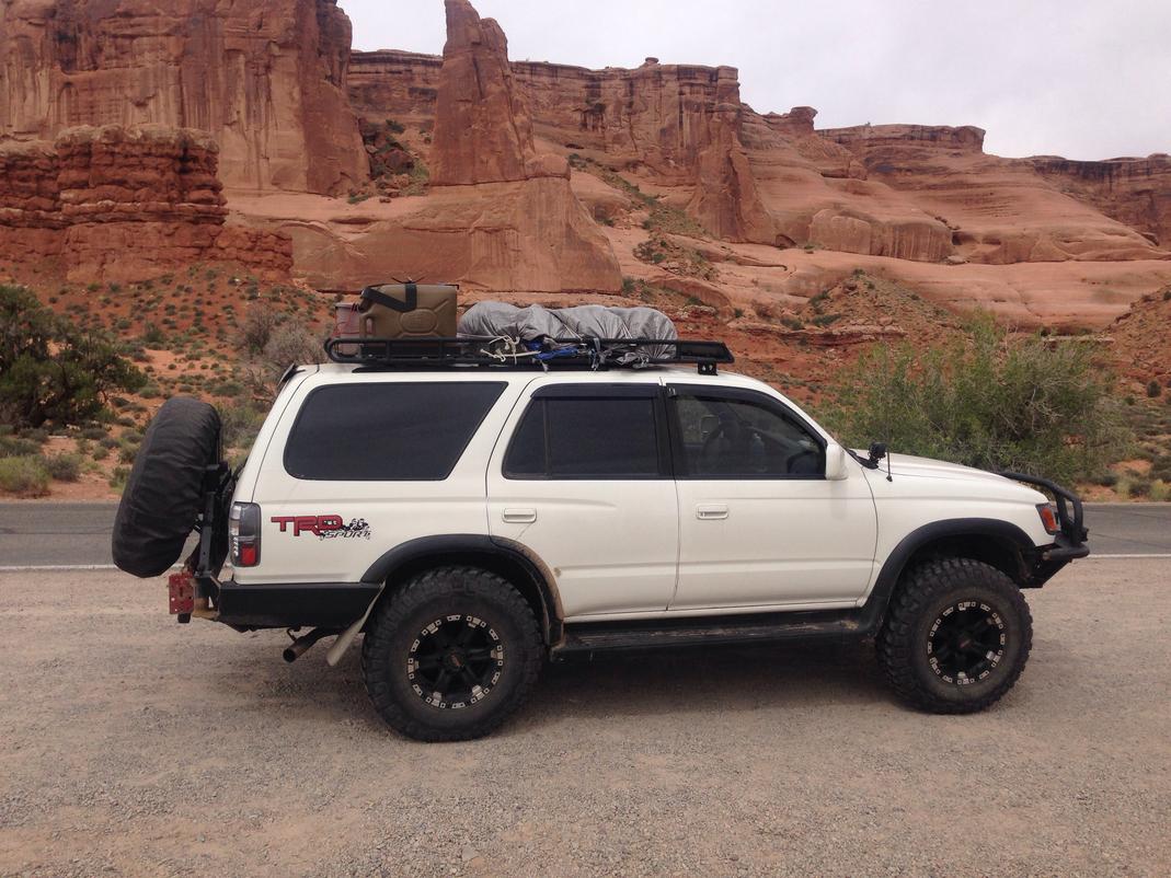

Love my full length Baja Rack and it can hold the weigh.
