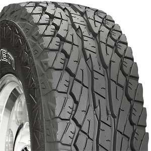

I am going to put in a vote for Falken Wold Peak AT. I am on my 2nd set. 1st set I got 56,000 miles. At DTD they are $135, no tax or shippingn then bring them to DT to mount.
Tire Details - Discount Tire Direct
How many miles did you get before they became half racing slicks? Most of the sipes are cut to half of the tread blocks. Every time I see these on vehicles they look slick. I had them will never have again
I had a set of Falken tires many moons ago on my Celica. They were the worst tires ever! Could never get them balanced right, sucked in the rain, rode hard as a rock and they were H rated! The brand Falken stirs up bad memories and I could never buy another set. I took them off at about 7/32 and sold them for peanuts. Couldn't take them anymore.
[MENTION=93434]gshadow325[/MENTION] I would rather have AT3's than falkens again
Agreed, they are not bad tires when new but it's the sipes that are not the depth of the tread. I noticed they became racing slicks after 15k.
