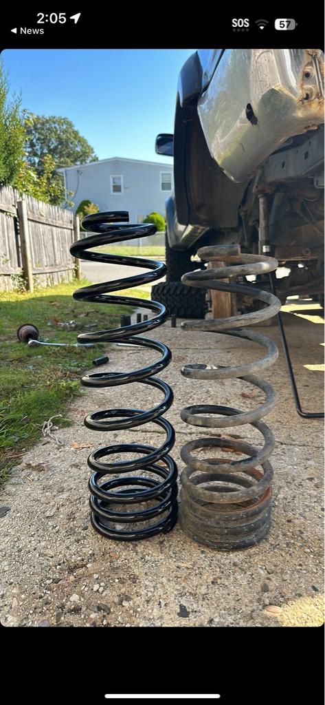

The HD are 19.5” and 18.5” tall. Below is a pic of what I currently have in terms of lift from the HD springs and how they look compared to OME 890s. Keep in mind my tire is 33.5” tall so you’ll have more of a gap if yours are smaller

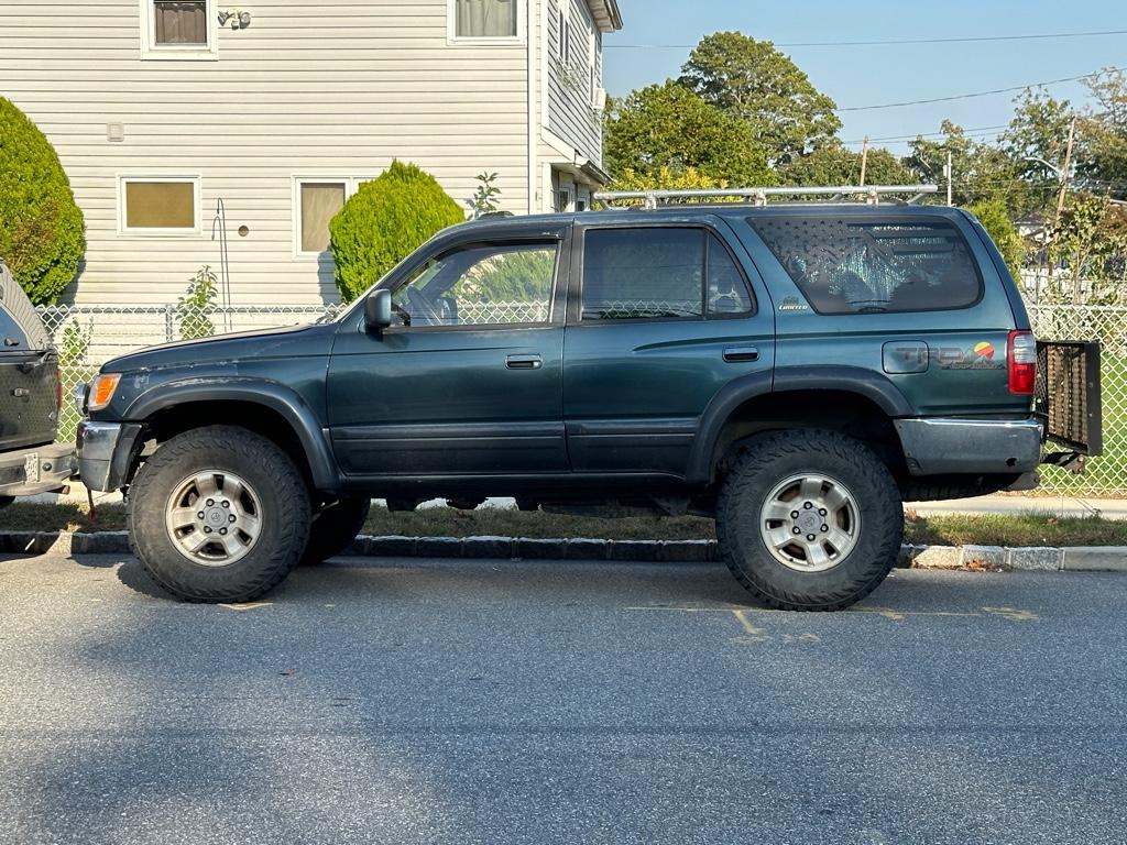

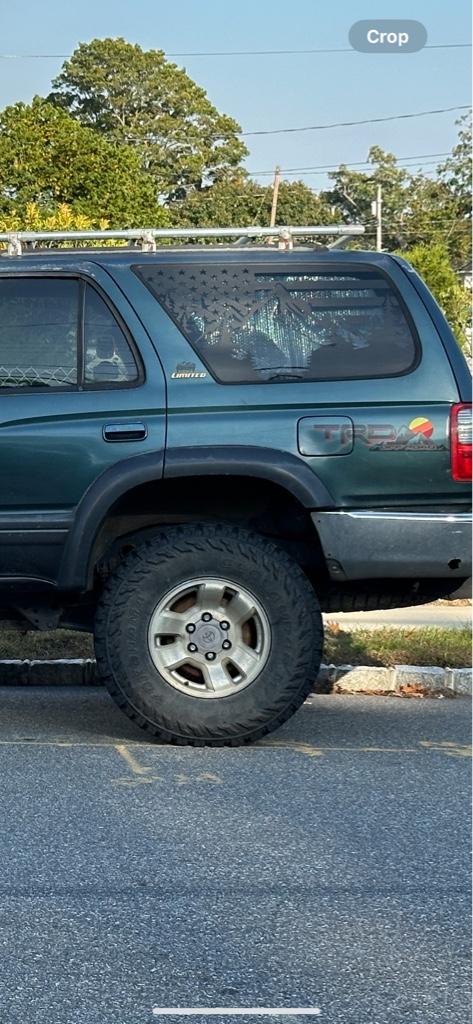

Finally got around to getting the work done.
Bilstein 6112s w/ 600lb coils
5100s in the back w/ OME 2890 springs
Installed the Air Lift 1000 kit as well.
Gosh darn this thing moves like a new truck. Very smooth and comfortable on sh!!!y roads and highway speeds. There is still a little bit of body roll when you're sliding around corners on these gravel roads that have a super high crown down the center, but it's gradual and easy to control when you're out of control at speed.
The 600lb springs in the front are almost too soft. Think I would go with the 650lbers if I do this again with the same stock bodywork. I would recommend a stiffer spring for stock weight, but it's not bad enough to make me want to do it over again until I have to. Installed the struts with the lockring on the lowest setting, expecting 1/2" lift according to what Bilstein says. That was my mistake. This truck had factory lift springs originally and the lowest lockring setting on the Bilsteins is about the same height. It settled down maybe a 1/4" lower even. Planning to take the truck to a professional and have them move the lockring up two positions to the third setting. The spring compressor I have struggled to compress those springs the first time (Wheeler's sent me one at the 3rd and one at the 2nd position). Looking for that evasive 1" lift. The CV angle is almost horizontal...
The 2890 rears are perfect for carrying extra weight sometimes. They don't seem to notice. The truck is MUCH better over shi!!y washboard and I'm doing things I should not do in 2H. The difference moving through deep snow is dramatic. Should have high centered several times already this winter but No! Put 600lbs of hay in the back and drove home 200 miles in the snow whistlin' and grinnin. Without measurin nothin, I would estimate more than 2" of lift unloaded. Got the goofy rake for sure. So far the airbags are totally unnecessary and I'm keeping them at 10psi. The Airlift 1000 kit works fine but without any experience at all, I feel like they may wear quickly... They include instructions for different setups but you will have to improvise a little to get it to work. Cut off the bump stop in a different place, and use their spacers, etc.
Had an alignment done and I seem to be in good shape without doing anything to the panhard bar. There is a god.
Will post pictures.
